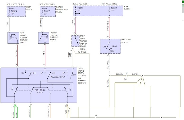

When i turned on my running lights nothing would happen and it would blow fuses left and right until i got the dimming roller in a certain place. The dash lights would stay on constantly so i had to disconnect the battery every time i would park it.
I finally dug into the wires and found that one was melted through due to the fact that I accidentally put in a 30 amp fuse in when it calls for a 20. I replaced that wire with a new one and now the dash lights turn off and the rear running lights only work none in the front.

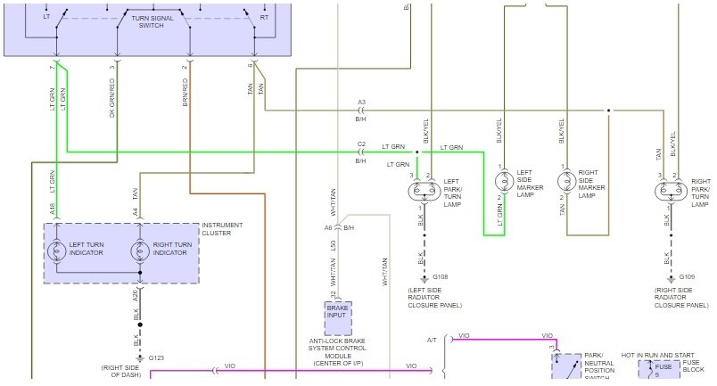

When i have the running lights on and use the turn signal the lights don’t blink they are steady. The front side marker comes on but is very dim. They work fine if the running lights are off.
Now comes the kicker. I checked every positive wire and they all have power when the lights are on but still no lights in the front. And i replaced all the bulbs and checked the connections for the lights. Everything has power.

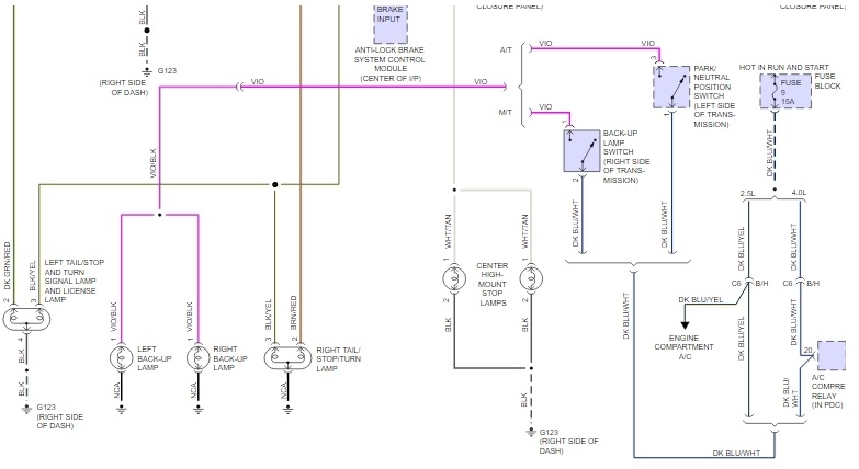

I went into "Prodemand" and found your exterior lamps wire diagram.
These diagrams are great!
They show fuses along with the Amp ratings and locations. Along with everything else in the system.
It took three screenshots to get the whole diagram. I feel sure the first screenshot is the one you will most likely deal with.
I insured all three shots overlapped so nothing is missing.
If you need me to blow a portion up a little, let me know.
Return with good news!
