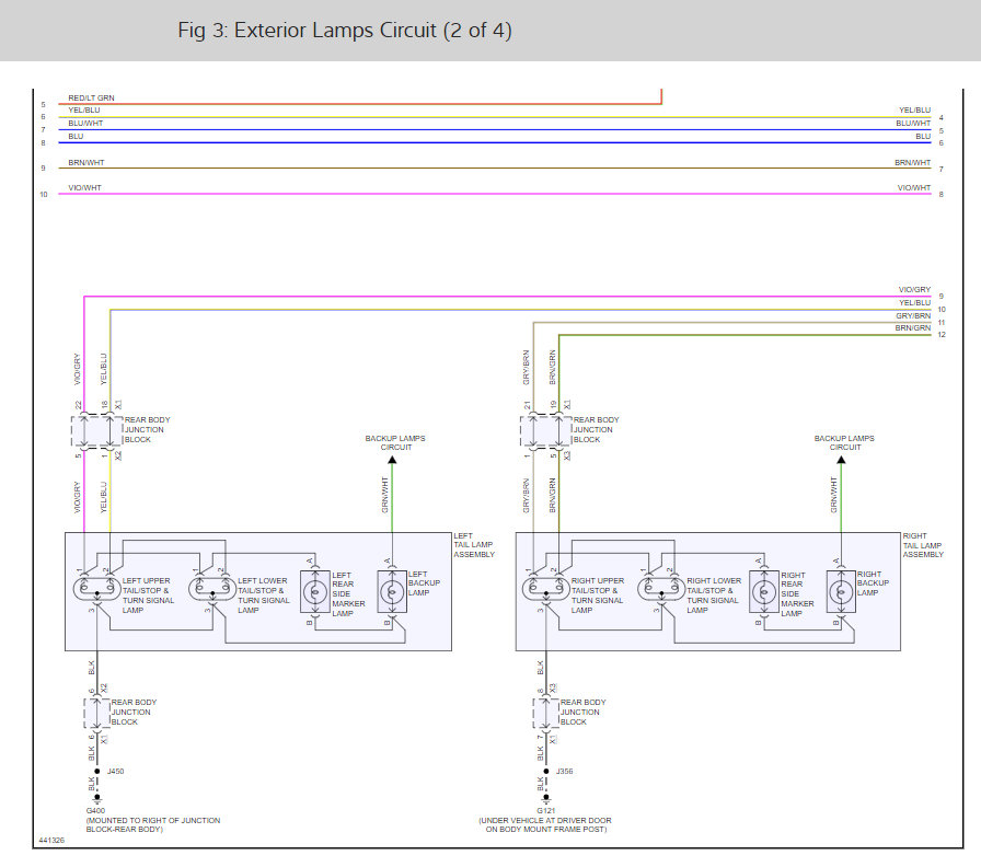

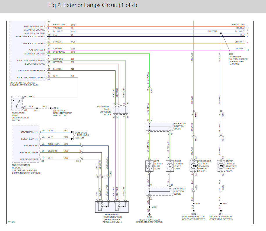

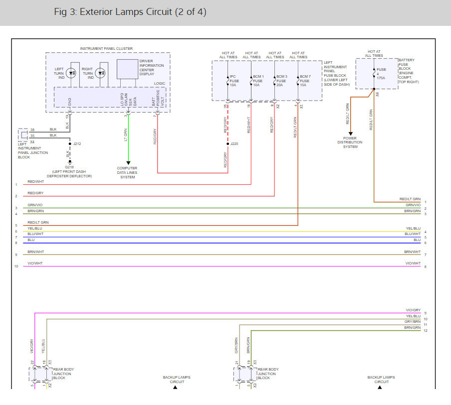

I recently had the center of my rear bumper pulled off in a slight towing mishap. When this happened the passenger side license plate light was ripped from the wiring. The other side was fine so i thought nothing of it but on my way into work a coworker noticed that the front and rear running lights on the passenger side were out. Signal lights and brake lights work normal. Is this a direct result of the license plate late being pulled from the wiring as it is still just hanging there.
Thanks.
Apr 13, 2021 at 8:33 PM
4DRTOM
  • 467 POSTS
The ground wire from bumper to frame or body probably got disconnected and this is affecting the other lights. Look for a wire back there disconnected or broken. You will probably see one hanging. Here ias how to check the wiring and the running light wiring diagrams so you can see how the system works:
