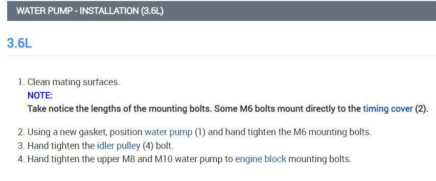

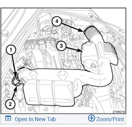

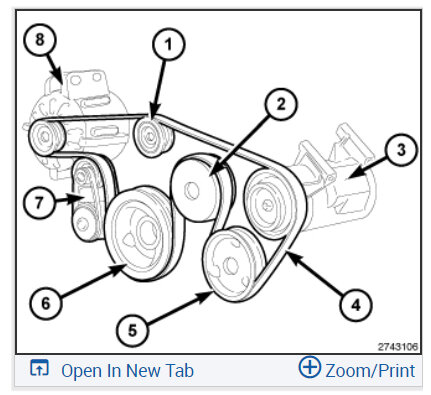

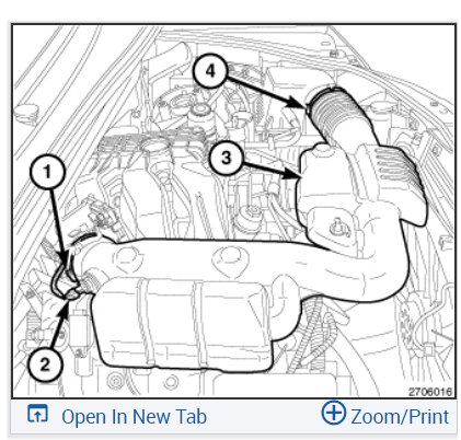

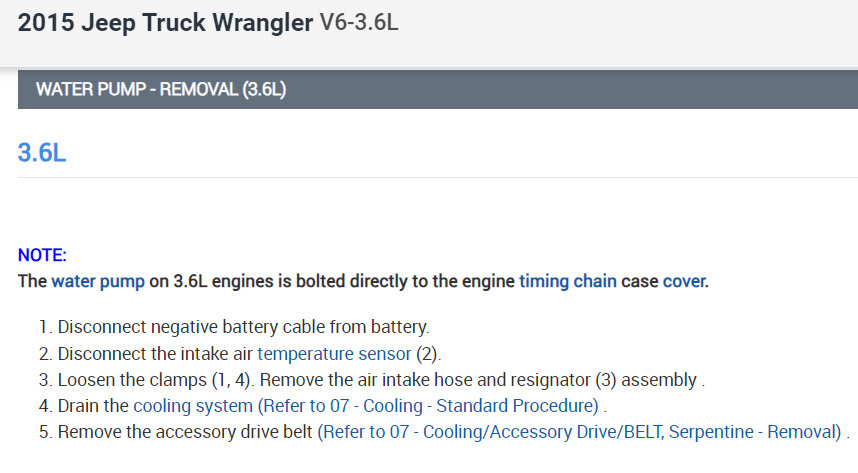

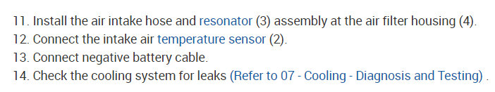

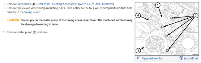

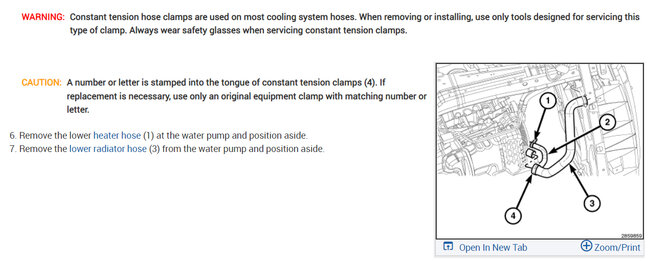

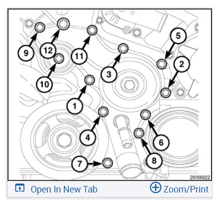

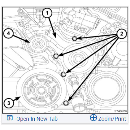

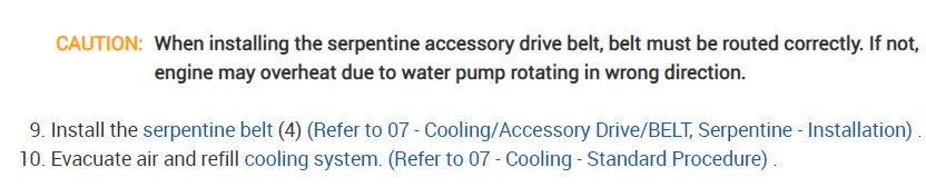

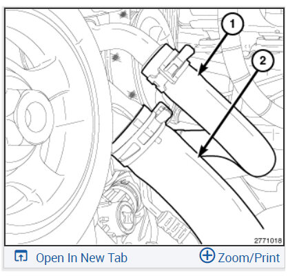

I have seen the water pump impeller fall off the input shaft which sounds like what is happening. Here is how to remove the pump for inspection. Check out the images (below). Let us know what you find.
