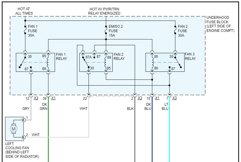

I have the vehicle listed above that on idle starts to overheat, if I rev the engine, it goes back to normal temperature. I've changed the water pump, thermostat, radiator, all hoes and the heater core also had the system flushed. when driving runs fine. what else can i do to finally solve this problem?

Since this happens at idle, I suspect you are driving in town, stop-and-go traffic. Is that correct?
If it is, then check to see if the cooling fan turns on when the engine begins to get hot. It should turn on at approximately 215 degrees F.
When you are moving, air flows through the radiator without the fan. When stopped, the fan is needed to produce airflow. If it doesn't turn on, the engine can overheat.

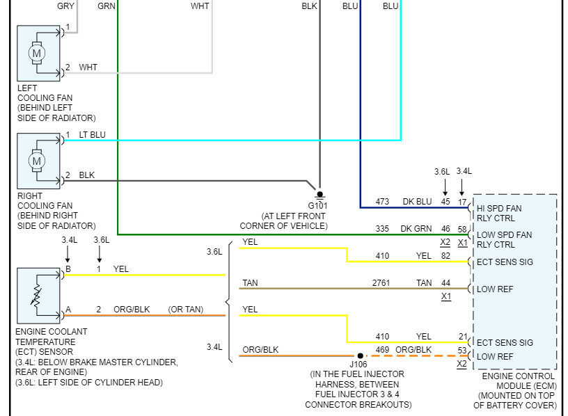

I attached the wiring schematic for the radiator cooling fan circuit below. If they don't come on, check the fuses to make sure they are good and have power to and from them.
See pics below. Note: I had to cut the schematic in half to make it readable. I did overlap the two so you can follow from one to the next.

I do hear the fan turn on and the weird part about the whole thing is that it usually happens when the car is in park for the most part. Sometimes it happens if I'm on like. Drive thru but usually on park, could it possibly be a water temperature sensor?
Aug 22, 2023 at 8:46 PM
  • 110,246 POSTS
If the fans are working, then it could be the sensor, but I feel it's unlikely. The only thing you could do is to use an infrared thermometer and check the rad temp to see if it is close to what the gauge says.
