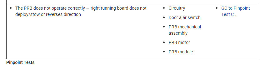

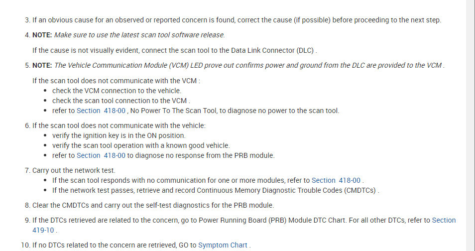

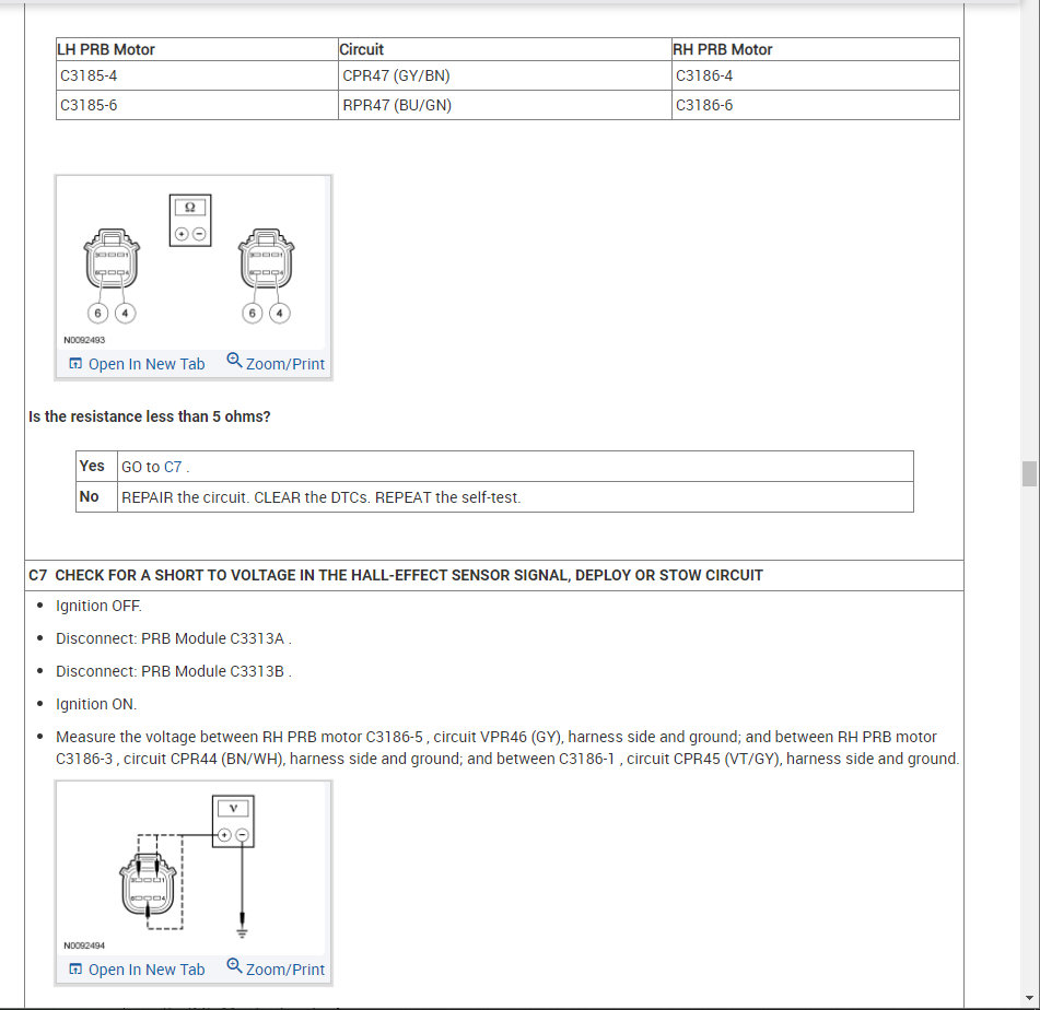

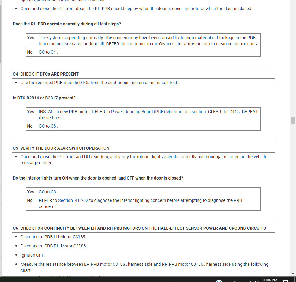

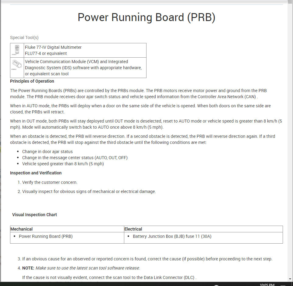

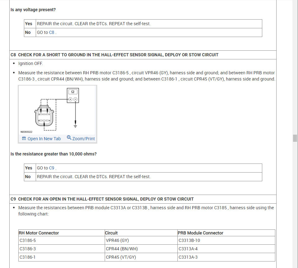

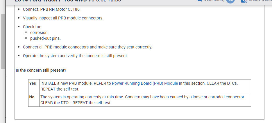

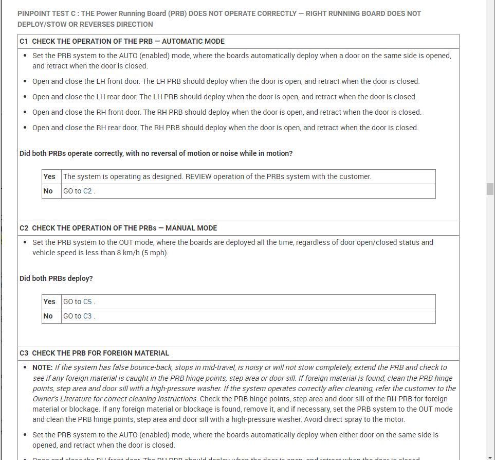

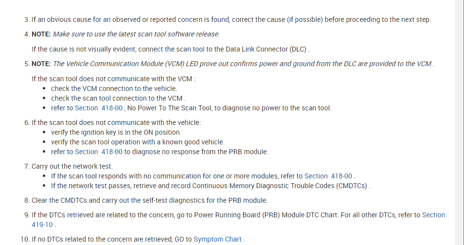

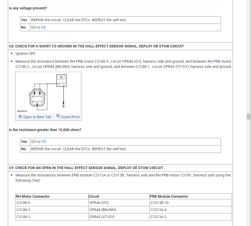

This could be a couple things but I suspect the module is the issue.
First thing to do is check for codes as that will tell us if we have a sensor/switch issue.
If there are no codes, I am attaching the testing below that we need to run through in order to figure this out.
Here is a guide that will help with the electrical testing:
Please run through this info and let us know what you find and we can go from there. Thanks
