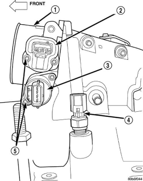

Idle up from high to low, acts like it will turn off and if I sit at the light for a few minutes it will turn off. Drives high idle act like bad gas runs bad.

It sounds like the idle air control valve is bad. It is responsible for maintaining the engine idle speed. When they go bad, the engine idle will lope up and down and often times stall.
The component is located on the throttle body. I attached a picture.

Here are the directions specific to your vehicle for replacement:
Removal
4.7L V-8
The Idle Air Control (IAC) motor (3) is located on the side of the throttle body.
1. Remove air resonator box at throttle body.
2. Disconnect electrical connector from IAC motor.
3. Remove two mounting bolts (screws).
4. Remove IAC motor from throttle body.

1. Install IAC motor to throttle body.
2. Install and tighten two mounting bolts (screws) to 7 Nm (60 in. lbs.) torque.
3. Install electrical connector.
4. Install air resonator to throttle body.

Hello, just found out it was replaced yesterday and still doing the same thing.

If the IAC was replaced and it still does the same thing, the next thing I would do is check for a vacuum leak. If unmetered air gets into the engine, it will cause problems, rough idle, stalling. Take a look through this link. It discusses how to check for a leak.
Let me know if this helps. Also, let me know if the check engine light is staying on when the engine is running. If it is, you need to scan the computer to identify diagnostic trouble codes. Here is a quick video showing how it is done:
