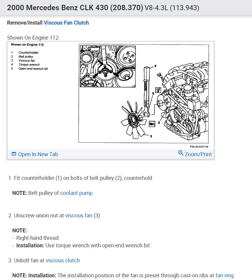

My car is running on the warmer side since I bought it. What's steps should I take to prevent it eventually running hot. The kicker is when I have my foot on it running it fast It stays on the cooler side of the temperature gauge. Please help.

It is common that the fan clutch goes out causing this issue. Below is a guide and instructions on how to fix it. Check out the diagrams (below). Please let us know what happens.
