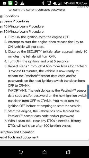

it starts then dies, will start then dies.

With the key in the run position is the security light on solid or flashing?
Sep 18, 2016 at 2:34 AM
CHERYL FRAZIER
  • 5 POSTS
flashing.
Sep 18, 2016 at 2:42 AM
SATURNTECH9
  • 30,869 POSTS
Try the steps I posted also your gas gauge is working now?

Thank you so much for your input. No, it didn't work but I give you some wrong info. It did however lead us to the problem and we do have it running. Again, thank you so much. Have a wonderful day.
Sep 18, 2016 at 9:49 AM
SATURNTECH9
  • 30,869 POSTS
So what was the problem?Because if the gas was inop and it cranks and doesn't start then most likely you have a bad body control module.I have replaced tons of them with those symptoms no start and fuel gauge inop intermittent.
