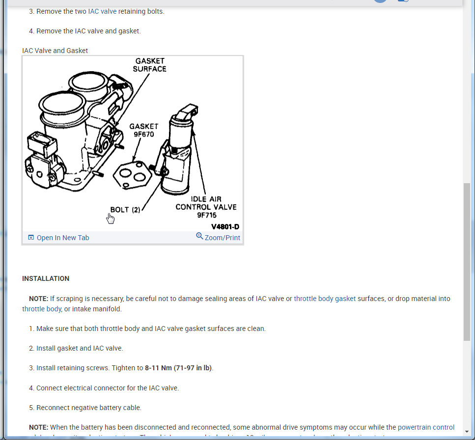

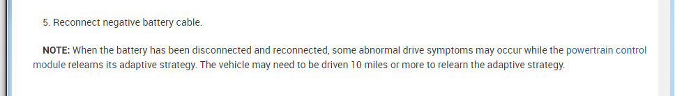

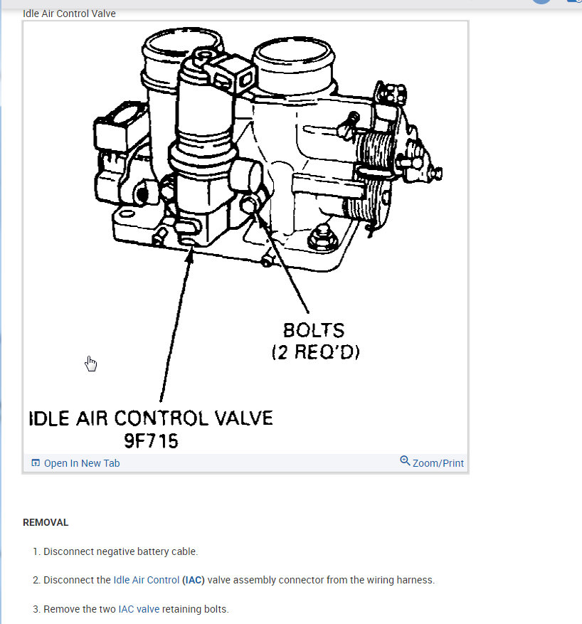

If not, when you replaced the throttle body, we the idle control valve part of it?
If not this would need to be checked and clean for carbon as well.
https://www.2carpros.com/articles/idle-air-control-valve-service

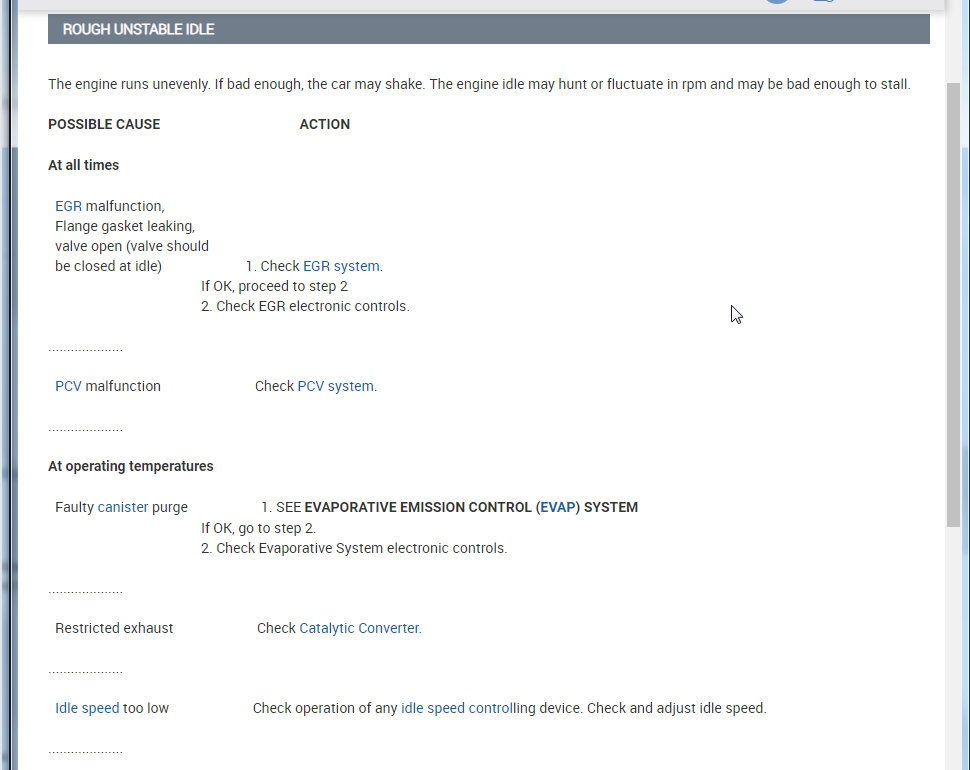

I also attached info on the EGR system but we need to start with this info and go from there.
