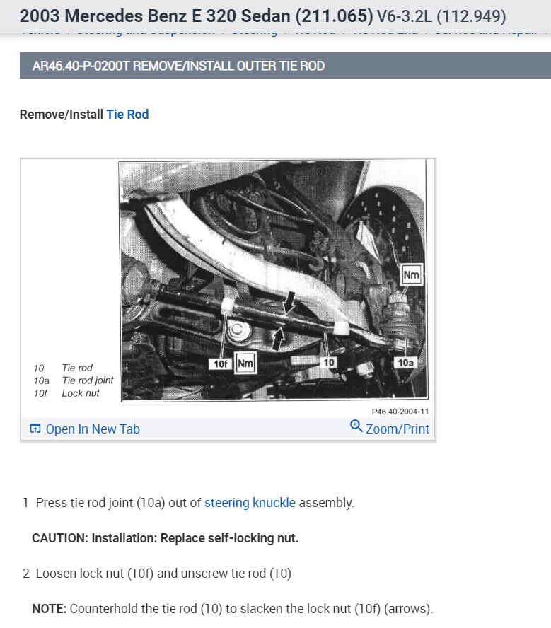

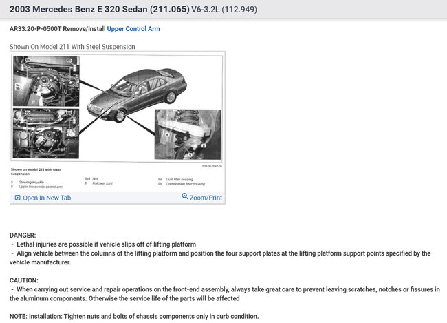

Thanks for the videos, it looks like the ties are okay. I think you were more on point with the front suspension issues. I would check the tie rod ends as well.
Here is a guide to help with that:
https://www.2carpros.com/articles/tie-rod-end-replacement

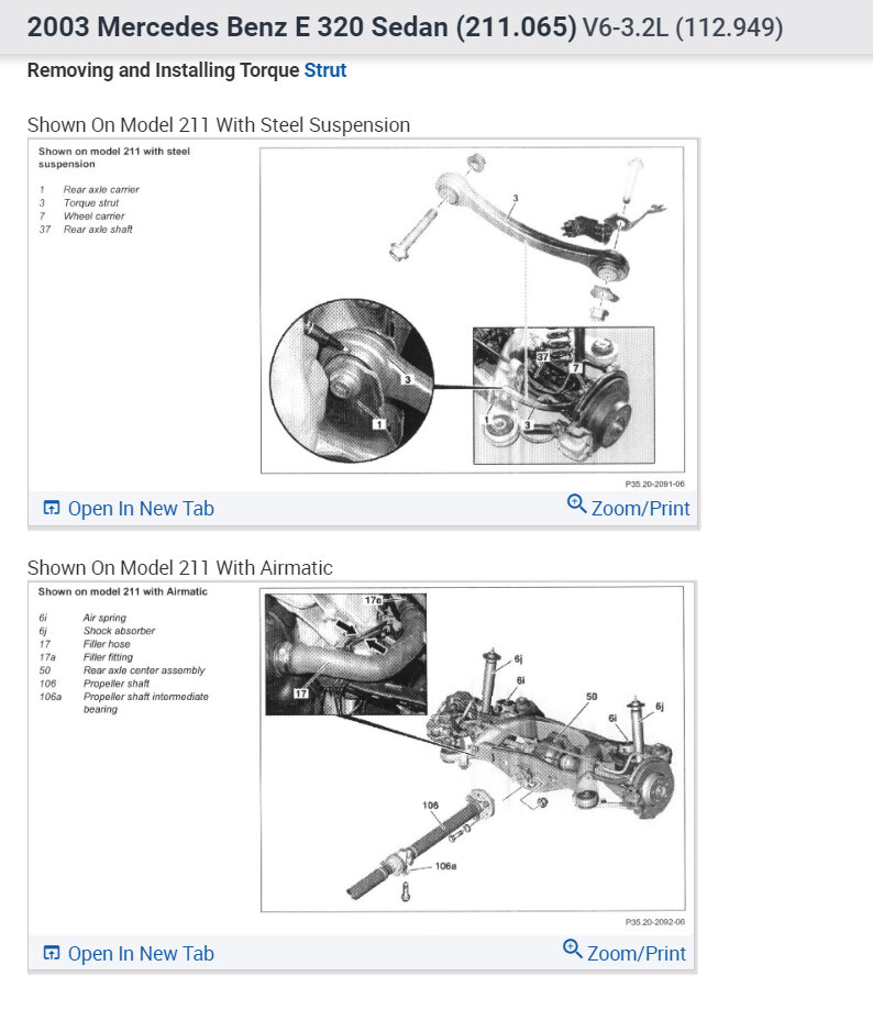

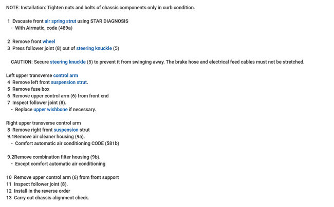

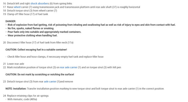

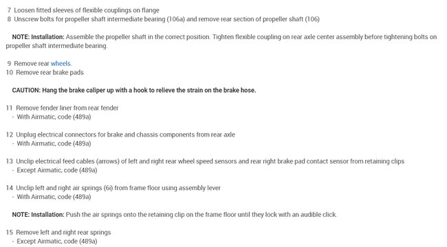

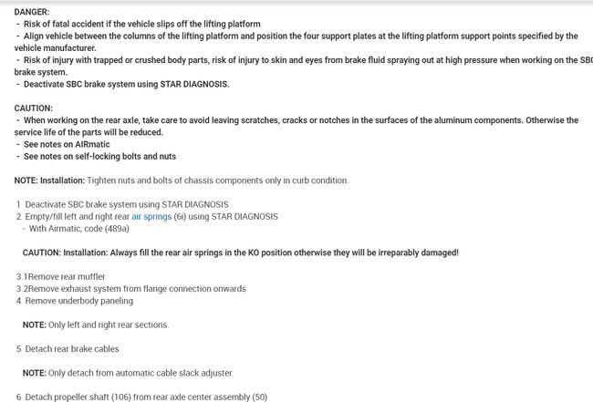

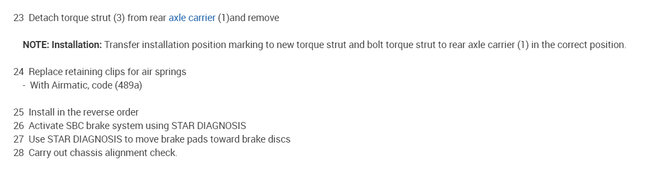

Also, I have left instructions on how to replace the parts mentioned. Check out the images (below). Let us know what happens and please upload pictures or videos of the problem so we can see what's going on.
