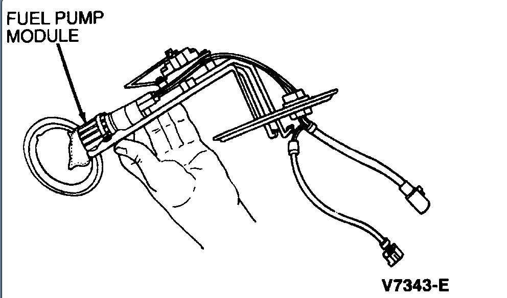

Start engine runs low idle. As it warms up idle surges up and down. When it warms up it runs ruff. I have changed TPS, IACV, EGR, intake manifold, PCV, sparks, ignition wires, fuel filter. Fuel pump has 30lb.

Your fuel pressure is low and most likely causing this issue.
It should be a minimum of 35 but better at 40.

Caution: Fuel supply lines will remain pressurized for long periods of time after engine shut down. This pressure must be relieved before servicing of the fuel system is begun. A valve is provided on the throttle body for this purpose. Remove the air cleaner and relieve system pressure by using Rotunda pressure gauge tool T80L-9974-A or equivalent and drain the system through the drain tube.
Removal:
1. Place vehicle on hoist, do not raise.
2. Perform fuel system release procedure.
3. Drain fuel from fuel tank.
4. Raise vehicle on hoist. Use proper vehicle lifting procedures.
5. Remove fuel tank and move to bench.
6. Remove any dirt that has accumulated around the fuel pump module so that it will not enter the fuel tank during removal and installation.
7. Remove six bolts from around perimeter of fuel pump module.
8. Remove fuel pump module from fuel tank.
9. Remove o-ring seal and discard.
