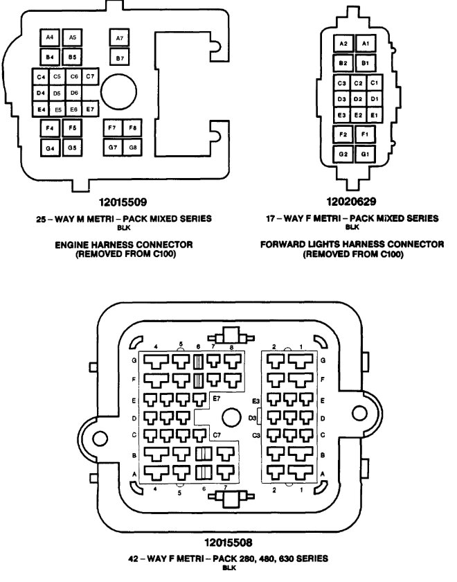

Okay. I seem to be able to find every possible auto wiring diagram for every car/truck ever made but the 1 or 1's that I desperately have been after for over a year now. Please help me out here! I simply want a diagram of the 42way MetriPack f connector assembly. Including the 25way and 17way MetriPack mixed junction fuse block 280/480/630 male blade terminal pinout diagram. I would like it to include Cavity alpha numeric row columns, description of connector(function) cavity male and or female side. (Of course it all dead ends with the circuit fuses on the fuse block panel. ) So really just the pinout of the blade terminals in the 25/17way MetriPack junction block connector, the wire gauge, the wire color, the size of the terminal and placement as is A1, starter, pink wire,10-12awg and so on until both the 17 way Front headlamp wiring harness and the 25way Engine harness has a complete diagram so I can crimp the terminals and plug them into the proper alpha/numeric row / column . Put my engine bay to cabin junction block connector s together and get Ruby up and running once and for all so I can tell all the skeptics to bite me for telling me to junk her (Ruby) or I will never get her running again. Please! You've sent me diagrams and information before I have been learning how to read electrical diagrams and the function of components and the basics of auto mechanics from the ground up! I need an ez peazy 101 chart for dummies. I've seen these charts/diagrams for everything BUT Ruby . A 1996 Chevy Corsica 2.2L automatic 3 speed 4 door sedan. VIN#1G1D554XTY248314
I hope to hear from you once again! I've read every thread, post on your website about C100 and other connectors trying to wire this girl back up. Let's try this 1 more time. I know you have the information and diagram/s I need. Let me know if you need any more information from me, pics, videos etc. I will definitely send you a video on the day I fire ole Ruby back up!!

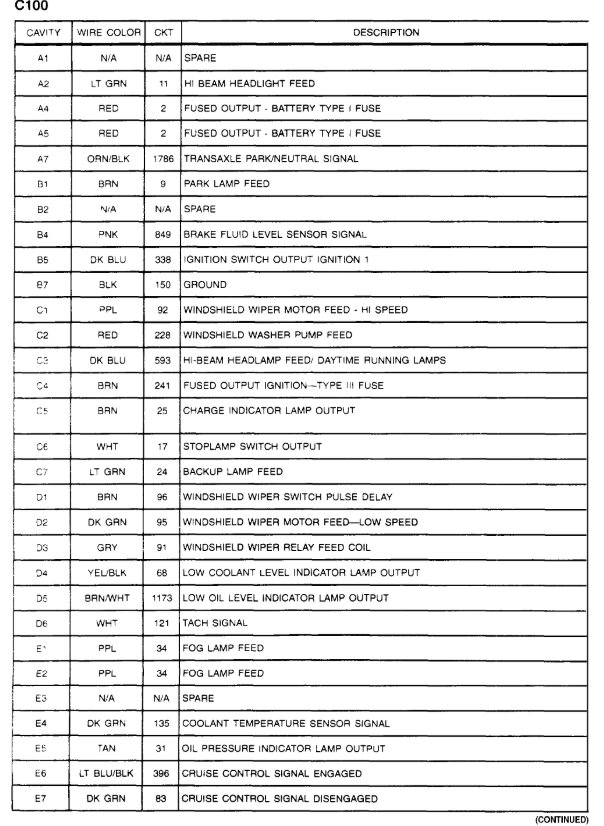

Great name for the car btw :) We can help you get it running. Here is a guide to help you test the connections if needed and the C100 wiring buck head connector.
Check out the images (below). Let us know if you need anything else. Good luck with Ruby!

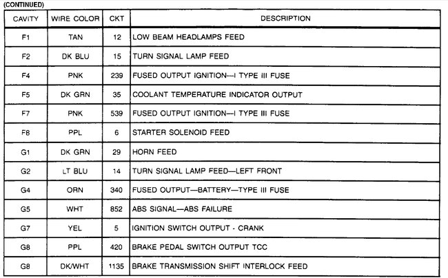

Oops! It seems as if you only provided 1/2 of the diagram. C100 (to be continued!) Should be A-G!!! Please provide part 2 of 2.

Opps! Sorry about that, here is the other pinout description. Go Ruby!
