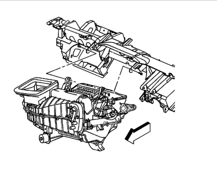

rubbish blocking blend doors
2005 CHEVROLET MONTE CARLO
140,000 MILES
JAMES TACKETT

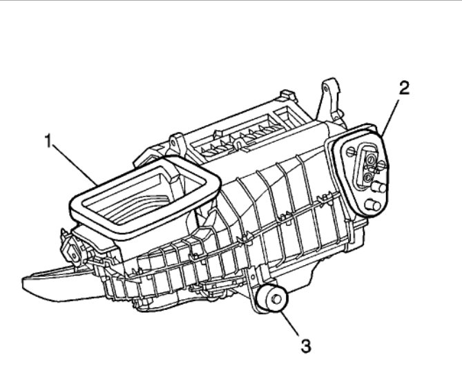

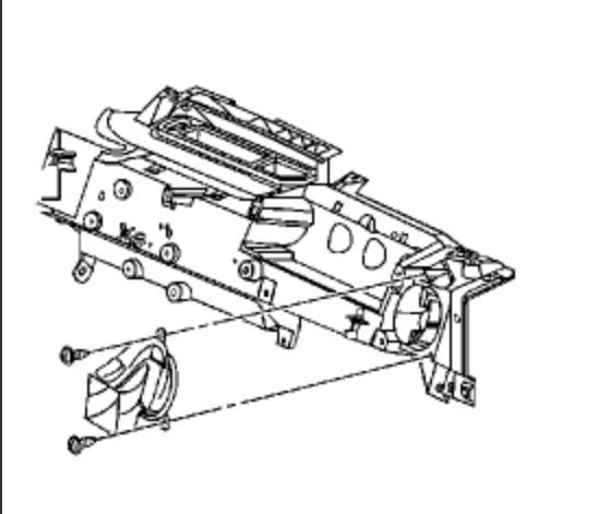

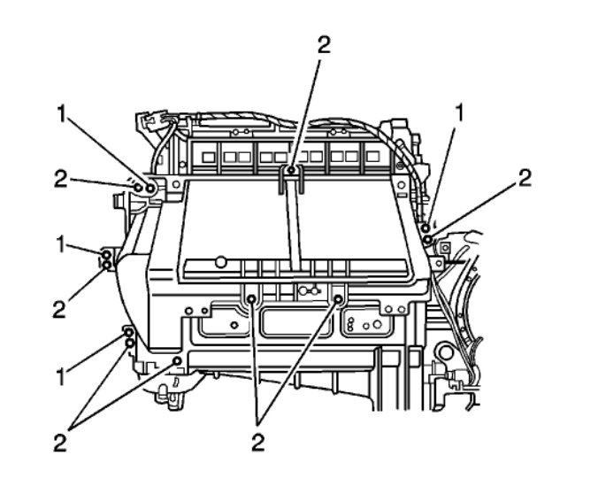

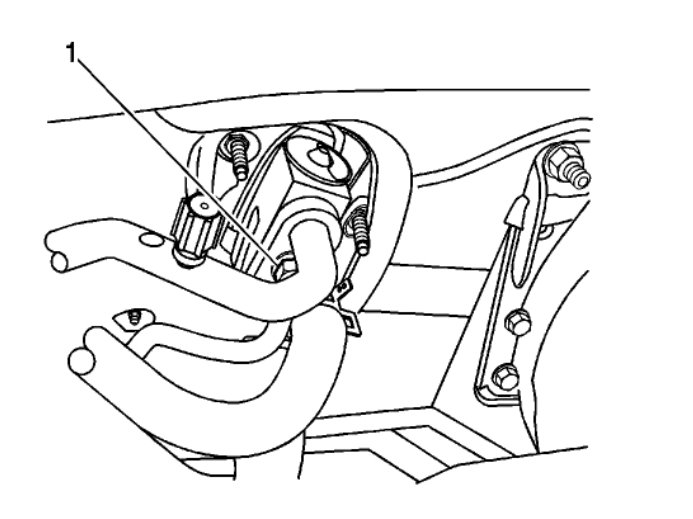

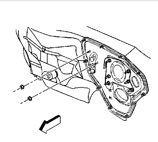

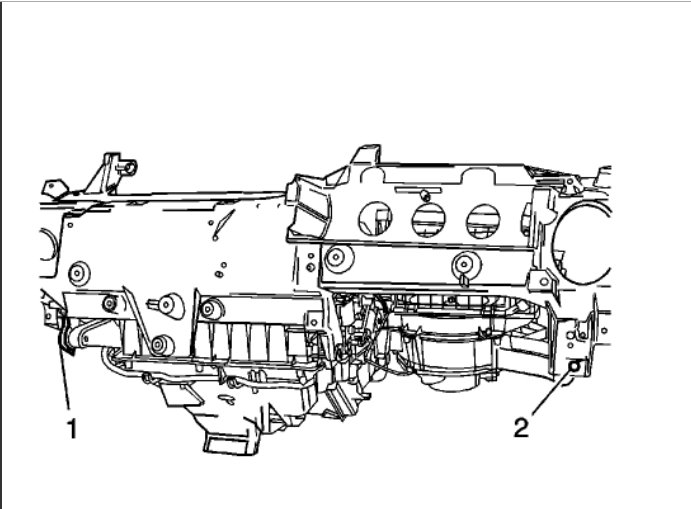

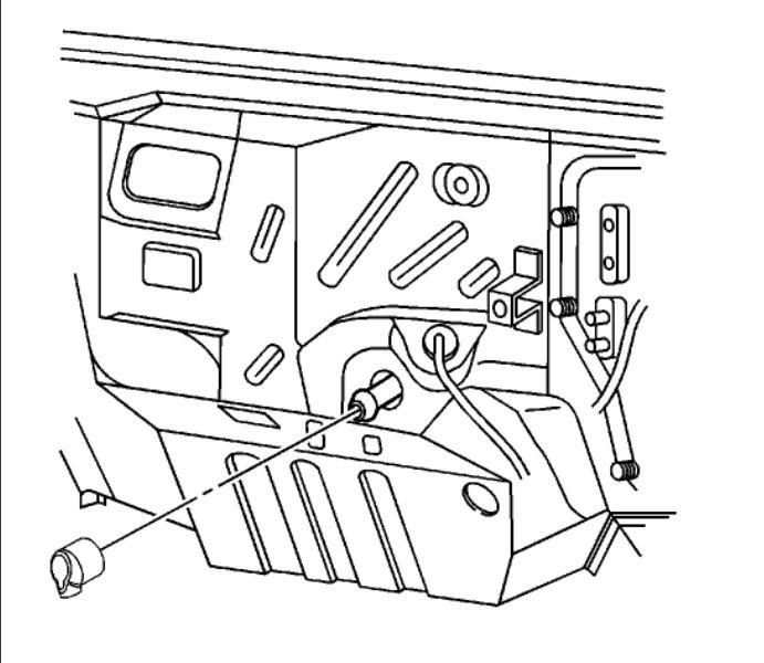

thanks for the information. How would l get into the air box to clear debris from blend doors?
Oct 12, 2017 at 10:38 PM
  • 55,421 POSTS

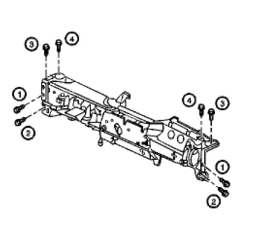

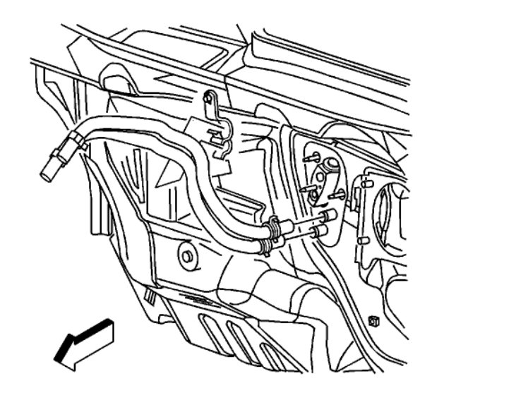

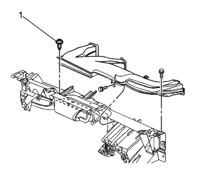

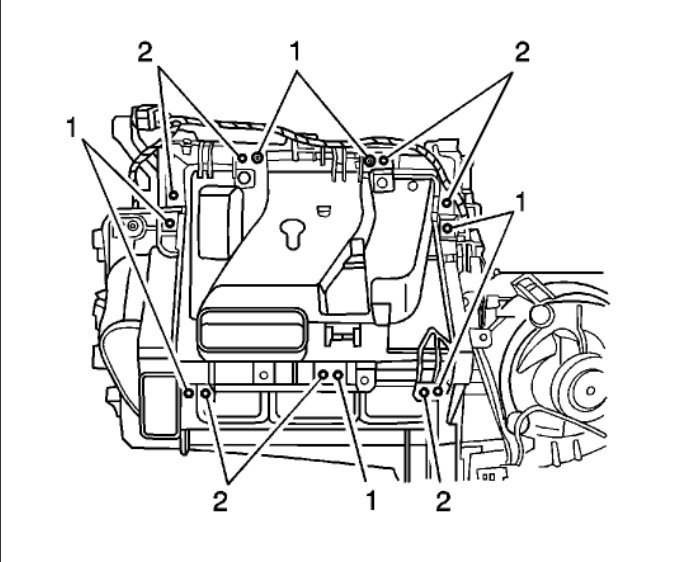

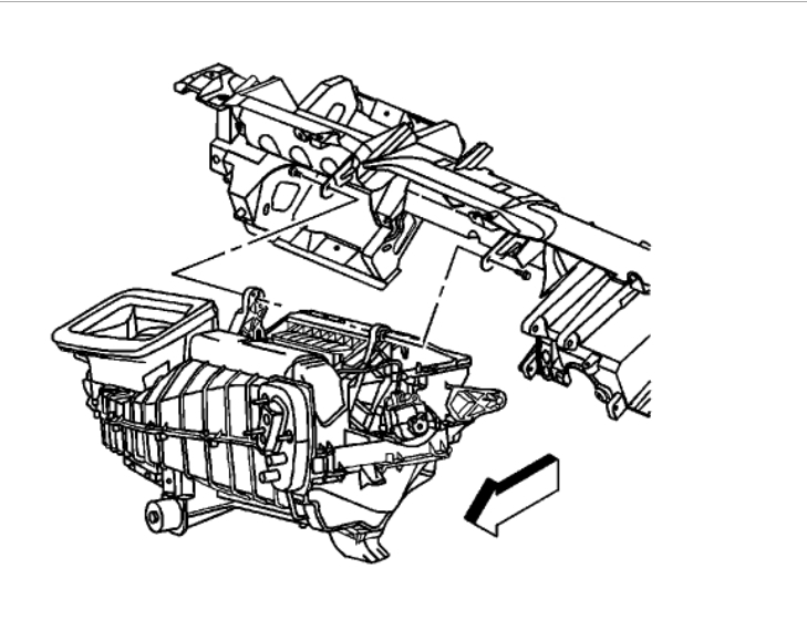

You will need to remove the HVAC housing to clean it out because it will need to be taken apart. First disconnect the battery and you will need to vacuum down and recharge the A/C system.
Here is a guide that will help you with that:
Here are the diagrams you need to follow to get the heater plenum out of the car so you can take it apart. (below)
Please let us know what happens so it will help others.
