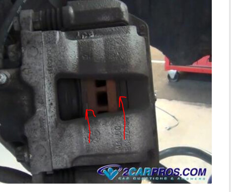

Let me know. Also, let me know if you are comfortable checking the brake pads. Here is a link that explains in general how they are replaced. I'm adding this because it shows the difference between a new brake pad and one that is worn.
Also, if you look at the picture below, it shows the location of the brake pads in the brake caliper. If you remove the wheel, you will be able to see them. I have arrows pointing to the pad remaining.

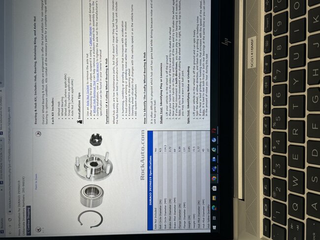

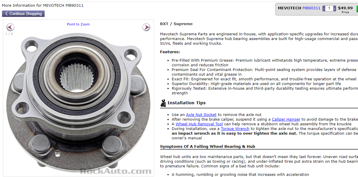

Hey Joe! I’m about to order the part and I want to make sure I have the right thing! I’m ordering from RockAuto. I think I included a picture of the part information. It’s the bearing and the hub kit that comes with hub, bearing, retaining ring and axle nut. Was there anything else that needed to go with that?

Have you confirmed that this is the issue and the side that is causing the noise? If so, what you showed me may be correct, but I can't confirm it without the engine size. Does your vehicle have a 2.0L or the 1.6L turbo?

It’s the 1.6L Turbo.

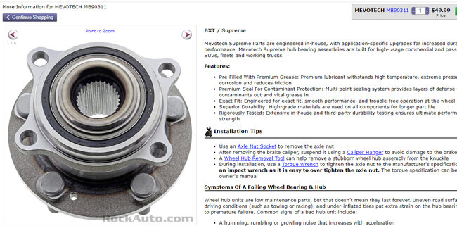

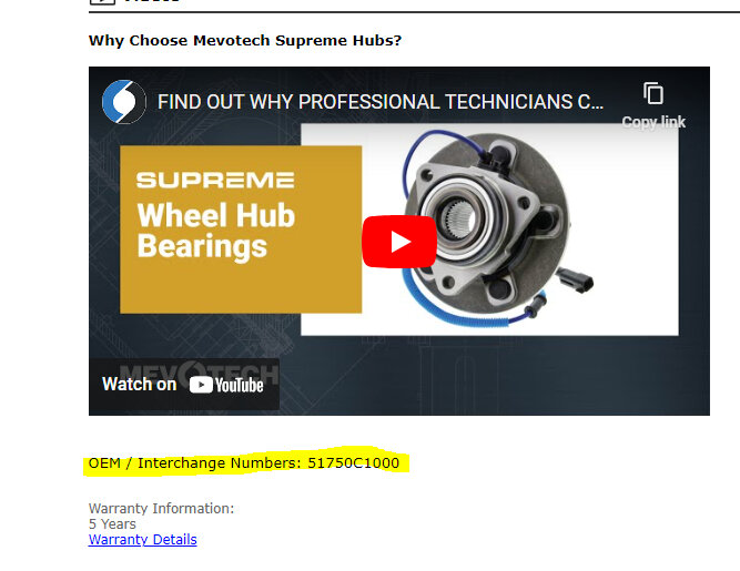

The one you need is different. The OEM part number is 51750C1000. This is not a press in bearing as pictured above.
Pic 1 below is the OEM part. Pics 2 and 3 are from Rockauto and I believe that is what you need. Note pic 3 shows the OEM part number as the interchange number.
Let me know if this helps.

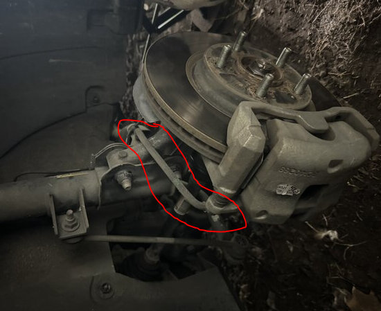

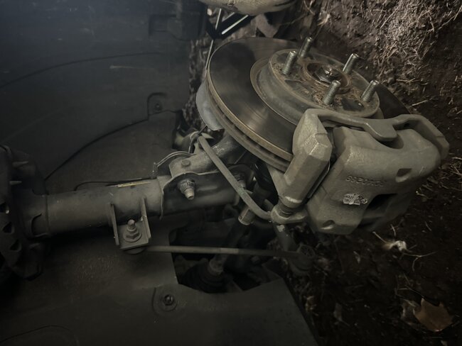

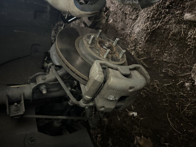

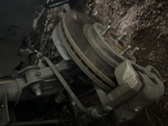

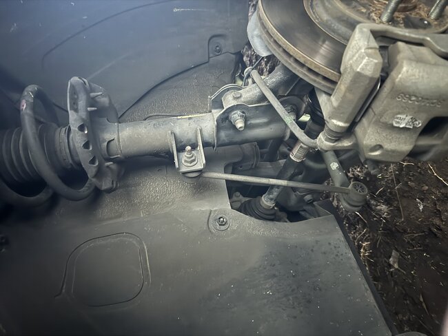

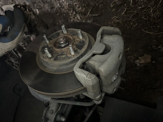

Okay, I’ve got an update for you! My wheel bearings are in good shape still. My brother took off my tire and checked and they’re good, no play. That initial scrape he said may be coming from my dust shield bc it appears to be on upside down. He also said that my brakes are squeaking some and it with that it looks as though the rotors weren’t cleaned off when they were replaced. He’s going to change those again and clean off the rotors this time.
There was that rubbing sound! It happened!! Still not entirely sure where that’s coming from entirely though. I’m uploading some photos of the area around the wheel.
Feb 17, 2024 at 5:13 AM
  • 110,241 POSTS

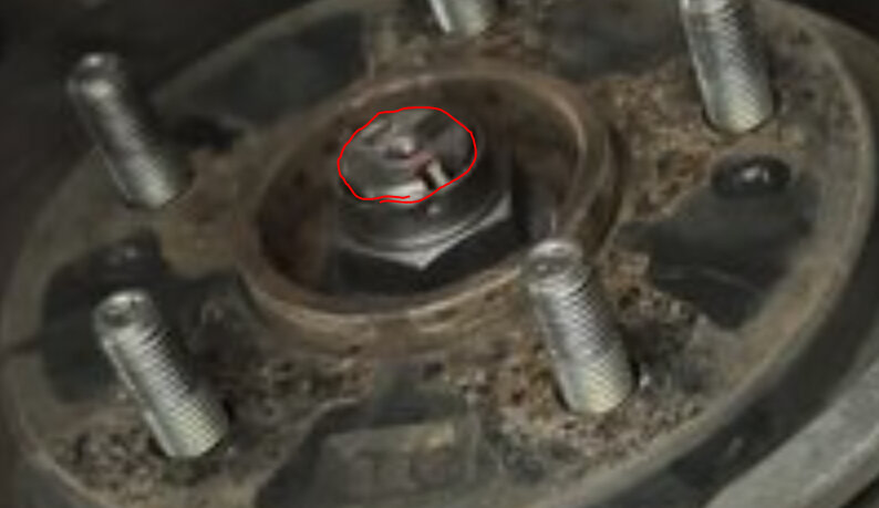

Two things. First, the axle nut usually sits further back on the threaded part of the axle. Make sure everything is together properly with the axle.
Next, the rubber brake hose looks stretched. It may be routed incorrectly. In the one pic, it looks like it is right next to the axle shaft. Check that as well.
