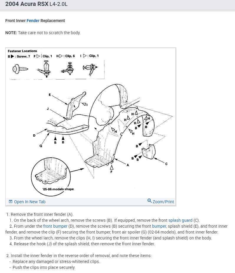

When initially pulling off I get loud and rough contact or rubbing from the front left part of car. Only when I hit the gas hard out of first gear. If I pull off slow and reasonable. There is no problem. Only when I hit high rpm right out the gate.

It is likely due to something loose or broken within the wheel well. Could be the splash shield or other component.
You will need to do an inspection of that area to see if you can detect any loose parts. Look for missing tabs or a sagging fender liner.
Also, it will be a good idea to inspect the back of the wheel in case something is rubbing there.
Let me know what you find or if you have any questions.

I looked in the wheel well, I did not see anything loose or hanging. I will try to explain it in the best way. It does seem like it could be something like that since it does not hinder my driving. any parts specific you think i could look at?

One of the common causes could be the inner fender liner. It can rub against the tire and make noise.
Are there any evidence of scrapping on the tire?
