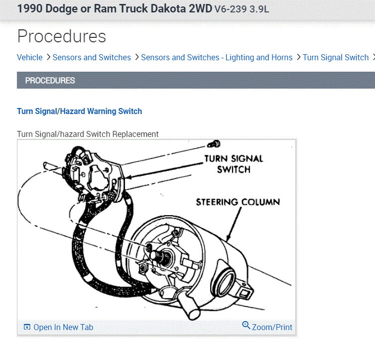

How to remove and replace the turn signal switch on a tilt wheel?
1990 DODGE DAKOTA
225,000 MILES • 3.9L • V6 • 2WD • AUTOMATIC
ELWEEZULL34
Instructions needed on how to remove and replace turn signal switch on a tilt wheel.

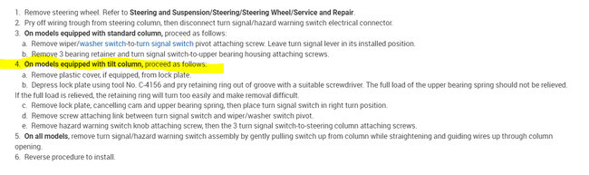

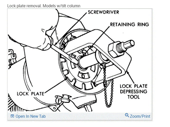

If you look below, I provided the directions for replacing the switch. In the last pic are the primary directions. I highlighted where specifics related to a tilt wheel begin.
