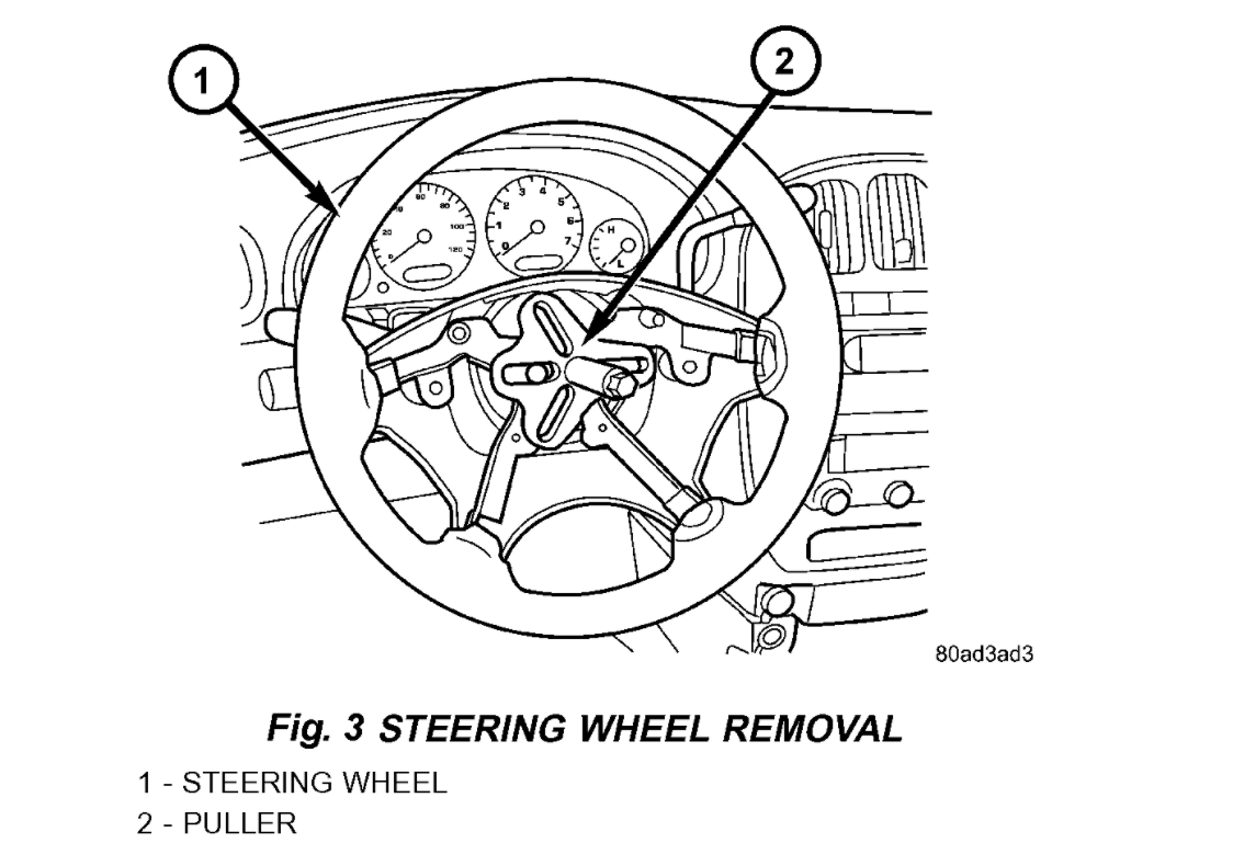

11. Remove the steering wheel retaining nut.
12. Remove the vibration damper weight.
13. Remove the steering wheel.

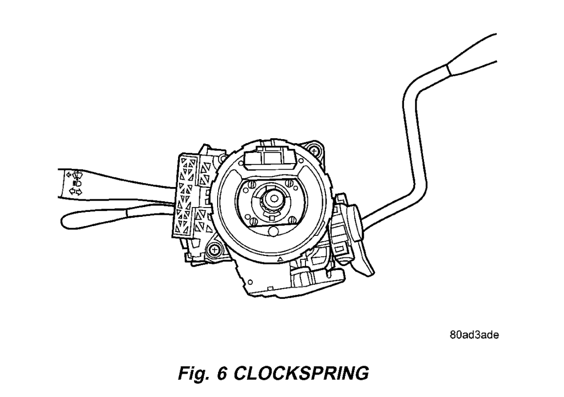

14. Disconnect the wiring harness connectors from the clock spring, multi-function switch, halo lamp, SKIM module, ignition switch and BTSI solenoid.

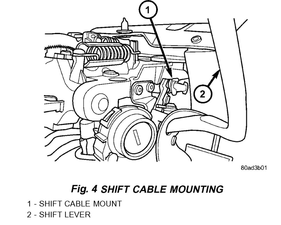

15. Disconnect the shift cable at the lever.
16. Remove the pinch side clip, then remove the cable from the bracket on the column.

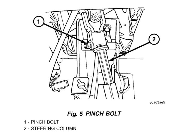

17. Remove the pinch bolt coupling.

21. Remove the clock spring.

6. Install the clock spring.

10. Install the coupling onto the intermediate shaft and install the pinch bolt. Tighten the pinch bolt to 28 Nm (250 inch lbs.).
11. Install the cable from the bracket on the column, then install the pinch side clips.
12. Reconnect the shift cable at the lever.

14. Install the steering wheel.
15. Install the vibration damper weight.
16. Install the steering wheel retaining nut. Tighten the nut to 61 Nm (45 ft. lbs.)
