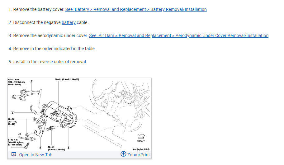

Can you send me step by step instructions on removing and replacing the starter motor?

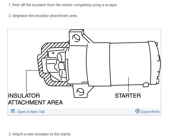

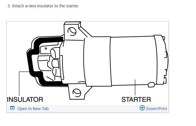

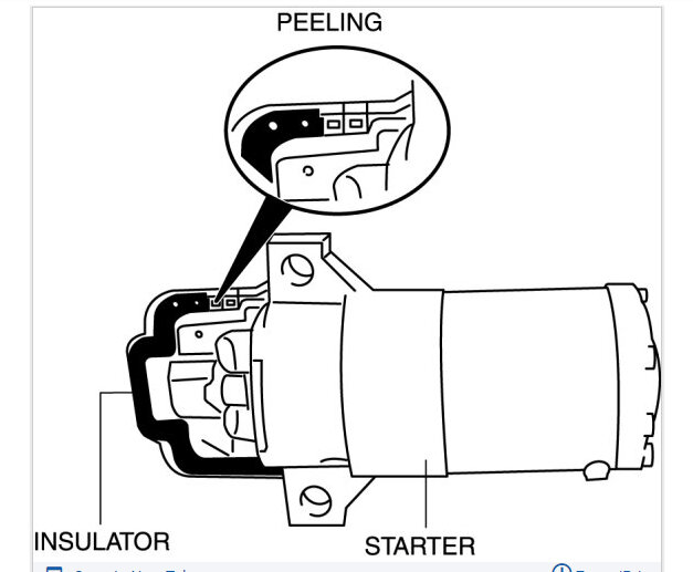

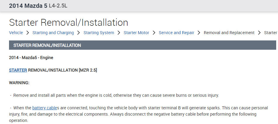

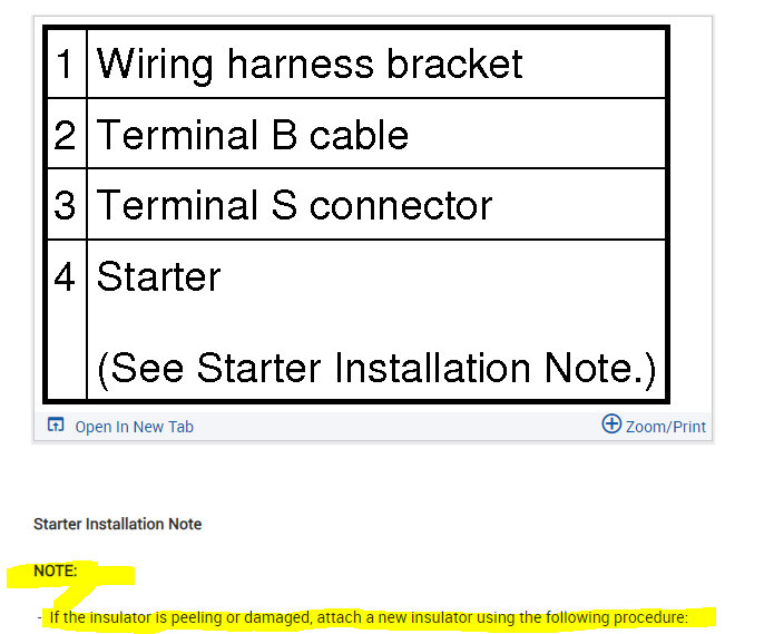

As far as replacing the starter motor, here is a link that explains in general how it's done. This is to help get you started.
If you look below, the directions specific to this vehicle are listed.
Let me know if this helps.

No problem whatsoever. I hope it helps. Make sure before starting that you disconnect the battery negative terminal.
