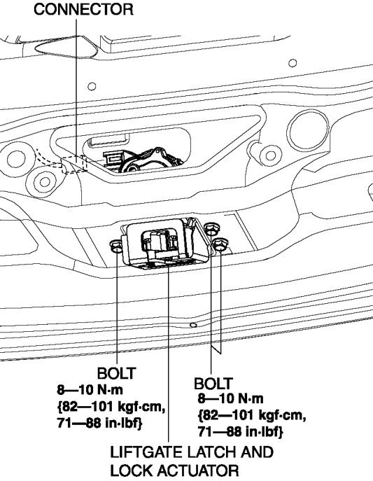

Can you send me the instructions, with diagrams, to replace the entire lock mechanism with the actuator? As usual, thanks in advance for your unbelievable services.

Here are the directions you asked for. Let me know if they help.
________________
2014 Mazda 5 L4-2.5L
Liftgate Latch And Lock Actuator Removal/Installation
Vehicle Body and Frame Doors, Hood and Trunk Trunk / Liftgate Trunk / Liftgate Latch Service and Repair Removal and Replacement Liftgate Latch And Lock Actuator Removal/Installation
LIFTGATE LATCH AND LOCK ACTUATOR REMOVAL/INSTALLATION
2014 - Mazda5 - Body and Accessories
1. Disconnect the negative battery cable.
2. Remove the following parts:
a. Liftgate upper trim See: Trunk / Liftgate Moulding / Trim > Removal and Replacement > Liftgate Upper Trim Removal/Installation
b. Liftgate side trim See: Trunk / Liftgate Moulding / Trim > Removal and Replacement > Liftgate Side Trim Removal/Installation
c. Liftgate recess See: Trunk / Liftgate Moulding / Trim > Removal and Replacement > Liftgate Recess Removal/Installation
d. Liftgate lower trim See: Trunk / Liftgate Moulding / Trim > Removal and Replacement > Liftgate Lower Trim Removal/Installation
3. Remove the bolts.
pic 1
4. Disconnect the connector.
5. Remove the liftgate latch and lock actuator.
6. Install in the reverse order of removal.
__________________________________-
