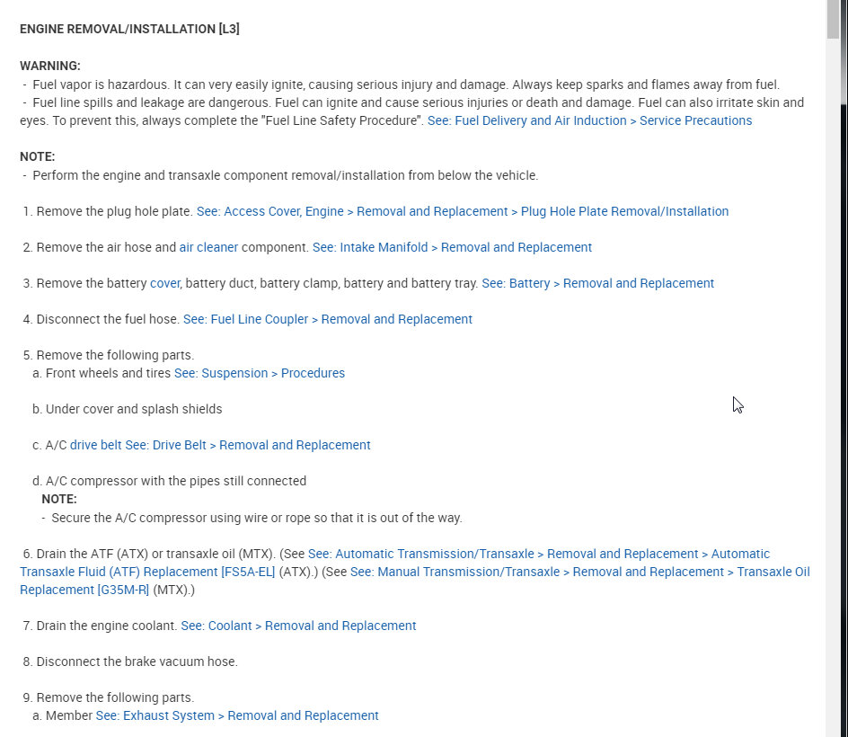

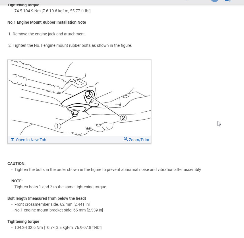

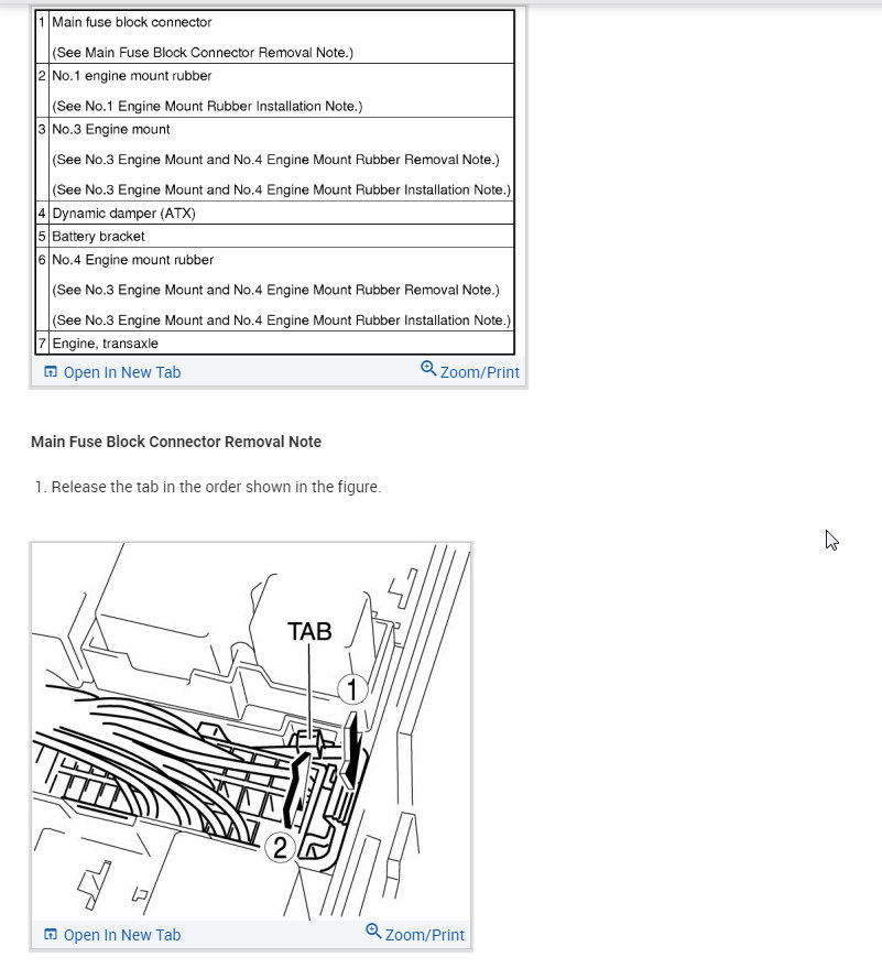

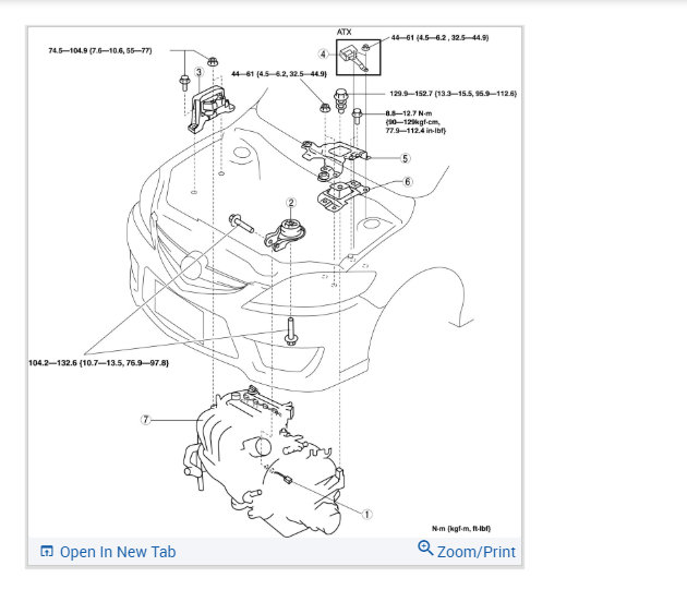

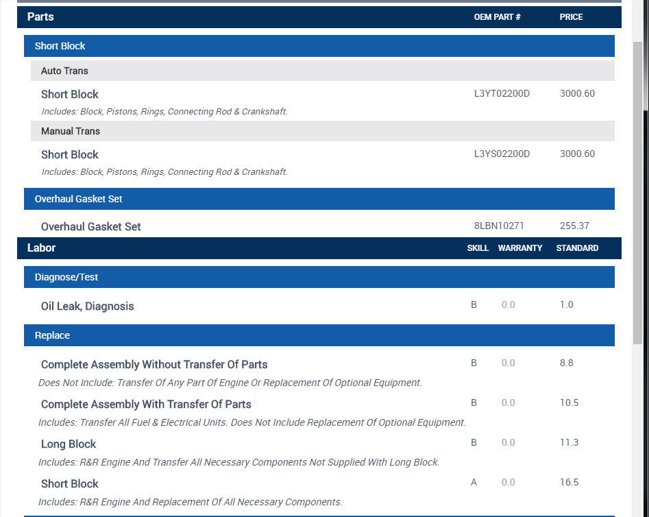

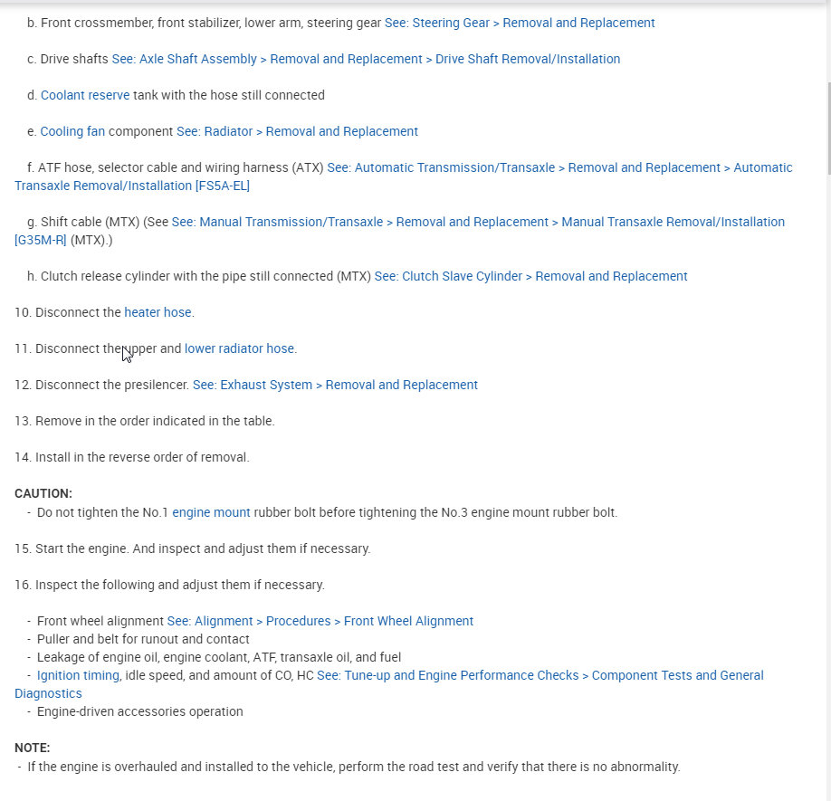

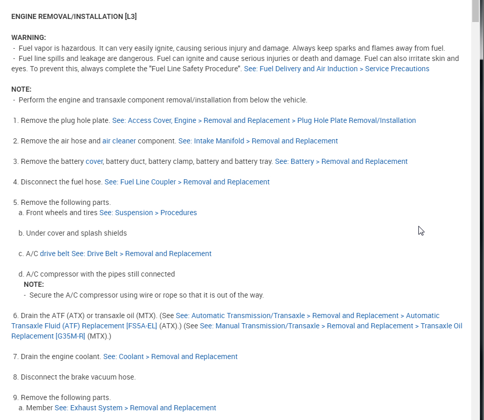

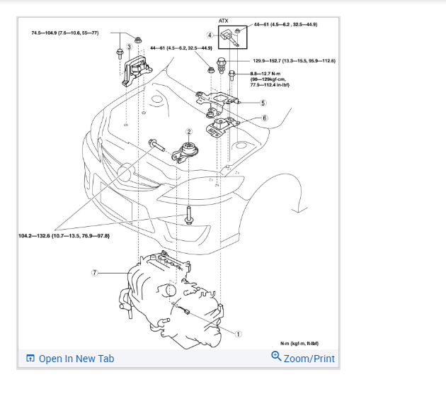

How many hours should it take to remove and replace the engine
2009 MAZDA 5
112,000 MILES • 2.3L • 4 CYL • 2WD • AUTOMATIC
JONSOLOW13
  • 133 POSTS
Can you send instructions and diagrams?

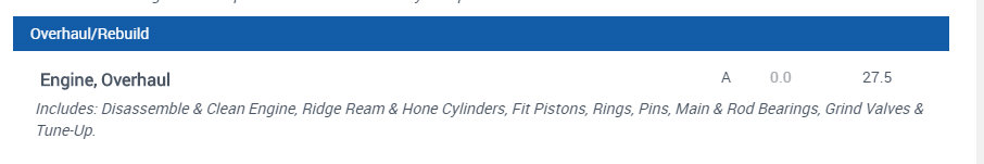

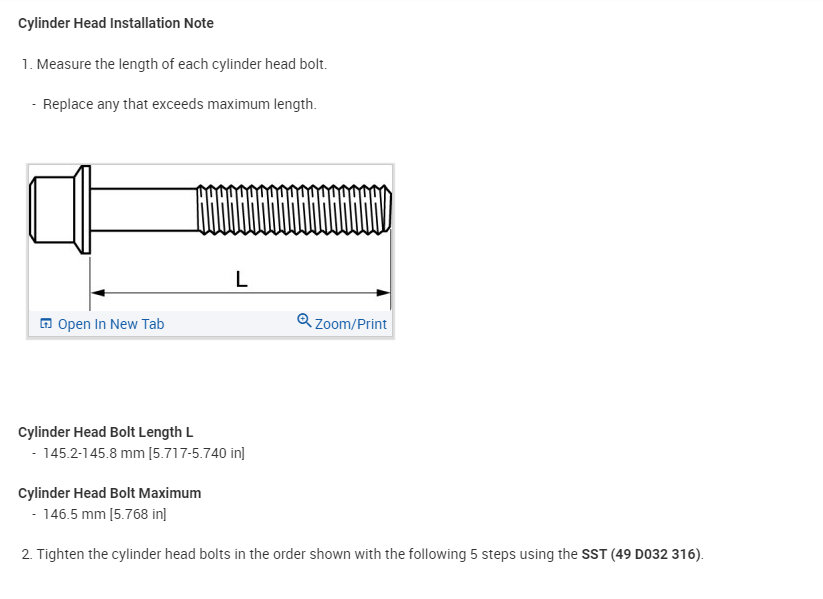

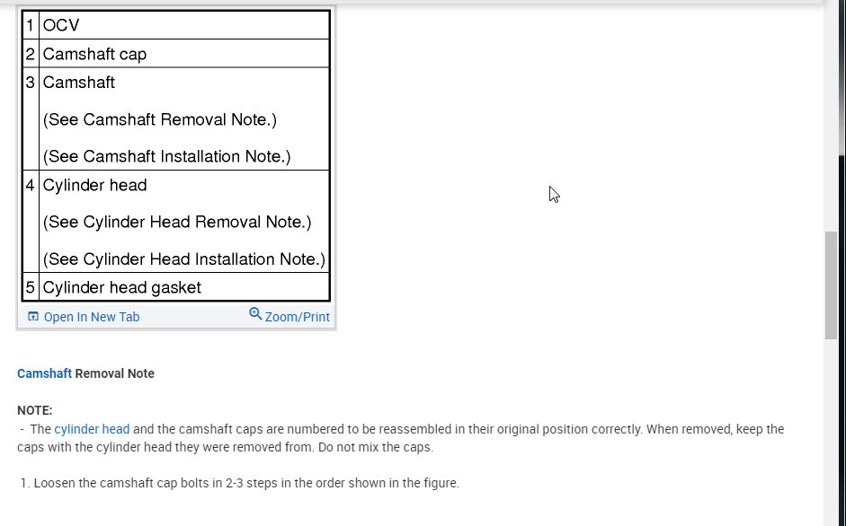

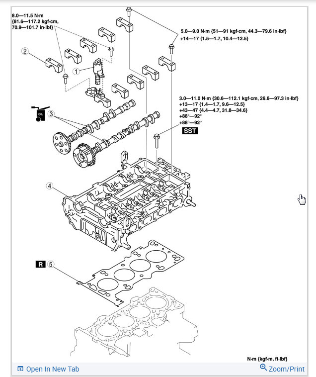

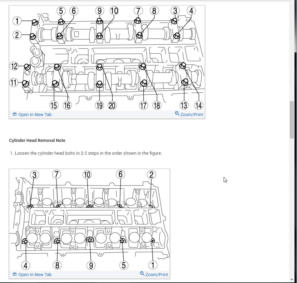

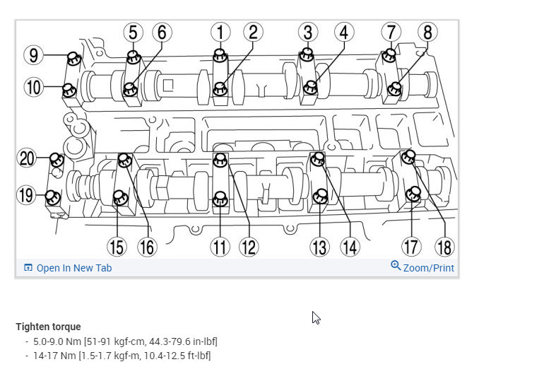

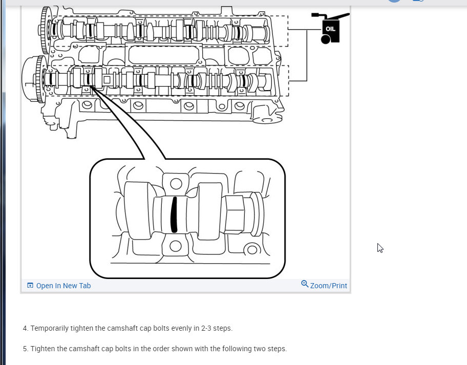

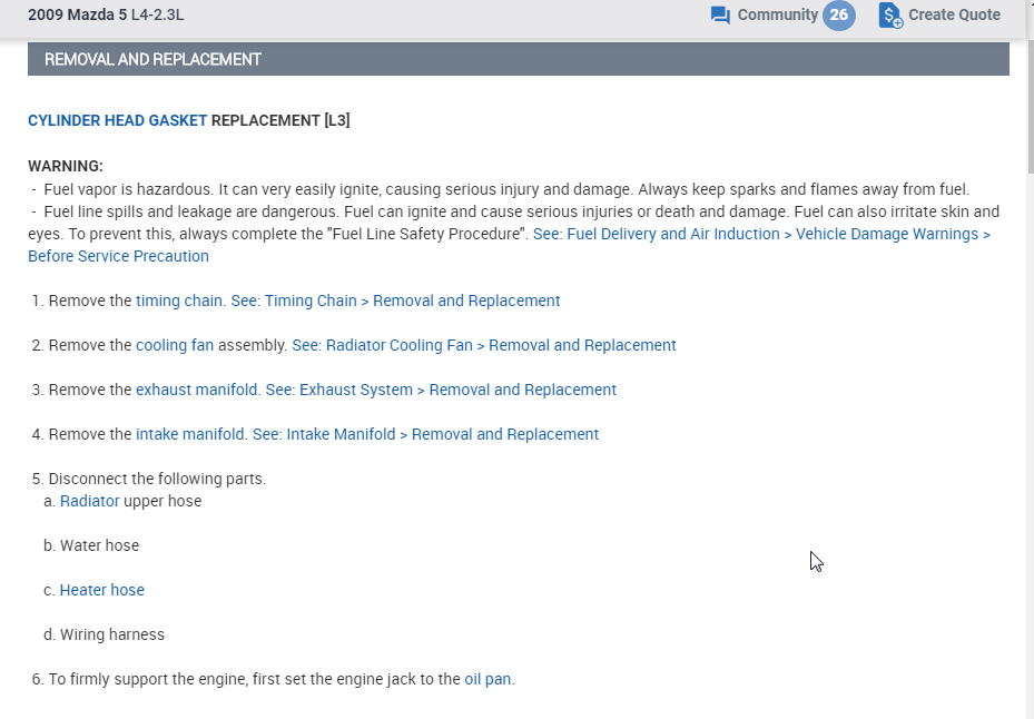

Also, how many hours should it take to remove and replace the head gasket, knowing we will have to have the head milled?
Thanks as usual,
Jon
Jan 22, 2020 at 7:54 AM

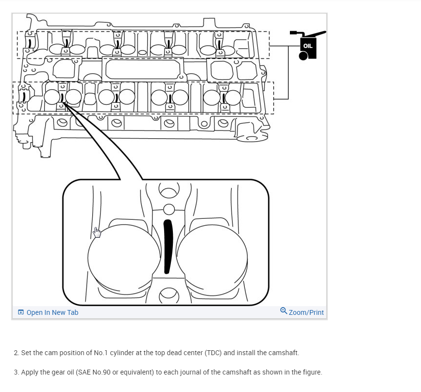

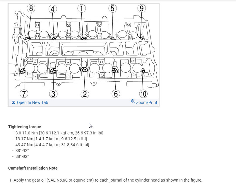

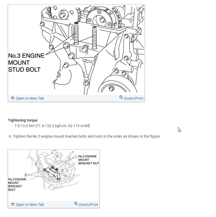

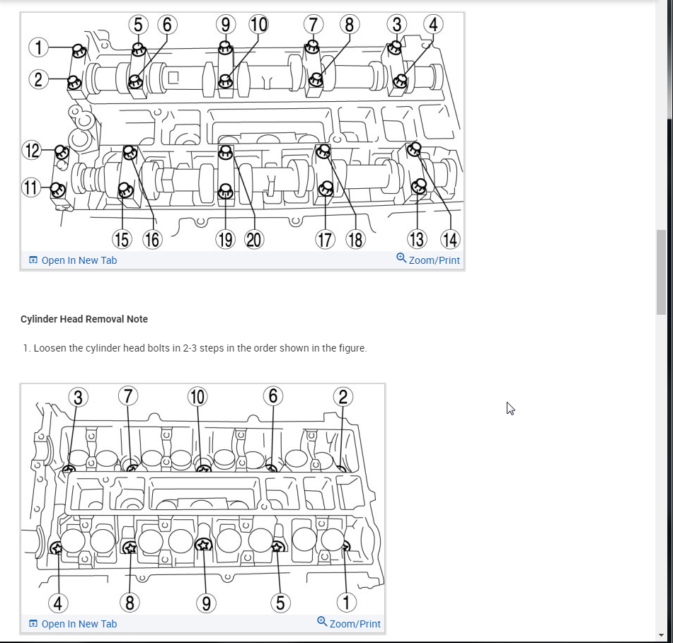

I attached the engine removal procedure and the head gasket procedure. Also, the book times for removal and overhaul for your review. Let me know if you needed more info. Thanks
