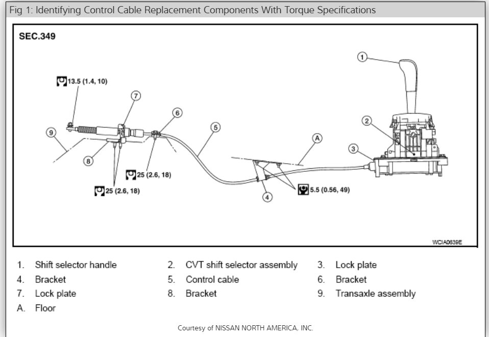

How to remove and replace the Automatic Transmission Shifter Cable?
85,000 MILES • 1.6L • 4 CYL • 2WD • AUTOMATIC

Can you send us the instructions (with diagrams if possible) for removal and replacement shifter control cable for the car listed above?

Sure, it looks like the shifter cable is going to need to be removed from the transmission first and then pulled through the interior after it is disconnected from the shifter itself. Check out the images (below). Let us know if you need anything else.
