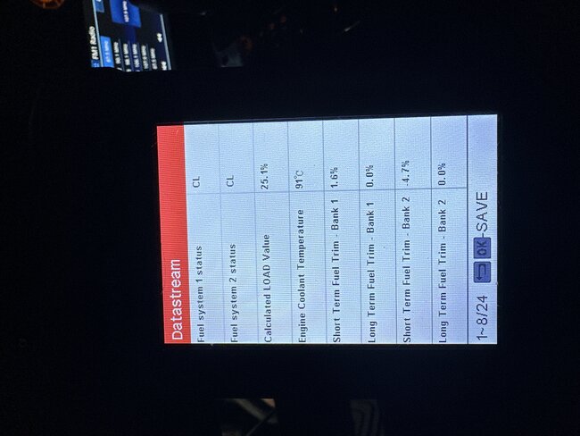

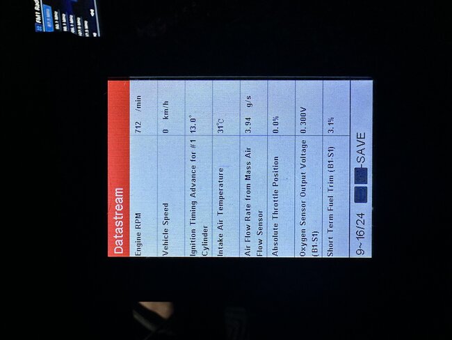

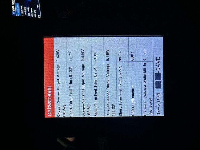

It was roughly 50 degrees or so when I recorded that and no coolant it smelled kind of rotten. But I checked my data stream and noticed that my absolute throttle position is reading 0.0% even when pressing the pedal, it doesn’t move.
Dec 17, 2022 at 10:50 AM
JAEDAV
  • 22 POSTS
Here are some pictures of my data stream.
Dec 17, 2022 at 10:52 AM
JAEDAV
  • 22 POSTS
Dec 17, 2022 at 10:53 AM

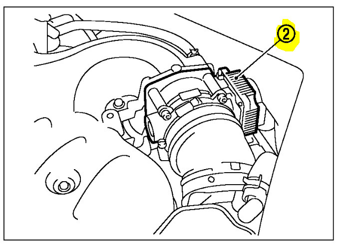

  • 110,240 POSTS

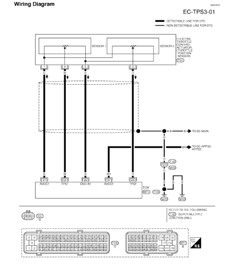

Check the throttle position motor wiring connector to make sure it isn't damaged or corroded.
I attached a pic below of the throttle motor.
Let me know what you find.
Dec 17, 2022 at 4:37 PM

So the harness and all the wiring looks good.
Dec 18, 2022 at 4:34 AM

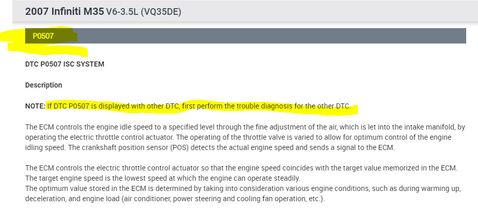

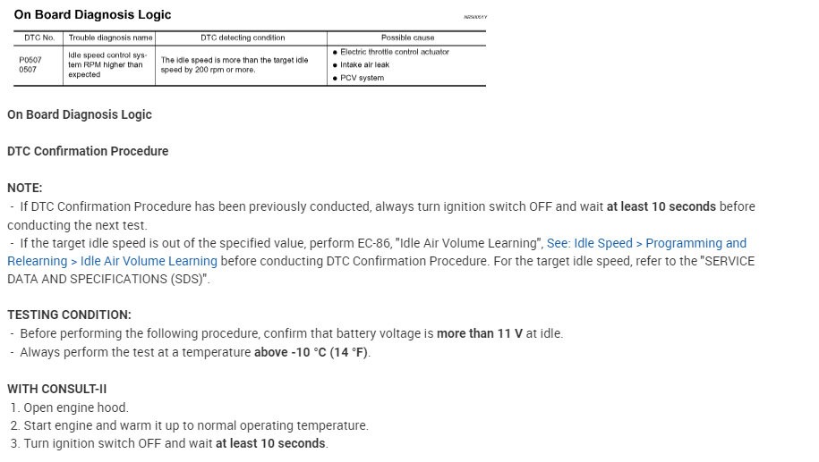

The car actually has two codes now.
P2135 and P0507.
Dec 18, 2022 at 8:08 AM
  • 110,240 POSTS

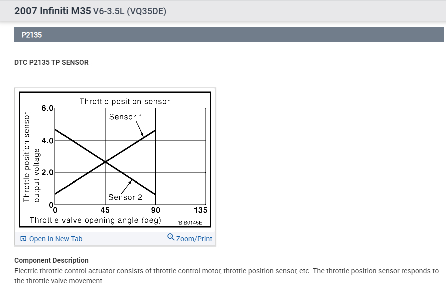

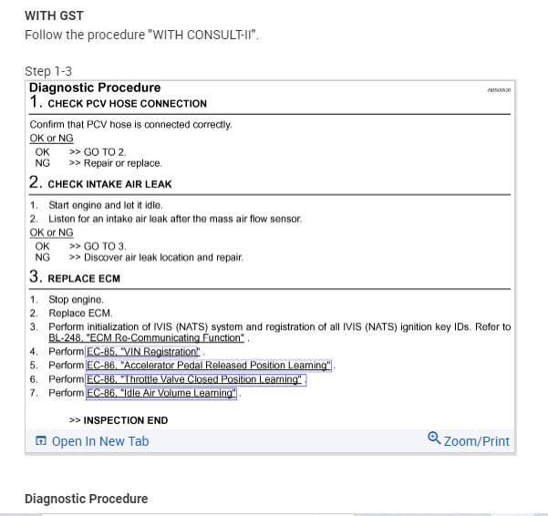

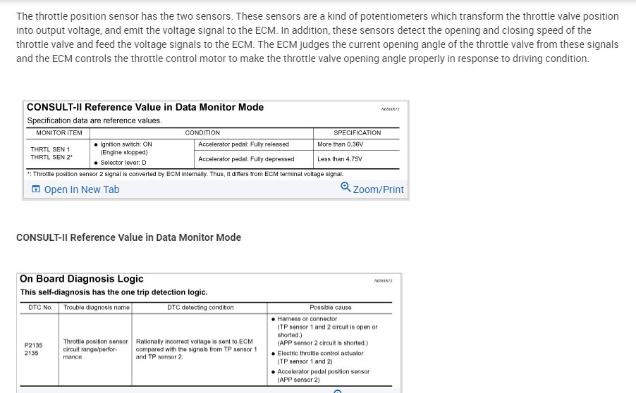

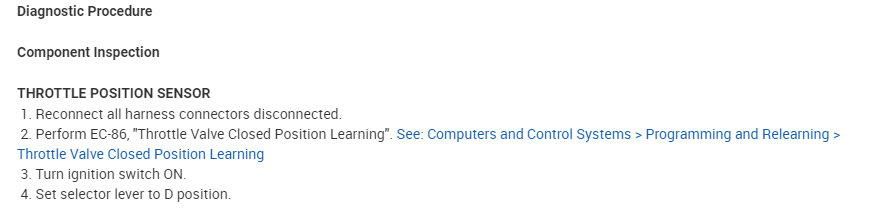

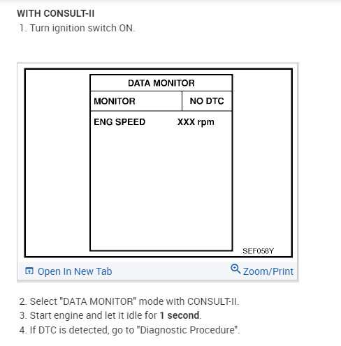

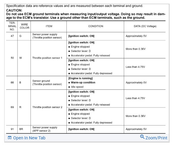

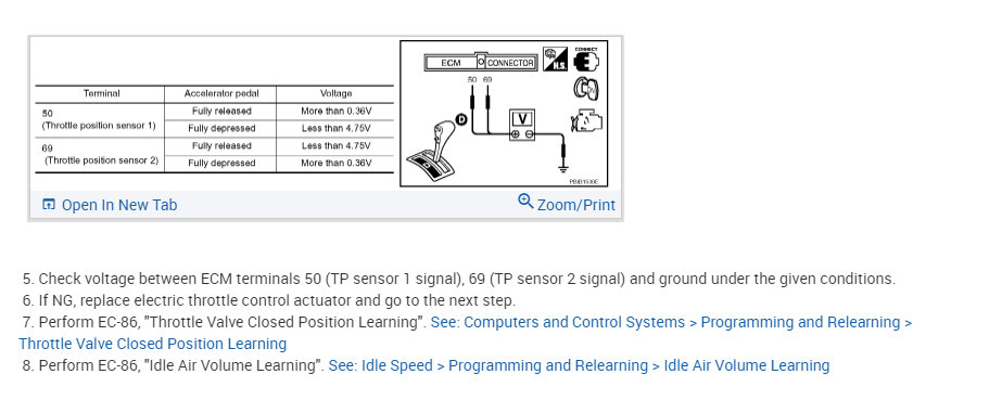

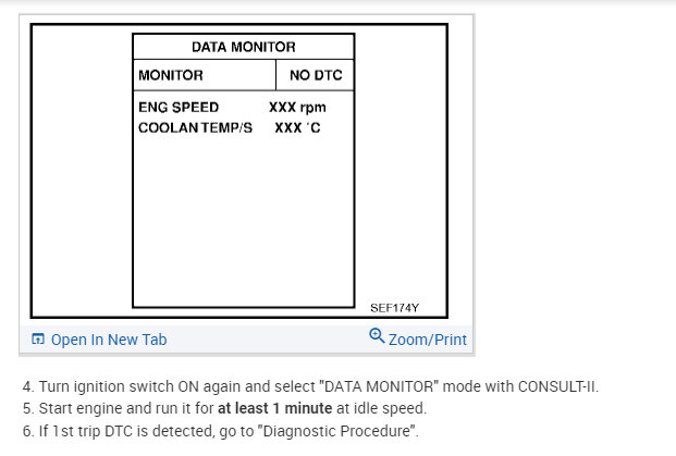

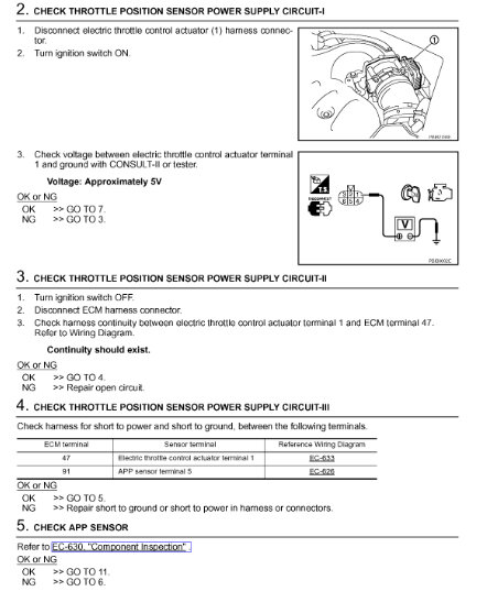

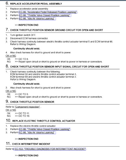

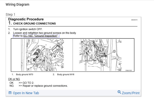

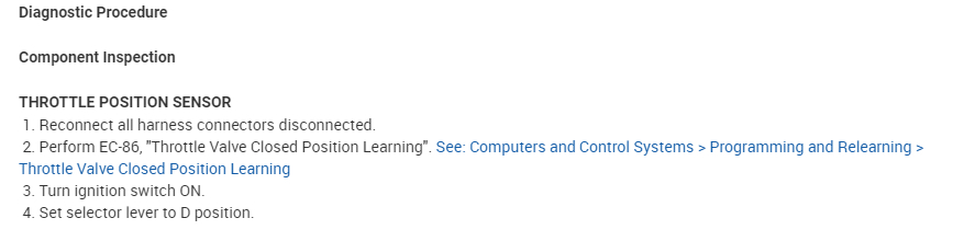

Both codes are related to the throttle position sensor. At this point, we need to go through the diagnostics to see what is causing the problem.
If you look below, I attached the diagnostics starting with the P2135. The rationale is this. The P0507 indicates if there are additional codes, they should be checked first.
The testing does require a scan tool that can communicate with the PCM. Take a look through them and let me know if you are comfortable performing them.

Thanks I can perform these !

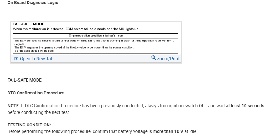

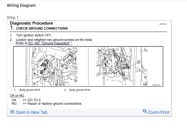

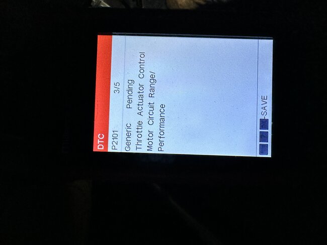

So, I ended up replacing the throttle body based off what the testing showed, and it threw this code after replacing it and the car would rev past 2,000 but slowly like there’s a delay between the pedal and the throttle body. Also, my exhaust smells funny not like coolant, but it smells rotten. Oh, and one last thing was after I did the relearn procedure the car wouldn’t rev up how it was anymore.
Dec 21, 2022 at 9:10 AM
  • 110,240 POSTS

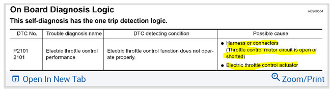

The smell you mentioned leads me to think either we are getting way too much fuel to the engine, or the catalytic converter is plugged. By chance, are there any strange sounds from the exhaust? If you remove the upstream oxygen sensor, does it run better?
Next, the new code is usually the result of either a wiring issue between the ECM and throttle control motor or the throttle control actuator. See pic 1 below.
Have you already checked or replaced either of them?
See pic below.
