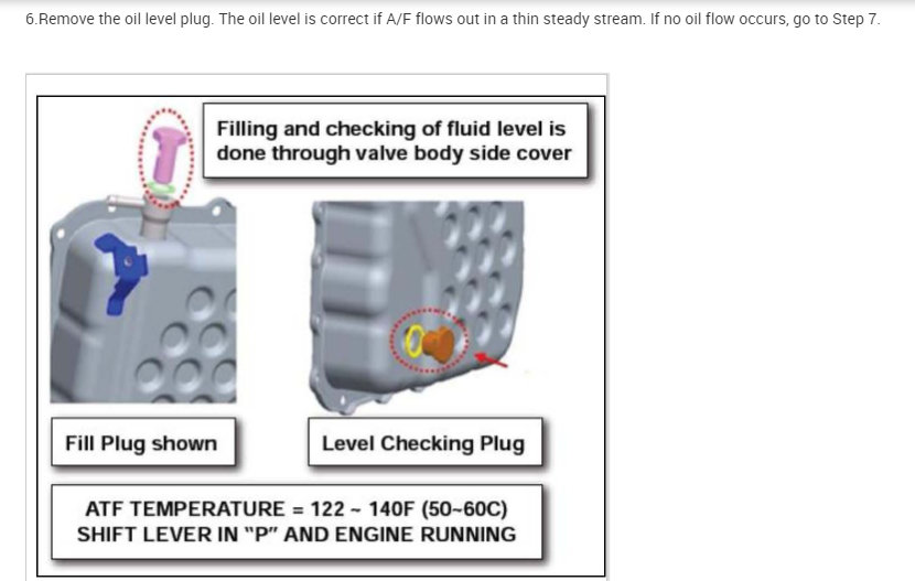

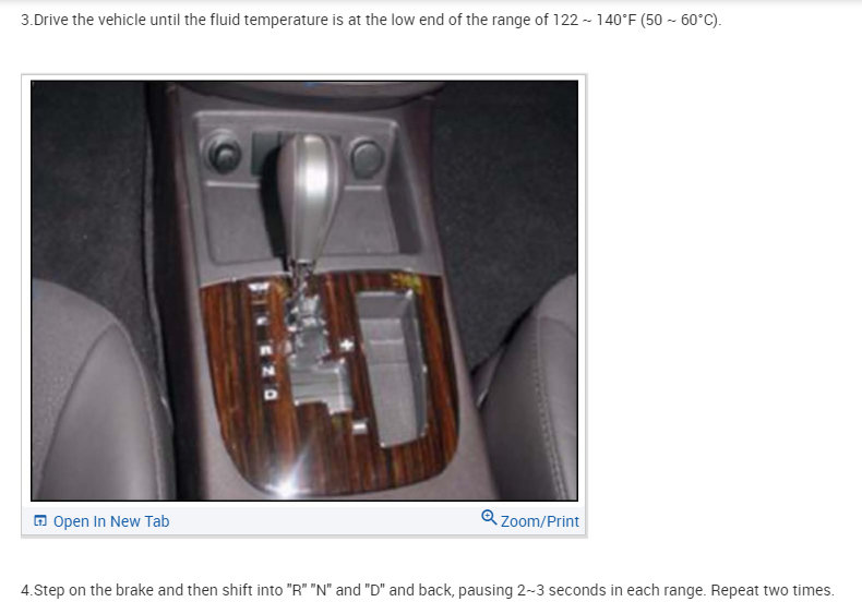

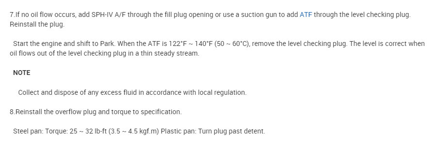

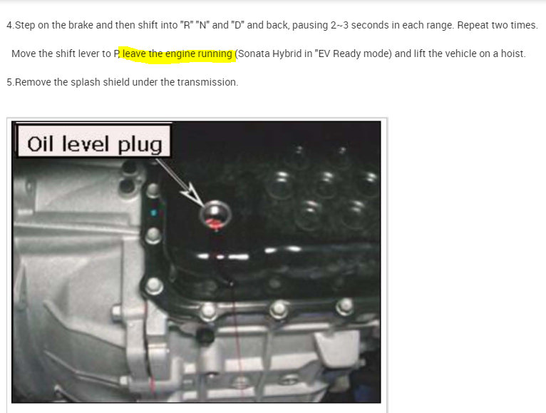

When you pull out and the RPMs increase, does the vehicle accelerate or does it feel like the clutches may be slipping in the transmission?
Also, have you had the computer rescanned to see if there are new diagnostic trouble codes? Have you checked the transmission fluid level and condition?
If you haven't checked the fluid level, I attached the directions below. It is somewhat difficult to perform at home because the engine needs to be at operating temperature and running. On the transmission oil pan, you will remove a fill port to determine if it is full.
Take a look through the directions and let me know what you find or if you have questions.
