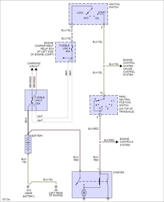

Just replaced timing belt, all drive belts, had oil changed and radiator flushed. Was running great but was on highway and rpm's revved high. pulled over, did not run hot and now will not crank. Any suggestions? Have not ran code scan on yet just looking for suggestions.

If it is not cranking, then you need to check the starter cranking circuit first. It could be a loose battery terminal or ground connections. A bad wiring connection can cause symptoms described.

Make sure you do not have a blown fusible link 4 in the engine compartment relay box, located under the hood, left side.
