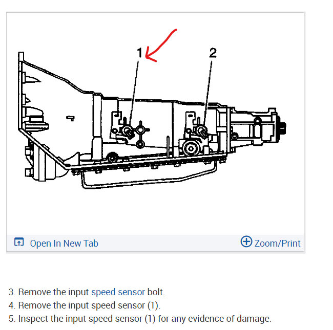

It sounds like the input shaft sensor is not working but we should run the codes to see if any are stored.
Here is a guide to help us:
Here is the location of the sensor and how to change it out in case there is a code for it. Can I ask if the speedometer is working? Please start a new question for the 4wd light flashing. Check out the images (below). Please let us know what happens.

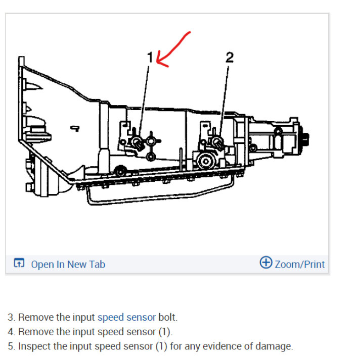

Also, would the 03 have an input shaft speed sensor? I know they were introduced in 04. Where would it be?
Aug 2, 2024 at 3:12 AM
  • 55,616 POSTS
Yep, these should not affect the transmission shifting.
P0157 - O2 Sensor Circuit Low Voltage (Bank 2, Sensor 2):
P0332 - Knock Sensor 2 Circuit Low Input (Bank 2):
The input shaft sensor is in the image below, if this doesn't work I would disconnect the instrument cluster and drive it to see if it is causing the problem. Check out the images (below). Please let us know what happens.
Aug 3, 2024 at 3:17 AM
JACOB MARINO
  • 45 POSTS
I disconnected the cluster and it still ran as bad. I went to look for the speed sensor and it’s blocked by the front driveshaft, the exhaust, and a scrape plate. I might just have it sent in for a rebuild because there is problems with the tranny, 4wd, and it’s leaking oil so bad it’s almost impossible to get the bottom clean enough to see anything.
