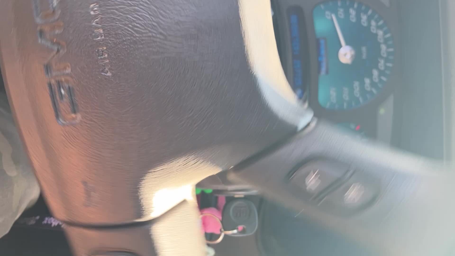

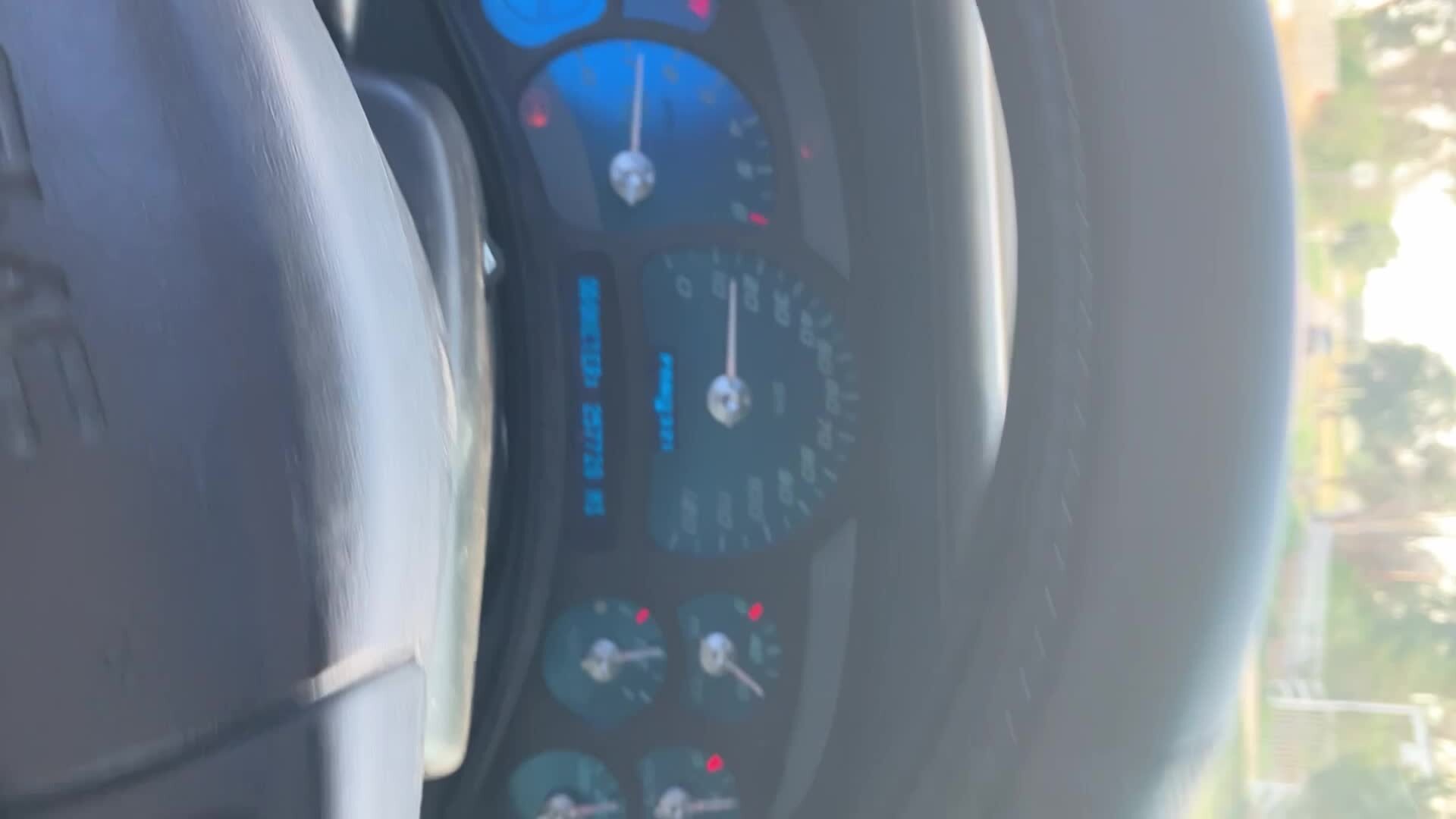

What the subject says. Driving off in the first gear it drags out the RPMs and then shifts really rough. All the gears do it but first is the worst. Seeing as it’s an older truck I wouldn’t be shocked if the tranny was going but just wanted a second opinion. Also, another issue but not as important, it won’t shift out of 2nd and says service 4wd. Any common causes I can start crossing off? Let me know if you have questions!

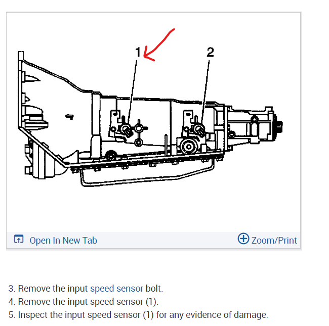

It sounds like the input shaft sensor is not working but we should run the codes to see if any are stored.
Here is a guide to help us:
Here is the location of the sensor and how to change it out in case there is a code for it. Can I ask if the speedometer is working? Please start a new question for the 4wd light flashing. Check out the images (below). Please let us know what happens.

The only codes are some exhaust codes. The Speedometer works but he switched out the cluster before I bought it a year or so ago so it’s off by 5 mph. I can try to send a video of exactly what it does when it wants to shift if that would help.

I’m checking out the article now but here’s the videos. It’s hard to hear but I have to give it more gas for it to actually shift or it’ll just drag out a few seconds longer.

Yep, it is shifting late, did it shift late with the old cluster? Thanks for the videos, they help.

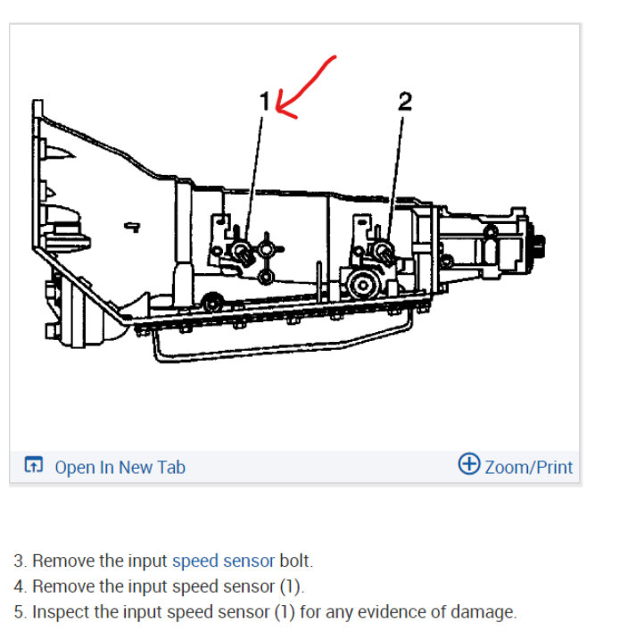

Also, would the 03 have an input shaft speed sensor? I know they were introduced in 04. Where would it be?
Aug 2, 2024 at 3:12 AM
  • 55,433 POSTS
Yep, these should not affect the transmission shifting.
P0157 - O2 Sensor Circuit Low Voltage (Bank 2, Sensor 2):
P0332 - Knock Sensor 2 Circuit Low Input (Bank 2):
The input shaft sensor is in the image below, if this doesn't work I would disconnect the instrument cluster and drive it to see if it is causing the problem. Check out the images (below). Please let us know what happens.
