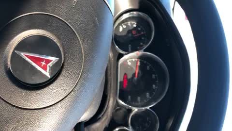

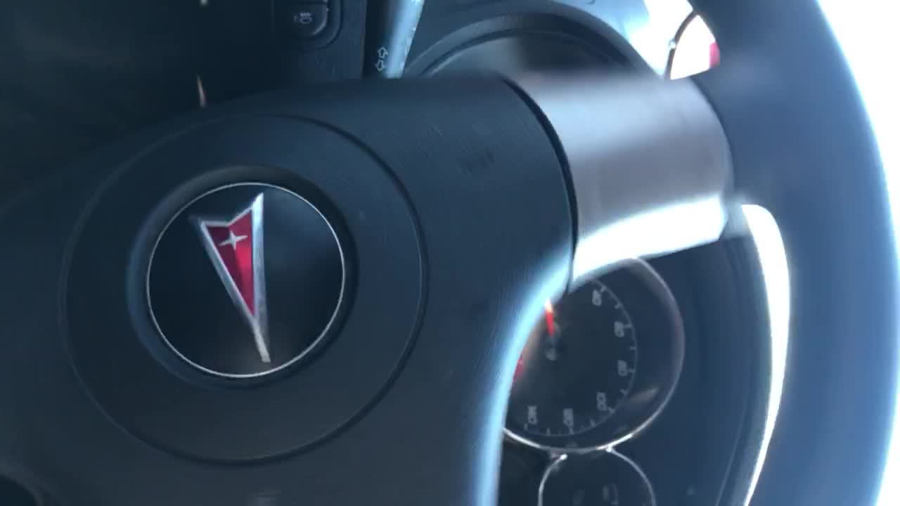

RPM's go up and the car will slowly accelerate and will make a noise sounding like metal scraping
2008 PONTIAC G6
141,000 MILES • 3.5L • V6 • 2WD • AUTOMATIC
ZSANTI14
Usually when I press the gas going straight, RPM's will go up to 5000 RPM's, however under 10 mph. When I turn left or right, the car doesn't seem to accelerate at all not even slowly hardly. The car will make a noise where it sounds like something is scraping is against something.

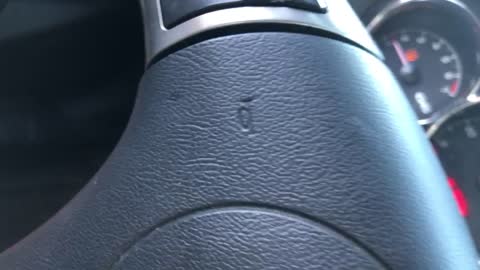

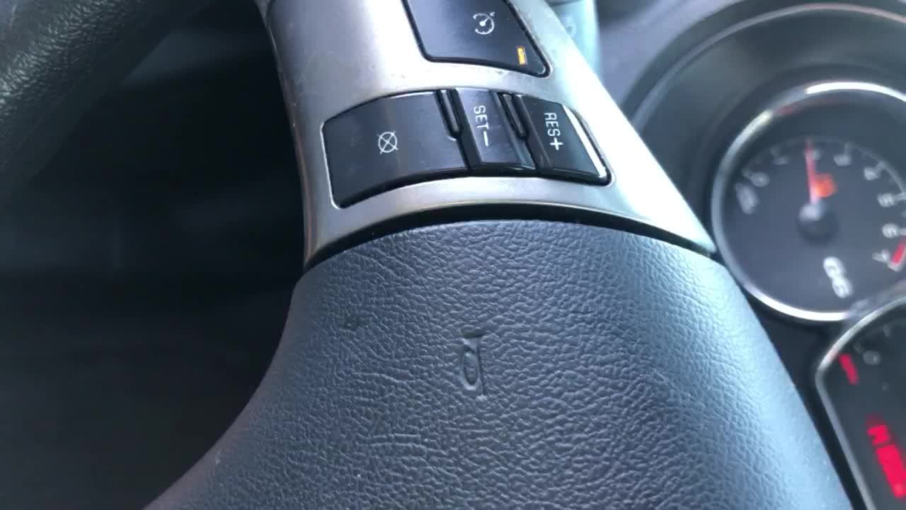

ZSANTI14
Yes of course. the first video is an example of the rpm's going up while I press the gas pedal kind of slowly. The second will be the noise I was talking about. It’s kinda faint I have to listen close to hear it. Sorry there were other cars in the area.
Oct 23, 2019 at 9:07 AM
it sounds like it is starving for fluid from a clogged filter in the transmission.
I would start by changing the fluid and filter and see if there is any debris in the bottom of the pan.
