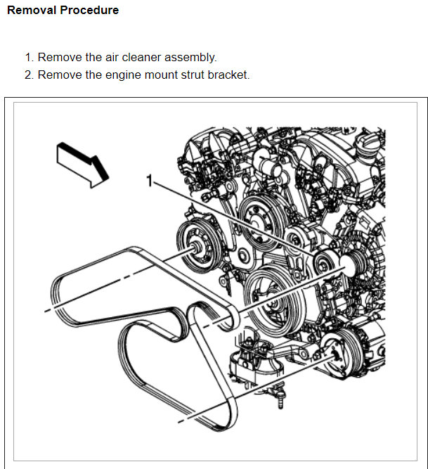

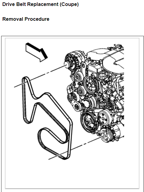

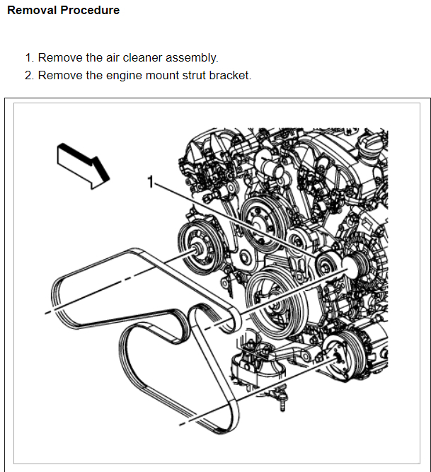

This is because the serpentine belt needs to be changed here is a guide and diagrams below to help you get the job done.
I gave you both engines.
Cheers
Jul 18, 2011 at 4:33 PM
GREENWAY59
I have the exact same problem loud whistling/squealing noise above 2000 rpm's in gear or in park/neutral. I replaced the belt and all fixed I love this site!
