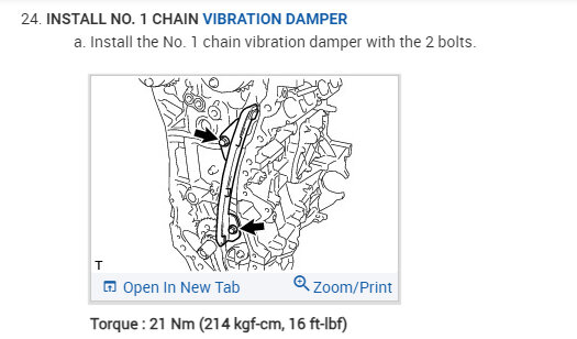

I bought this car about two years ago. The first issue that I had with it was a blown coolant hose (quick replacement fixed the issue). The second time coolant leaked into my engine which caused my engine to overheat and instead of purchasing a new engine I had the heads fixed. This took a long time but eventually the car got back to me but with new problems. I now have two permanent codes which are p0015 and p0017. I also have the engine light on but not flashing. The issue of fluctuating RPMs during idle is the third issue which I've tried to solve. MAF sensor works. The new throttle body did not solve the problem and I've tried the relearn procedure, but it doesn't seem to work. I've also done a vacuum leak check with a smoke machine, but I couldn't find any leaks. New spark plugs and Ignition coils. I've also sprayed throttle body cleaner around the engine but no results. The car drives but when taking off from a stop it hesitates for a second before accelerating. There is a significant loss of acceleration power. I hope you guys can help me with this issue. I would appreciate any kind of help or tips. Thank you

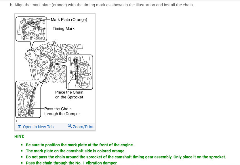

Did this issue start after having the work done on the cylinder head? I ask because both codes are related to engine timing. The P0015 indicates the exhaust camshaft is retarded and the P0017 simply indicates there is a timing variation between the crankshaft position sensor and camshaft position sensor.

If that is the case, there is a good chance the timing was not set properly. Would the individual that did the work check it for you?

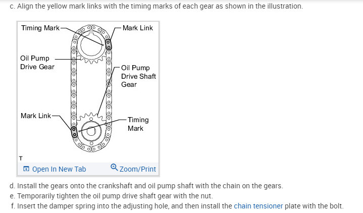

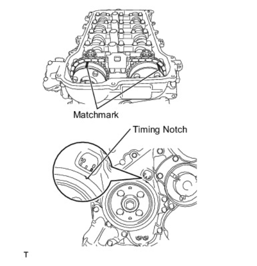

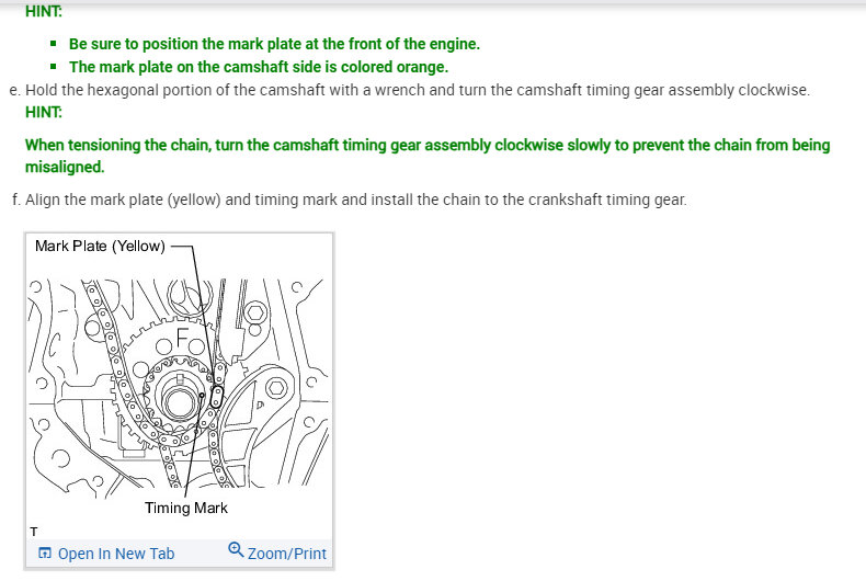

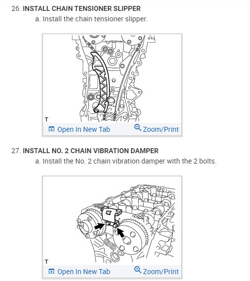

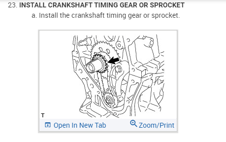

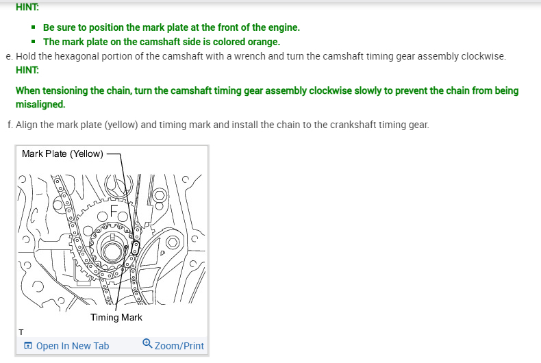

I'm not sure what you are comfortable with, but it wouldn't hurt to try. It will require some special tooling. What we really need to know is if the camshafts are properly timed with the crankshaft.

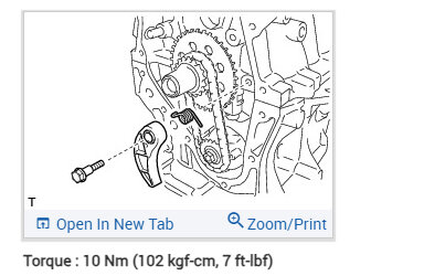

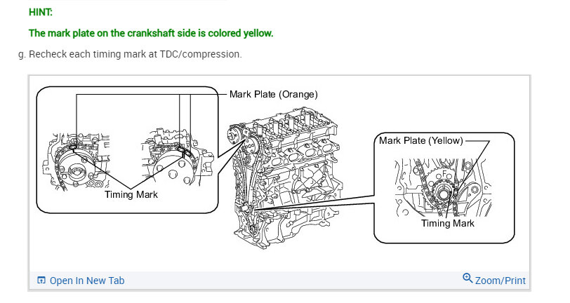

Take a look at the pic below. It shows the alignment points. Also, if I recall correctly, there should be links in the timing chain that are a different color that line up with the marks.

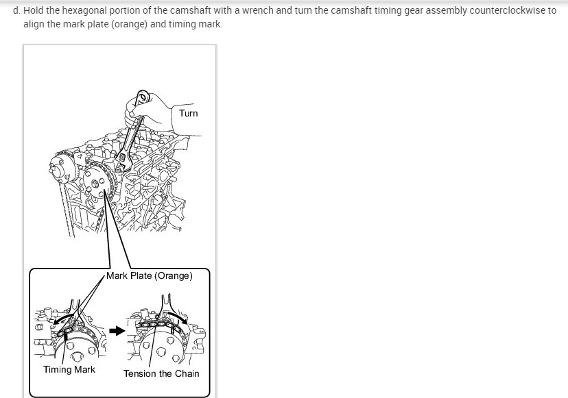

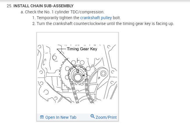

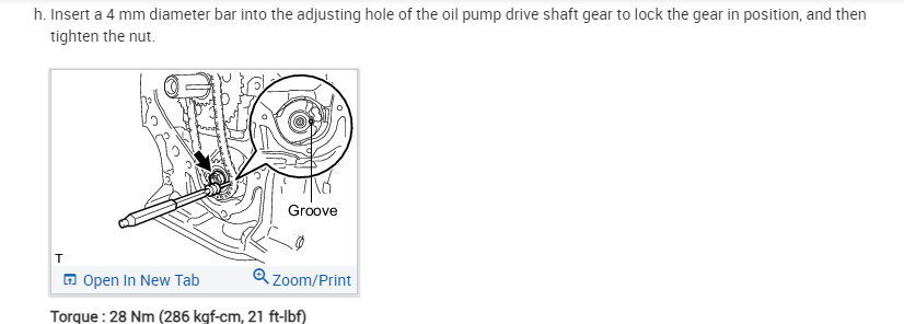

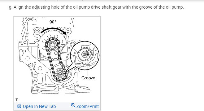

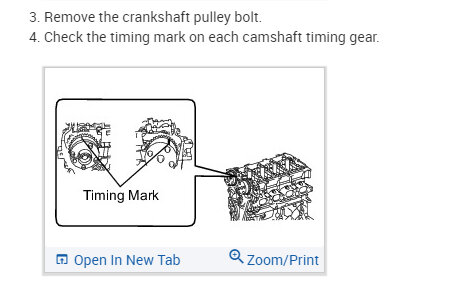

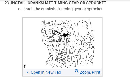

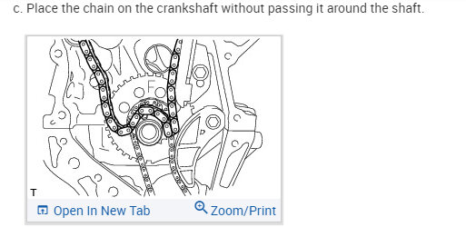

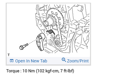

Let me know if this is something you feel comfortable doing. Also, if timing is an issue, I wanted you to see what needs to be done to time it, so the remaining pics (starting with pic 3) are the directions.
Let me know your thoughts.
