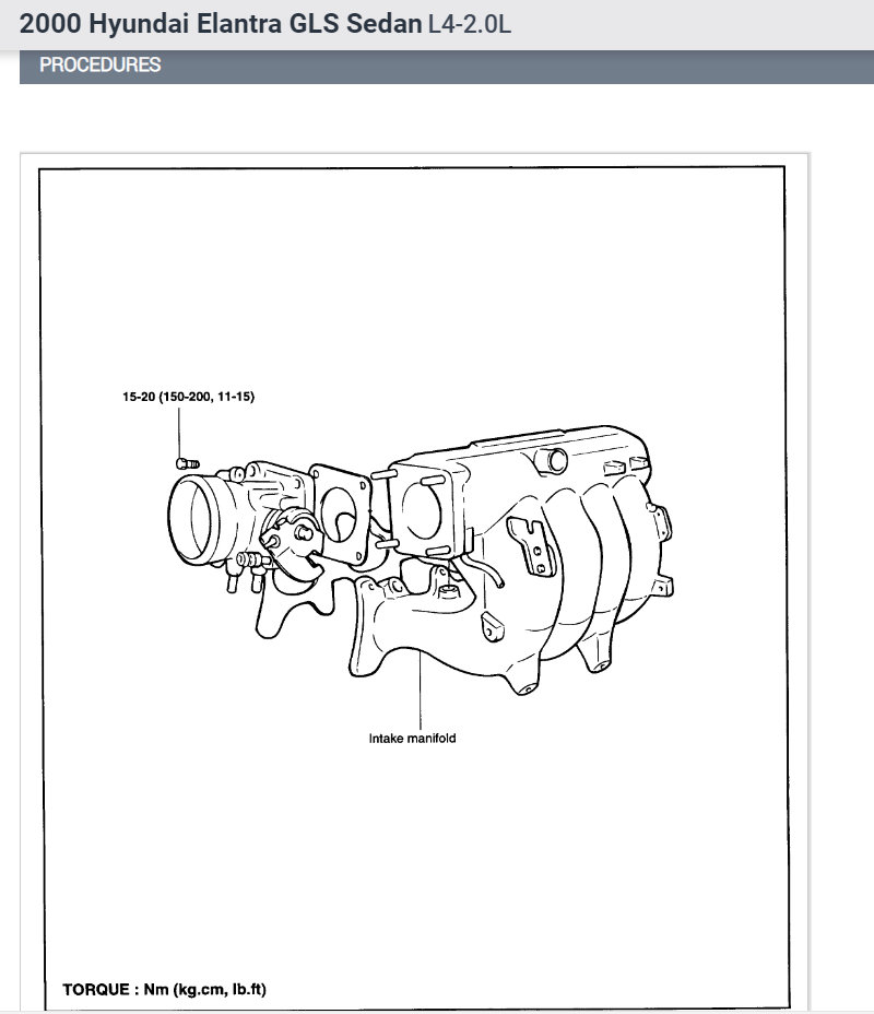

When you make a complete stop and go to accelerate, she dips like she's going to shut off but goes back to normal and continues, drives fine if I don't stop but that's an issue. She has a check engine light on for a small leak in evap system, but I've fixed all the things that I thought would fix it, IAC valve, fuel filter, fuel pump and spark plugs.
Aug 30, 2022 at 2:23 AM
  • 55,766 POSTS
This does sound like you have a vacuum leak or the throttle bore needs to be serviced.
Here are two guides that will help you:
And this guide, make sure the engine is cold when you do the test:
