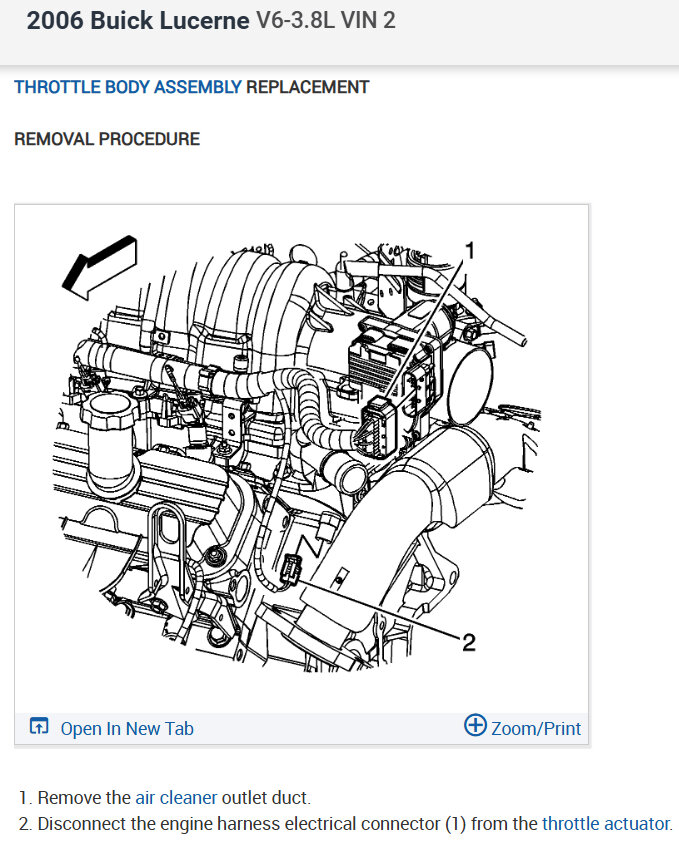

I drove my car yesterday and it operated normally. This morning, when I started my car, the RPMs fluctuated from 300 to 3,000. I waited a couple minutes to see if it would stop and it did not. I put the car in reverse, but the fluctuations remained. For some context, in the past I have noticed the RPMs fluctuating a bit when driving on the highway, but only by a few hundred RPMs. This is the first time the fluctuation has been so drastic. What might be causing this?

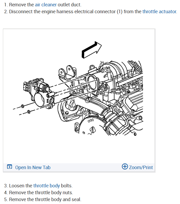

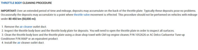

Mostly this can be caused by 2 reasons, the engine has a vacuum leak, or the throttle bore needs to be serviced. Also, do you have a check engine light on? If so, we should run the codes to see if any are stored, this guide can help:
If no codes are found, I would use this guide while the engine is cool:

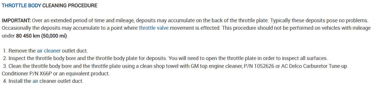

If no leaks are found let's service, the throttle bore. This guide will show you how with instructions for your car in the images below:

Yep, both a vacuum leak and a dirty throttle body will cause this issue.

I'm sorry for the late reply. I always forget to respond once the problem is solved. I wasn't able to clean the throttle body as thoroughly as I'd like without taking apart more than I was willing to. So, I cleaned the throttle body as well as I could while installed. I haven't had trouble since! Thank you!
