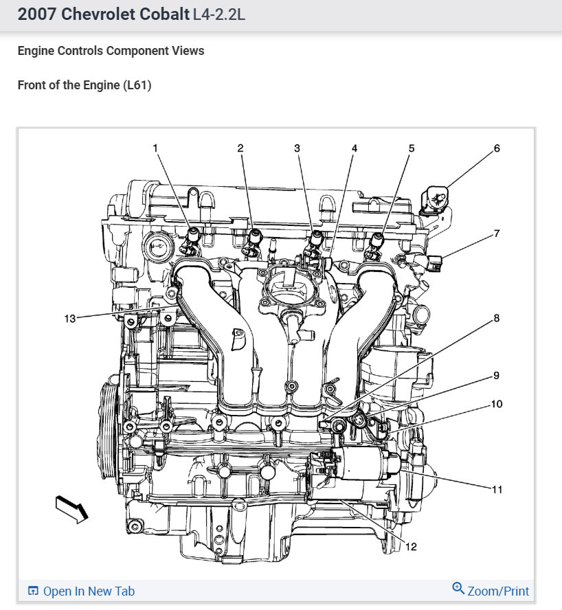

My car currently has no rpm sensor in it and i bought one, so i am wondering where does it go and how to install? It is an OEM rpm.

I had it mixed up with something else sorry but the sensor for my tachometer. My rpm gauge does not work at all as it does not have this sensor in.

If the engine is running it sounds like the cluster has gone out. Here is the location of the sensor which is the crankshaft position sensor.
1 - Fuel Injector 1
2 - Fuel Injector 2
3 - Fuel Injector 3
4 - Manifold Absolute Pressure (MAP) Sensor
5 - Fuel Injector 4
6 - Evaporative Emission (EVAP) Canister Purge Solenoid
7 - Camshaft Position (CMP) Sensor - Intake
8 - Knock Sensor (KS)
9 - Engine Oil Pressure (EOP) Switch
10 - Crankshaft Position (CKP) Sensor
11 - Starter Solenoid
12 - Starter
13 - Intake Manifold
