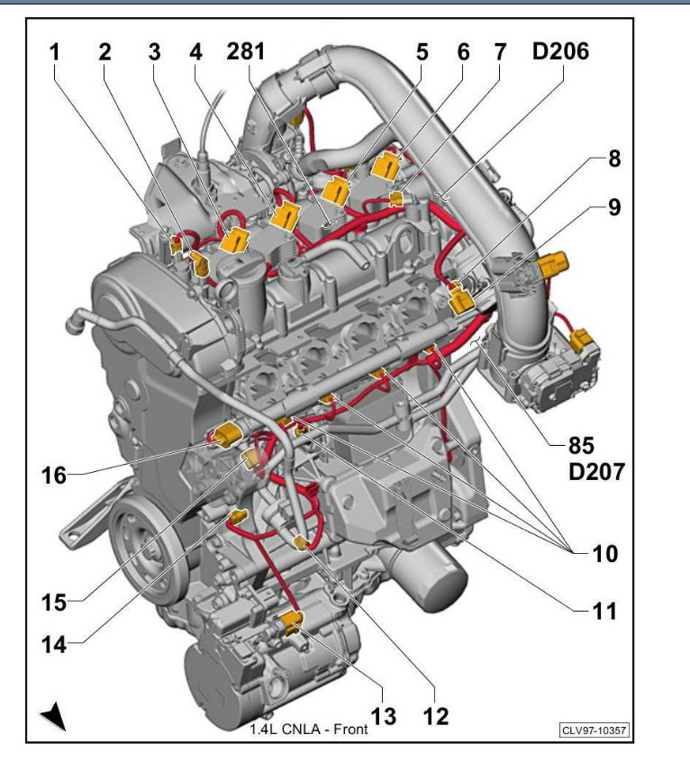

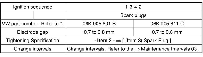

Thanks for the video, did this occur after the spark plug change? If so, I would remove the spark plugs and check for cranks in the plug which is common when you change them out also only use the ones mentioned below. It is very important to only use the spark plugs VW recommends. If okay, I would check for vacuum leak when the engine is cold.
This guide can help us fix it:
We should run the codes as well.
It could be the MAP sensor is starting to go out
Manifold absolute pressure sensor 06L906051B $96.67
