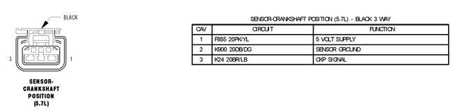

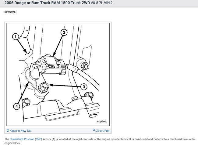

Ken, do you have instructions for testing a crankshaft sensor?
Oct 4, 2019 at 1:50 AM
  • 55,694 POSTS
Yes. here are the connector views check for 5 volts, ground and trigger will show up on a digital volt meter and bounce up to about 1.5 volts.
Check out the diagrams (below). Please run some tests and get back to us.
