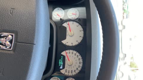

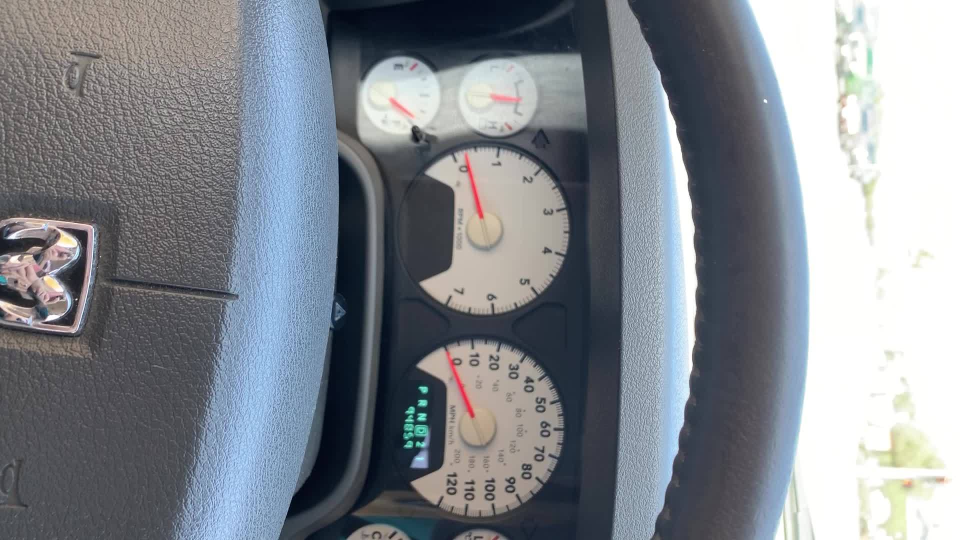

Here is a video showing the rpm on the dash at idle at a stop. You can see from the very start of the video it is around 400-500 rpm, and then quickly jumps down to 200 rpm and then slowly dips even lower than that, yet the engine is not shaky and does not stall.
When I had the scan tool hooked up and it was anywhere around the 200-400 rpm range on the dash, the ECM/scan tool was saying the engine was at an rpm of about 650, which of course is the normal rpm, and since the engine did not feel rough or shaky, I am inclined to believe that the ECM/scan tool is correct and the dash is wrong.

Okay, I will follow that procedure to clean the throttle body and let you know. but even if a dirty throttle body is the cause of the low RPM at idle, wouldn't the RPM gauge on the dash still match the RPM that the ECM/scan tool is showing?
I am also thrown off by the fact that the RPM gauge on the dash can get as low as 100-200 without the engine getting shaky and without any stalling.

You could have a cluster that is going out there were no codes when you scanned it?

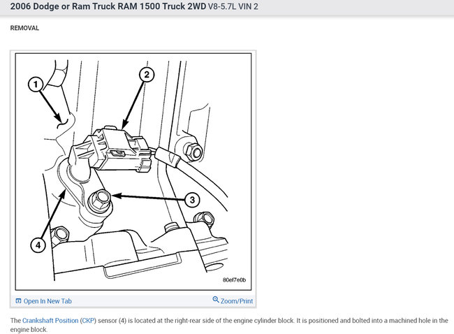

Lets look at the crankshaft sensor as well it could be getting weak.

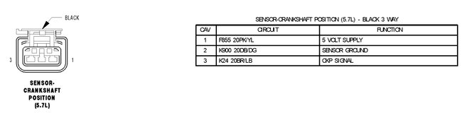

Ken, do you have instructions for testing a crankshaft sensor?
Oct 4, 2019 at 1:50 AM
  • 55,224 POSTS
Yes. here are the connector views check for 5 volts, ground and trigger will show up on a digital volt meter and bounce up to about 1.5 volts.
Check out the diagrams (below). Please run some tests and get back to us.
