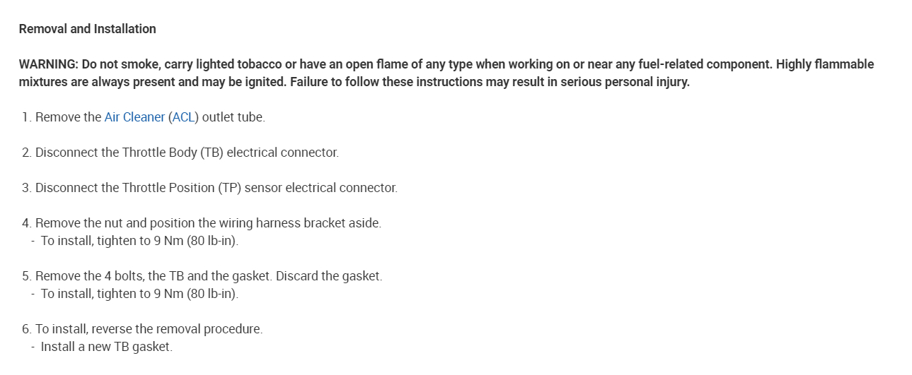

Am having this issue for while RPM fluctuating car jerking and sometimes RPM drops down till it switches off and during the fluctuating the AC is not working. i have no errors codes though.
May 16, 2023 at 2:00 PM
  • 55,224 POSTS

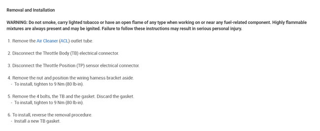

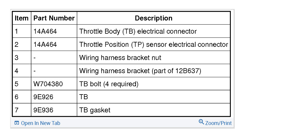

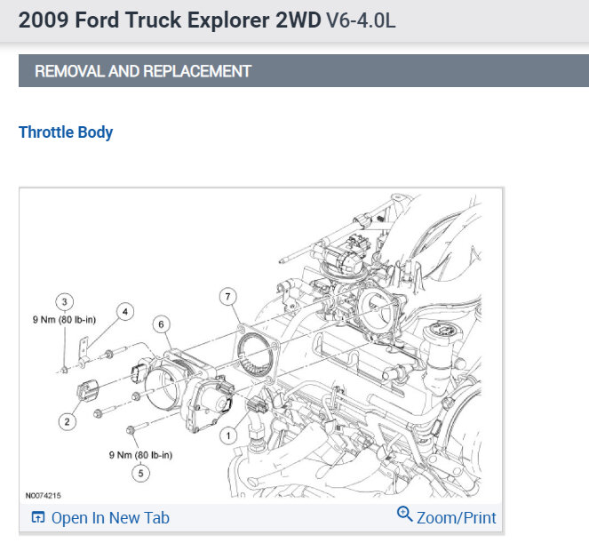

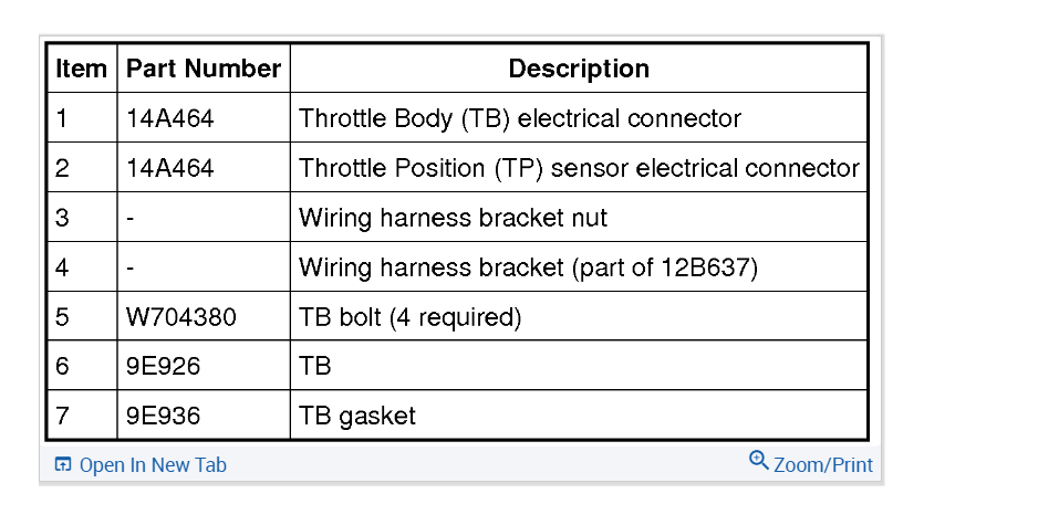

This sounds like you have a vacuum leak, or the throttle body needs to be serviced. Here are three guides to help us fix the problem with additional information below:
Use this guide when the engine is cold only:
and
