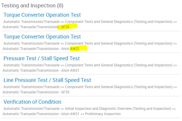

As far as the cords are concerned, I'm struggling to see how they would cause the engine to stall. The one code I had hopes with is the C1280, but that isn't showing up for this vehicle. If possible, let me know the VIN number so I can look deeper.
On the other hand, I suspect something may be related to the torque converter not functioning properly. However, there are two different transmissions listed when I go to testing. (see pic below) Do you know which one you have?
See pic below.

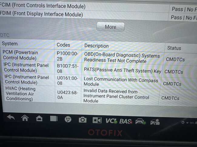

No worries, I appreciate ya'll helping me out! I drove it around a little and did the test again and these are the codes I got this time.

I think it is a 6F35 but I don’t know for sure. I’m going to spend some time trying to find out and update if I find anything out.

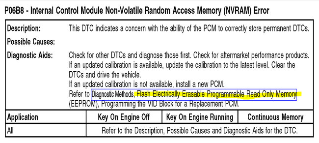

  • 110,241 POSTS

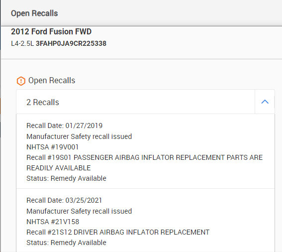

Okay, just FYI, based on your VIN, you have two open recalls needing attention. Both are related to the airbags. See pic 1 below.

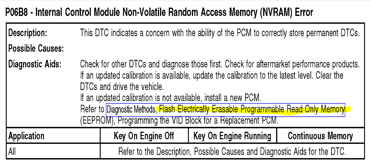

Next, the P06B8 is related to the PCM's programable read only memory. I suspect that needs to be addressed first. Take a look at pic 2 below.
Let me know your thoughts.

Thanks! I am aware of the recalls and I've tried to have ford fix them but I had a terrible experience when I talked to them about it but it might be time to try again.
That sounds good to me. I have an otofix D1 lite that I am borrowing (if that helps) but don't know how to flash the EEPROM.

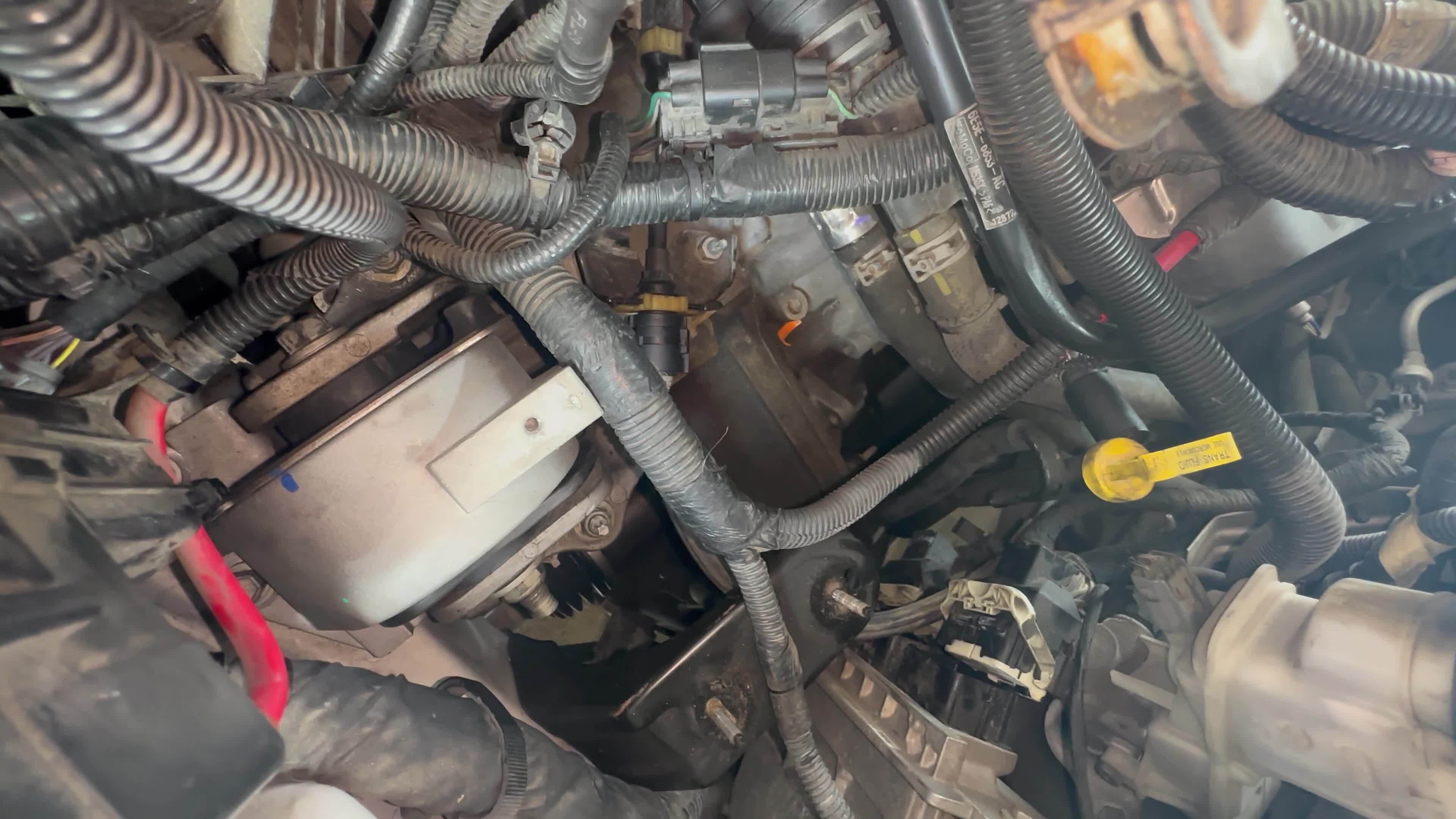

Yes, it would be a good idea to check all connections. If you do disconnect the PCM, first disconnect the battery. Don't reconnect the battery until the PCM is reconnected.

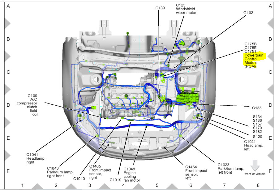

As far as the location, it is under the hood on the driver's side. It will be located very close to the firewall. I attached a picture below showing its location.
The manual I use is an online manual. You can access it, but they charge for use and it isn't too cheap. It is Alldata. Type that into a Google search and you'll find it.
On the other hand, if you let me know what is needed, I will try my best to get it for you free of charge.
See pic below.

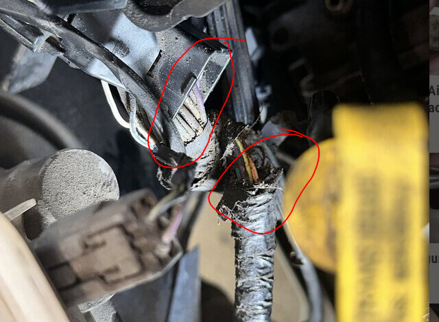

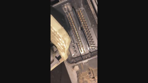

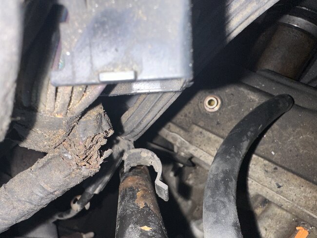

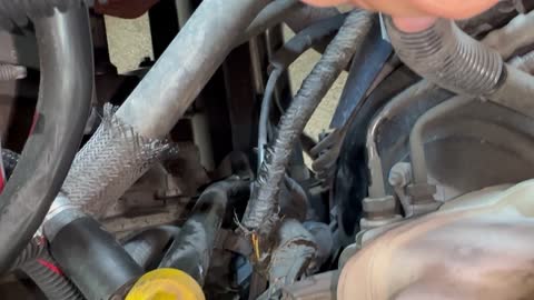

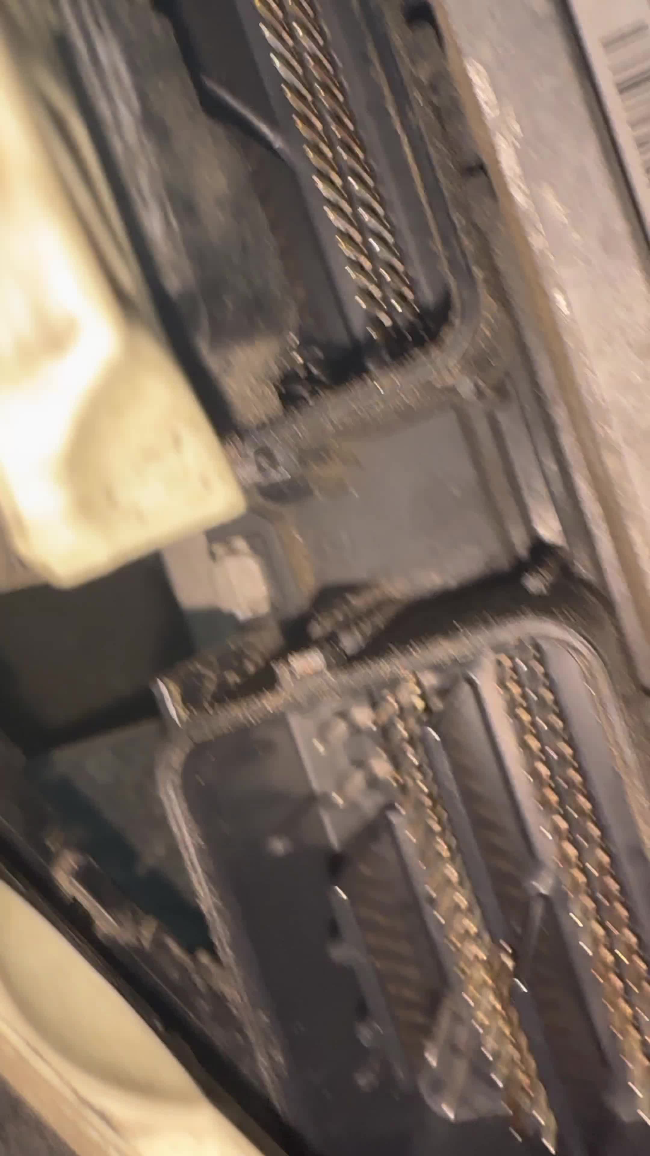

So, I disconnected the three ports (I don’t know if one of those is the PCM or if that’s exactly where it was [videos 1 and 2]) and everything seemed fine for the most part (this part didn’t seem great but looks like just the casing and I think the wires are fine and intact. [Picture 1 and 2]).

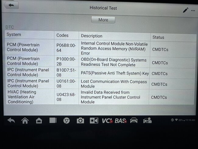

I reconnected everything and scanned again and the code went away, and these are the codes remaining (Picture 3).
Jul 19, 2024 at 6:21 AM
  • 110,241 POSTS

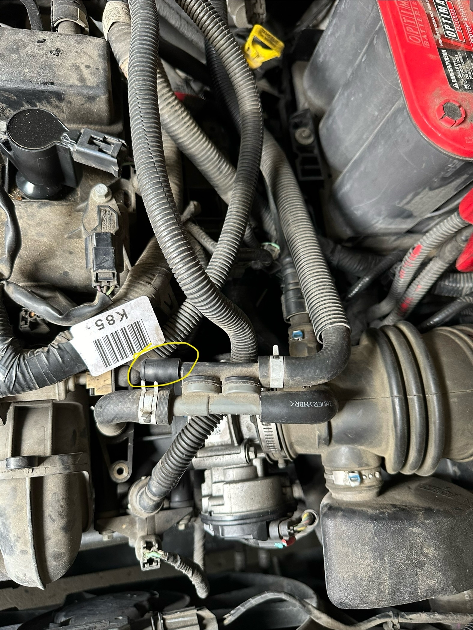

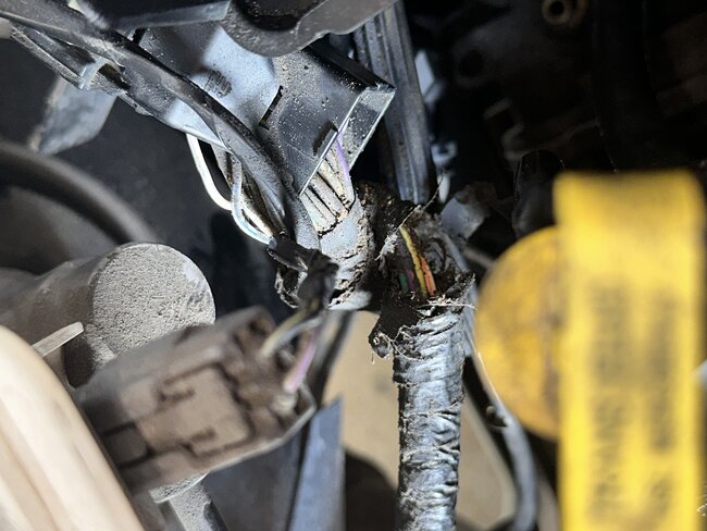

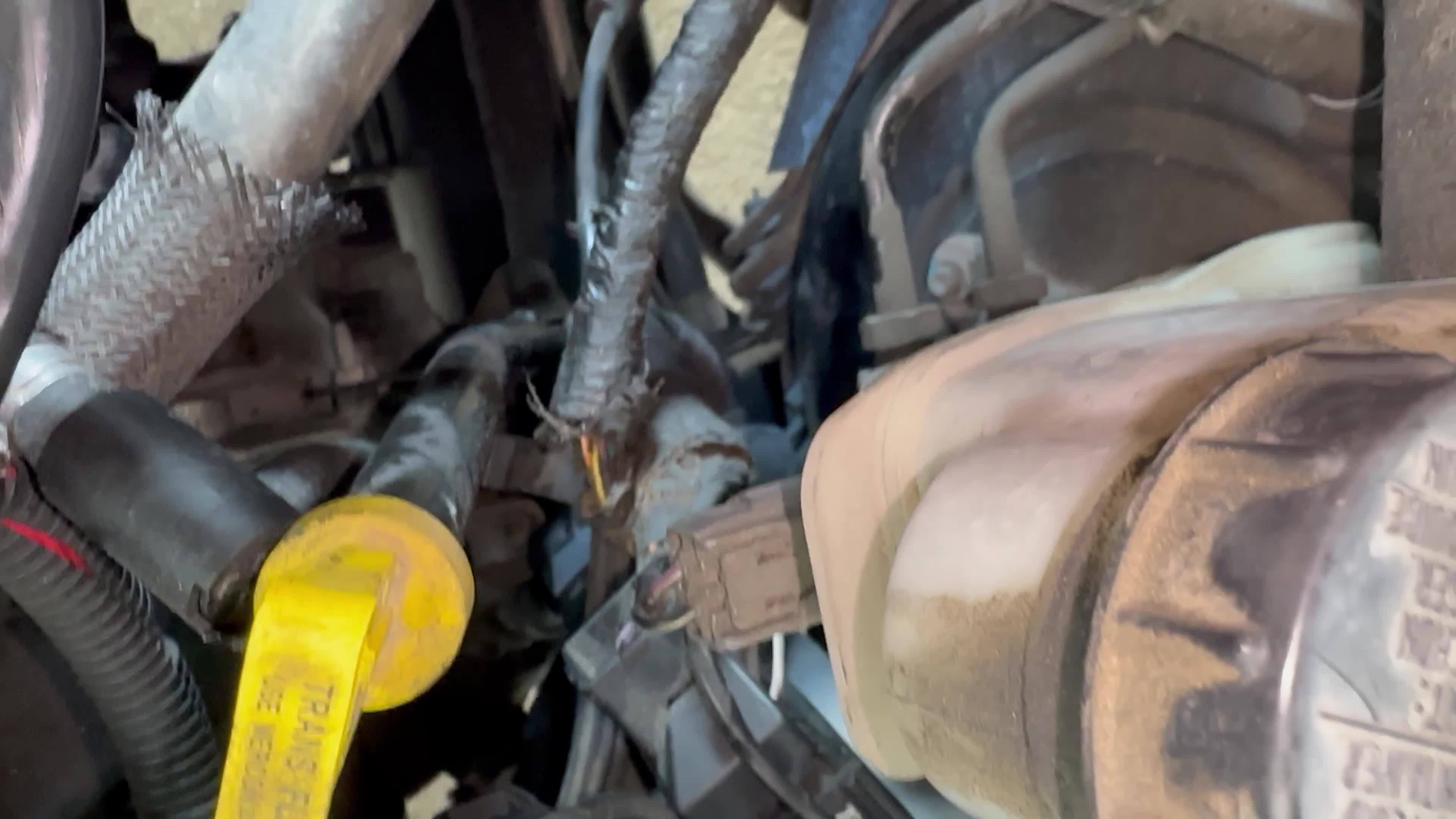

I agree, the pins in the first two videos look okay. Just make sure none of them are cracked. Pics 3 and 4 don't look so good. Where is that harness going to? I copied your pic 4 and circled a spot. That appears to be where a connector should be, but it appears that only wires are going into one side of the socket. Also, are any of the wires damaged in the bunch I have an arrow pointed?
Jul 20, 2024 at 3:29 PM
ALEX25467
  • 13 POSTS
It looks like it goes to the A/C line so I thought maybe a sensor. All the wires look fine and I was thinking of using some electrical tape to give them some protection.

  • 110,241 POSTS
I am sorry. I forgot to add the picture. I attached it below.
Jul 21, 2024 at 11:58 AM
ALEX25467
  • 13 POSTS

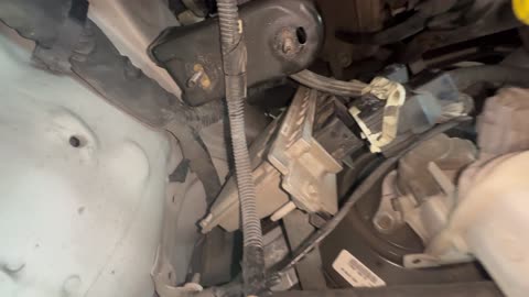

This video shows where it is going.
Jul 23, 2024 at 8:11 AM
  • 55,412 POSTS

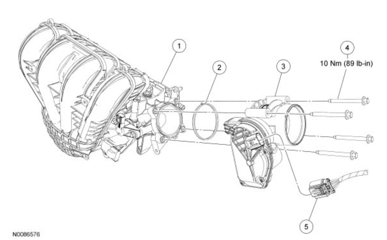

Thanks for the video. The wiring looks okay to me, I would service the throttle body to help fix the problem. Here is a guide to help us with instructions below for your car:
Jul 25, 2024 at 2:55 AM
ALEX25467
  • 13 POSTS
Throttle body serviced. It wasn't extremely dirty but it is clean now. It seems to not have changed the RPMs at idle.
