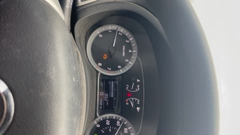

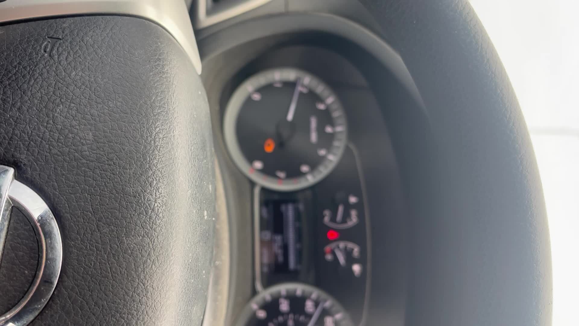

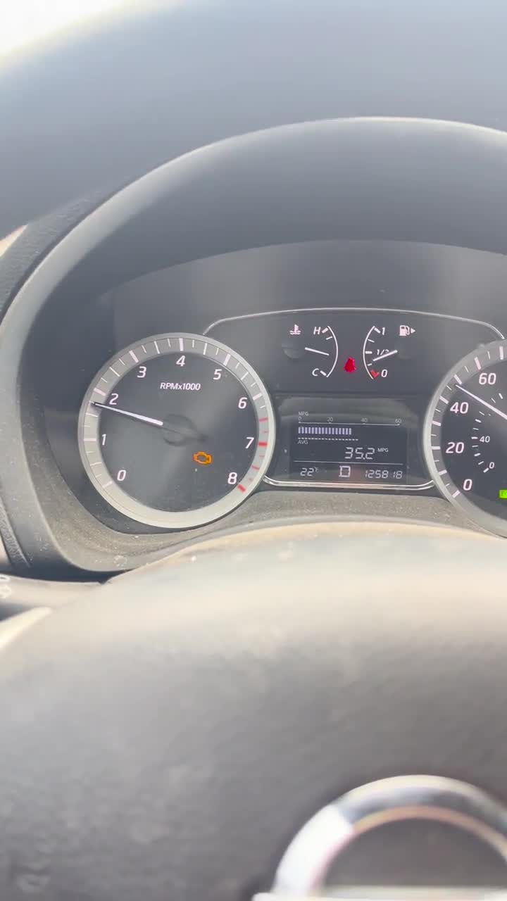

Here recently (after an oil change but I don’t think it had anything to do with it), my car started acting weird and stuttering some. So, i picked up on when it does it. My car will get up to around 1750-2000 rpm’s and drop to 1500 or somewhere in there. drops repeatedly if i stay light or medium on gas. If i accelerate a lot more, it will be able to go over that 2,000-2,500 RPMs mark but runs a little loud. I don’t have any abnormal codes for it or misfires, just a p0420 code but that’s been there for a while. I also get this whooshing like sound when I accelerate up to that 2,000 RPMs speed. Car surges when it drops RPMs. Video shows it and sound (very quiet) shows whooshing sound. think it’s air leak but not sure?

I don’t see video in my question, so here is the video:
Jan 21, 2025 at 4:26 AM

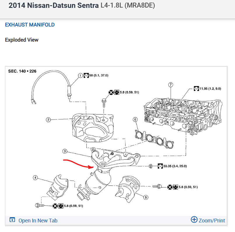

Thanks for the video, it helps. so, the p0420 code is the clue.
The P0420 code for a 2014 Nissan Sentra indicates a problem with the catalyst system efficiency for Bank 1.
What happens is the catalytic converter breaks apart and clogged the exhaust system outlets. Which sounds like what happened to you. The cat is a part of the exhaust manifold so the unit will need to be replaced if confirmed bad. This guide can help, and I have included images in the diagrams below for your car.
and
I would take a rubber mallet and tap the exhaust system to see if you can hear something loose which is a sign the cat is the problem, check out the images (below). Let us know how it goes.

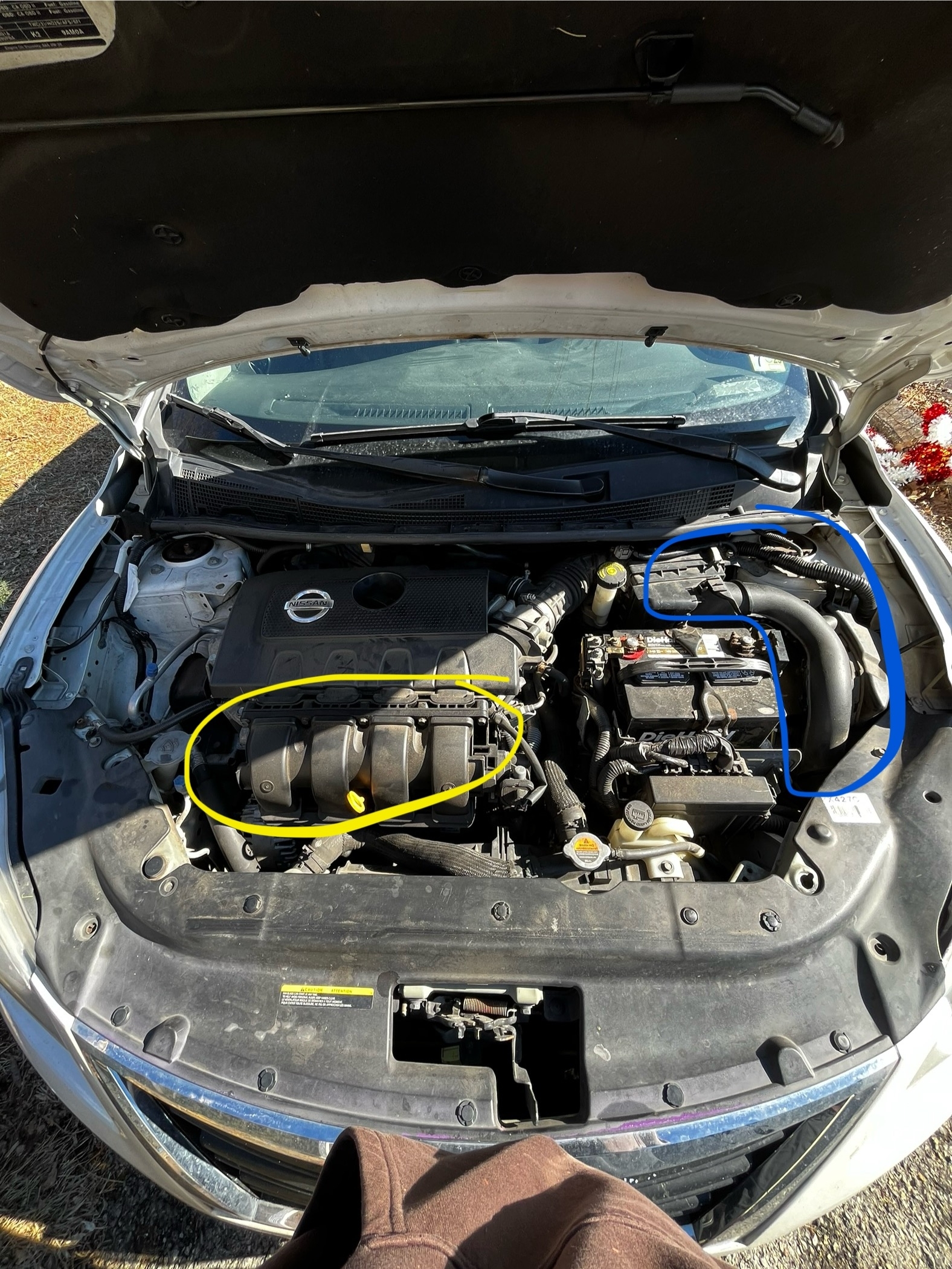

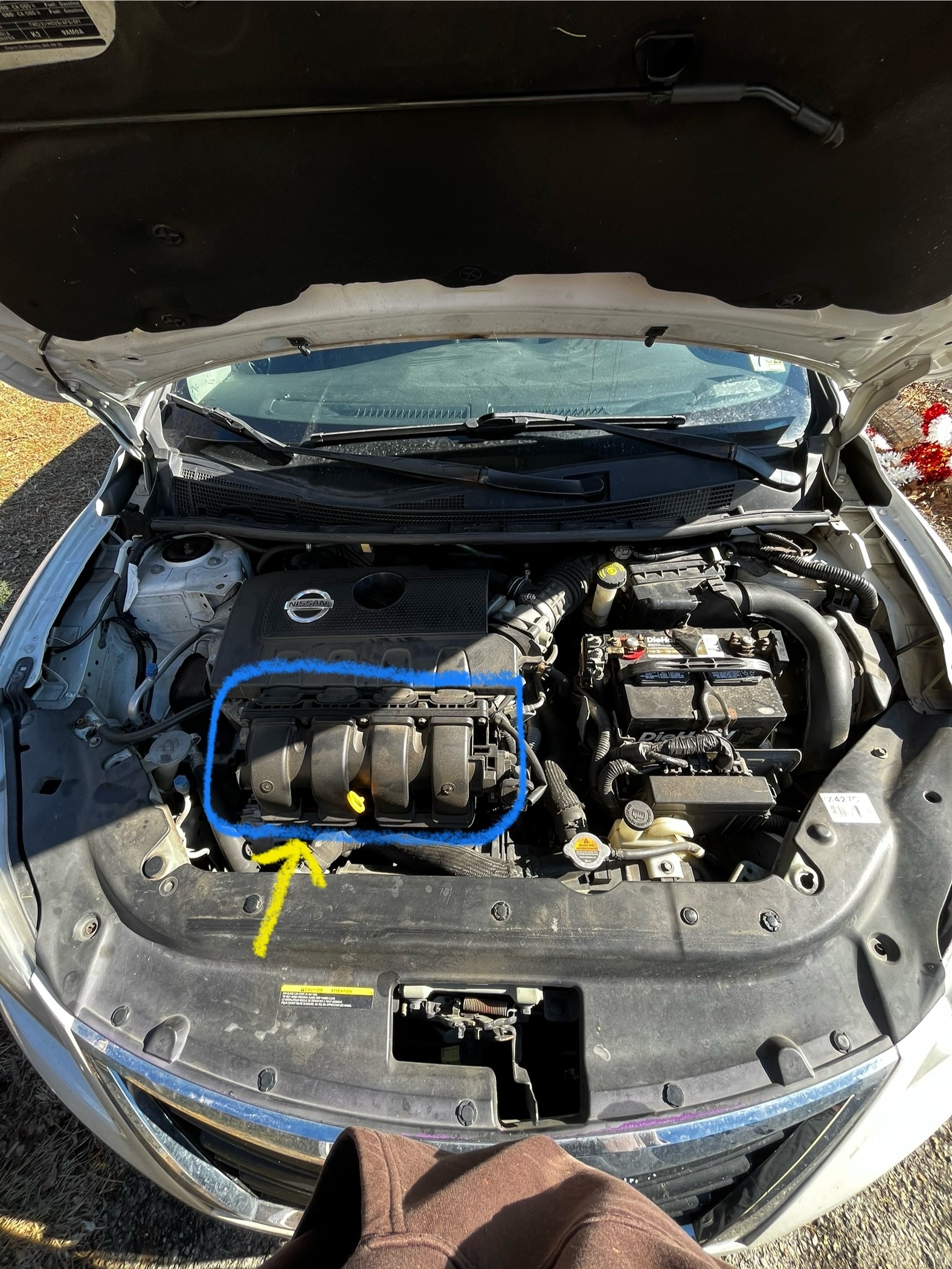

Thank you for your reply, I don’t have a rubber mallet but I'm not sure what part you are talking about. I took a picture under my hood, I knocked on the yellow circled part (no noises or rattles) but let me know if this is the wrong area, please. I will say I noticed that the tube going into my air filter (circled in blue) is really loose as it goes down into my driver's side fender well (i can pull the tubes out from each other easily), the plastic itself is also incredibly loose and can be moved with my hand. not my air filter as its new and clean. Thank you!

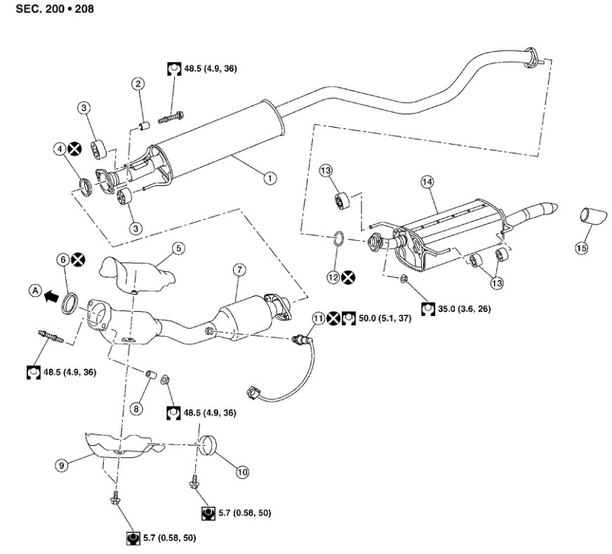

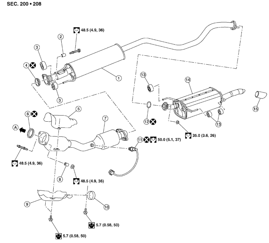

I am sorry I meant the exhaust system under the car. Here is what it looks like. Check out the images (below). Please let us know what happens.

Hey! So I did some tapping. (Sorry for the late response, work and school is ramping up) No rattling or anything along those lines. I had the emissions tested and that’s fine too, my car runs naturally like this with the light on I assume. On the hand, I’ve had some mechanic buddies of mine look at! Here’s what we found: I’m missing a bolt right near my air intake manifold system, and with that, it’s incredibly loose. Also, if you place your hand under the 2nd to the left part, cold air is flowing in or coming out (yellow arrow, underside not top view). I’ve also noticed that the problem is way worse in cold weather and warm weather it does just fine.

  • 55,224 POSTS
No worries, can you hear a whistle noise, a vacuum leak? I have seen the intake manifolds crack and cause an engine vacuum leak. This guide may be able to help you confirm the issue:

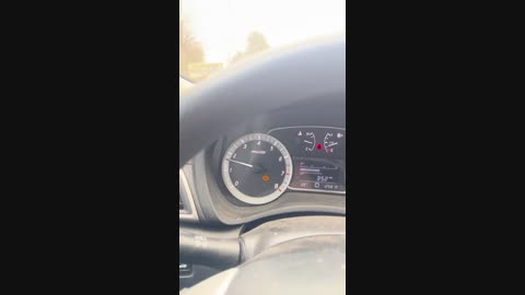

Essentially, I just had my CVT trans replaced literally this week from a Nissan dealer. Got it back on Monday and it is currently the same week on Saturday. 400 miles within that one week. Now, my car is starting to exhibit the same problem before the cvt failed… I accelerate, get the car to 2,000 rpms, and it doesn’t want to go higher than that. I get a squeally spinning noise and it flutters in between 2000-1500 until i either let it off the gas (which stops the noise) or press harder on the gas, also stopping the noise. Like I said, only 400 miles and just replaced. At this point Im at a loss, im attaching the video in the reply of what its doing.

NICOLE LYNCH
  • 17 POSTS
Here’s the video! Only note is that this video was from before I got the new transmission put in. But, it’s the same symptom. Only difference is that the wooshing/spinning noise in the video (very quiet) is lasting the entire duration of rpm’s fluttering and not just the one time.

  • 55,224 POSTS
Thanks for the video, yep that is not normal and the slight noise it is making is not good either, also I noticed the check engine light on so we should run the codes to see if any are for the transmission which can further the diagnosis. Here is what I would do first:
They will read the codes for you at AutoZone, then get back to me so we can figure out what to do. To me it sounds like the transmission is defective but let's get the codes first.
