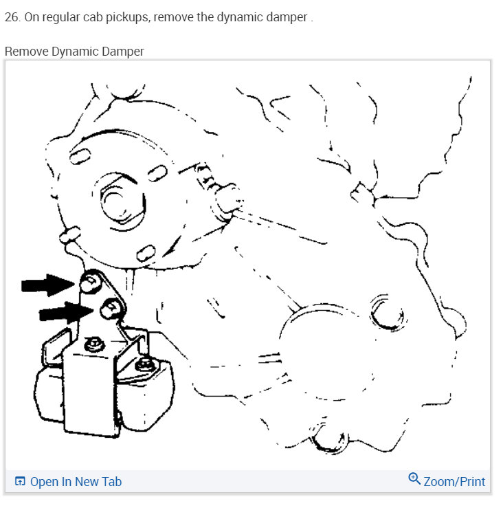

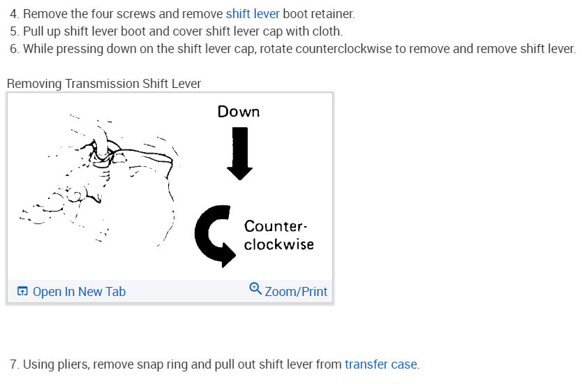

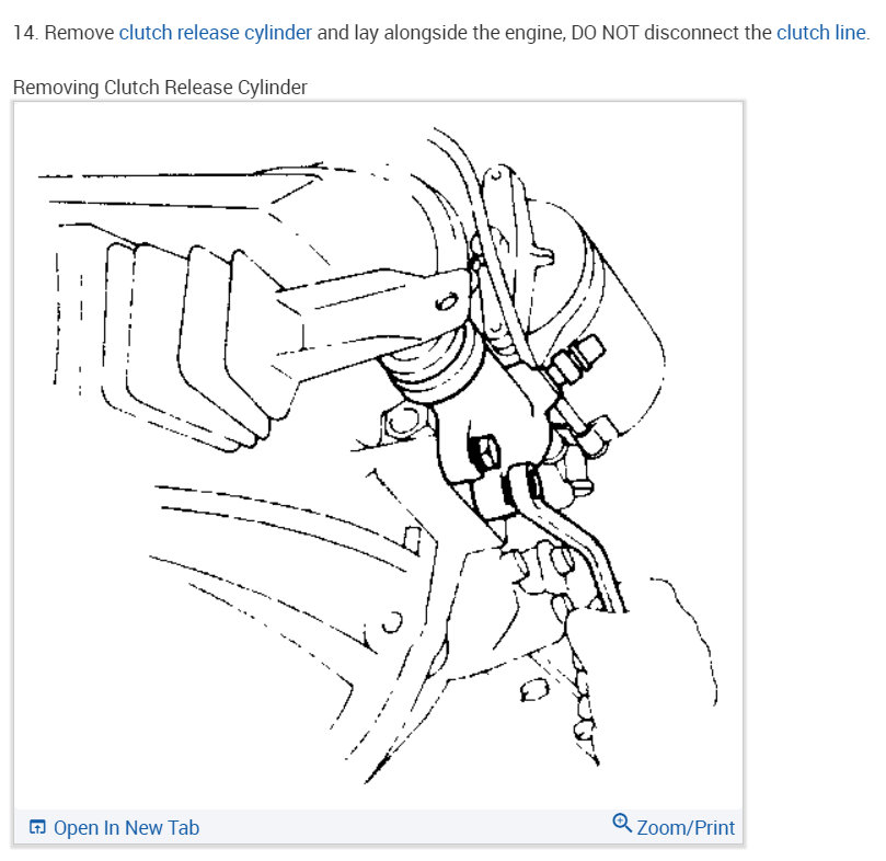

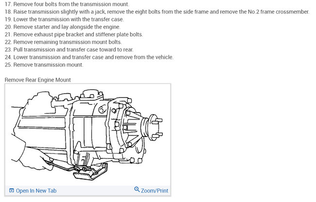

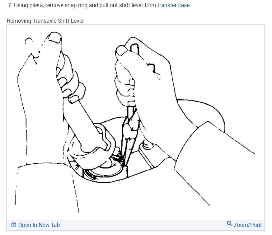

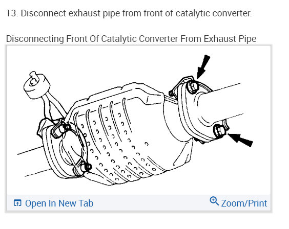

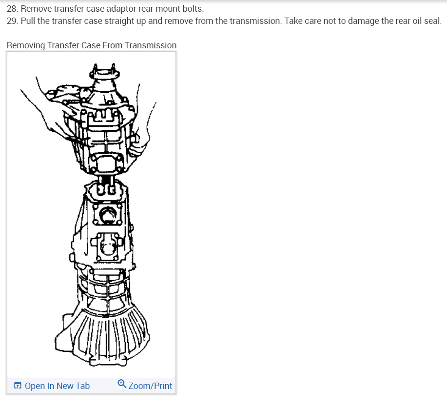

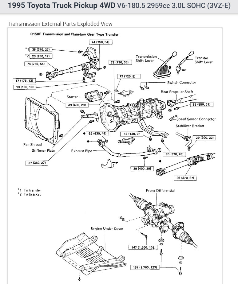

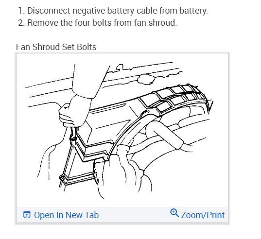

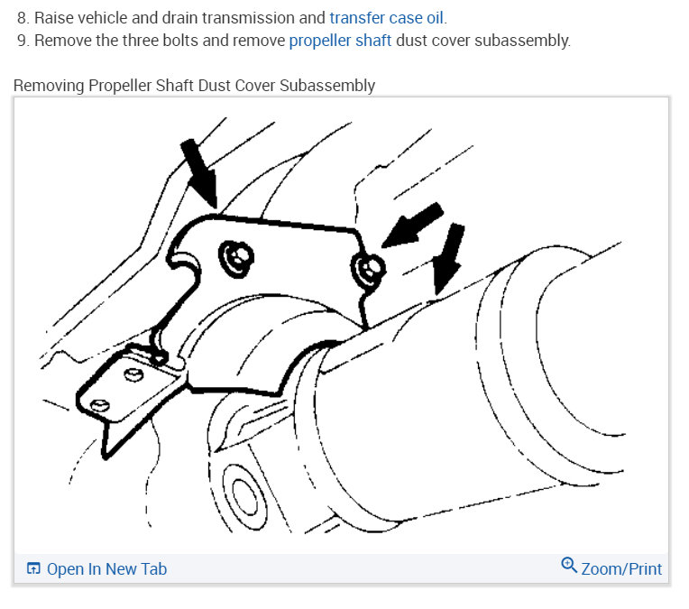

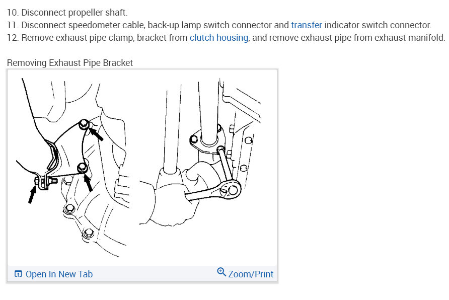

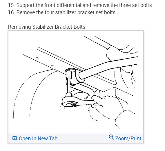

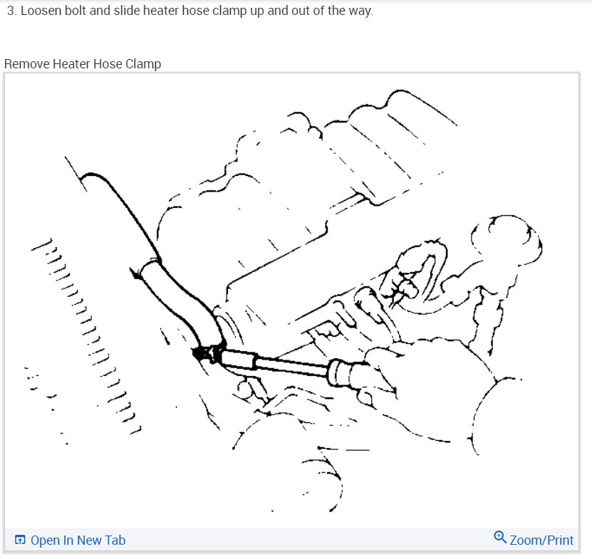

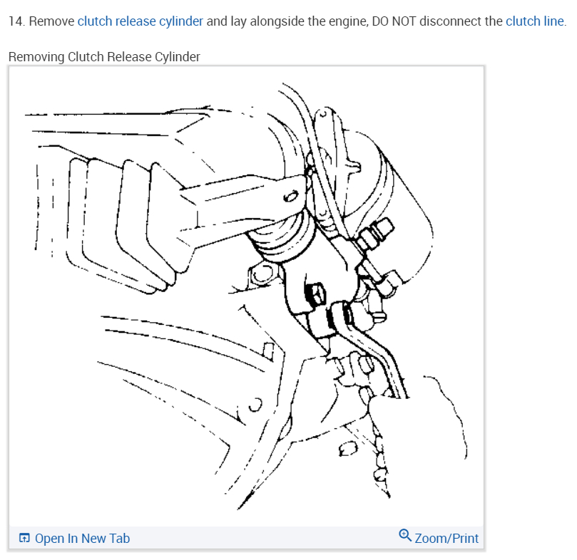

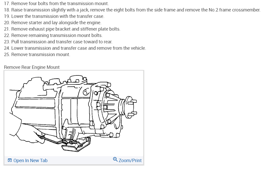

It looks like the clutch is slipping and need to be replaced. Here is a video that shows the steps. It is a different car but the process is the same. Here are diagrams to help you get the job done on your truck below.
https://youtu.be/JpzefqEeVGE
