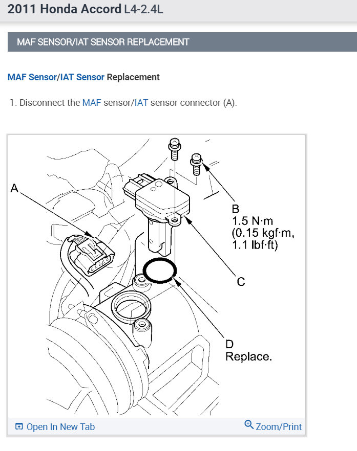

When I get up to 3,000 it starts sputtering. I change spark plugs,coil pack, fuel injector.

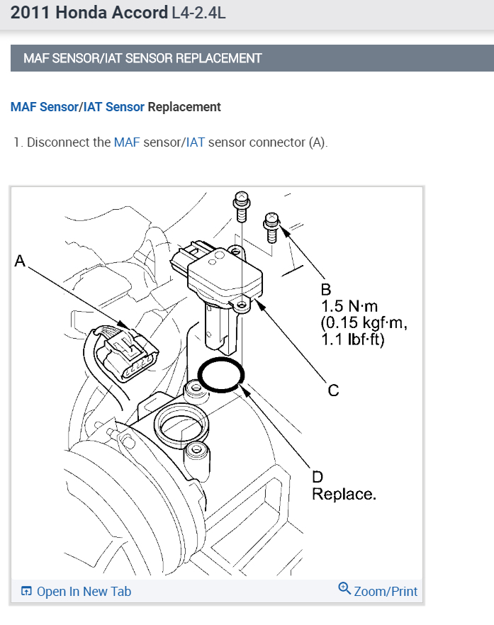

Do you have a check engine light on? If so lets run the codes to see what comes up, it sounds like you have a MAF sensor that is off slightly you can try cleaning it but I recommend replacement. Here is a guide to help walk you through the steps with diagrams below to show you how on your car:
and
https://www.2carpros.com/articles/how-to-replace-a-mass-air-flow-sensor-maf
If the sensor is off it will not trigger a code, Check out the diagrams (below). Please let us know what happens.
