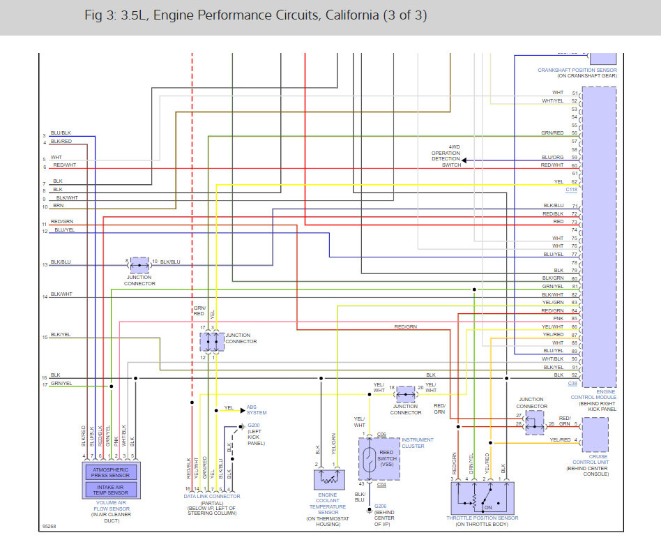

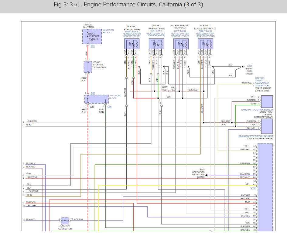

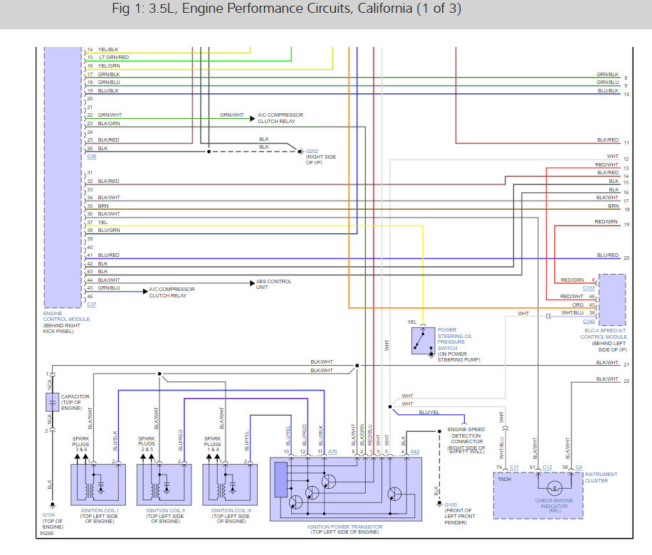

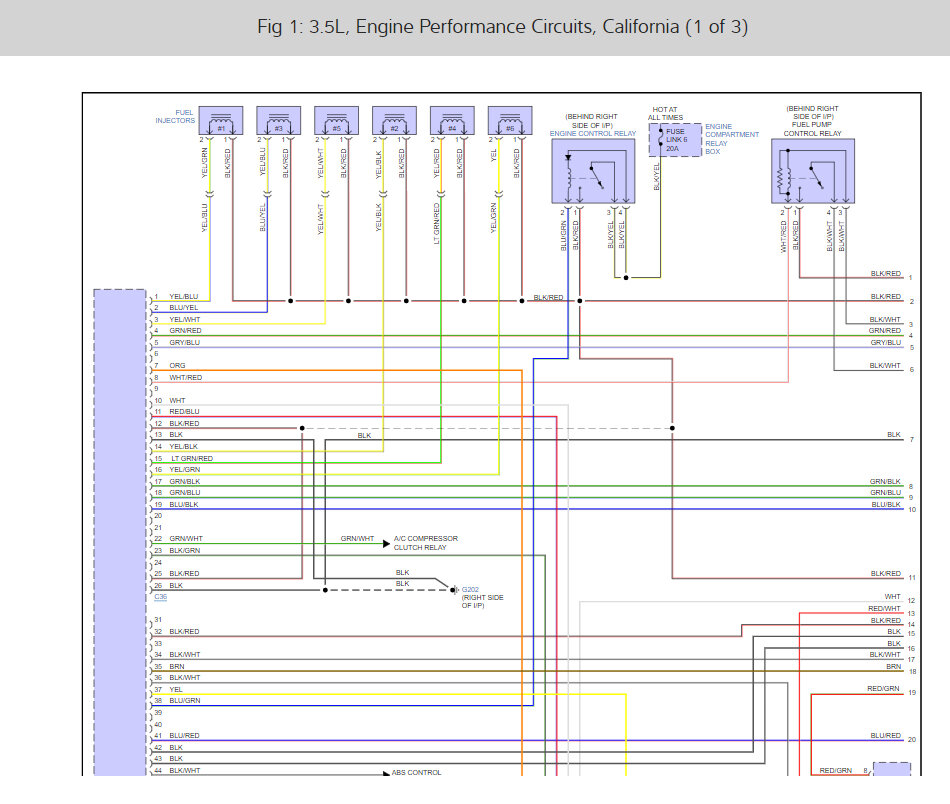

I own the vehicle listed above DGI with 6G74 motor. The wiring (connections) for the injectors and coil have been tampered with and therefore i cannot figure out which one goes where. Can you please assist?
Feb 2, 2023 at 10:51 PM
  • 54,836 POSTS
Sure, here are the engine wiring diagrams so you can see where the wires go and how the system works, I have also included a guide on how to check the wiring.
Check out the images (below). Please let us know if you need anything else to get the problem fixed.
