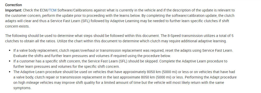

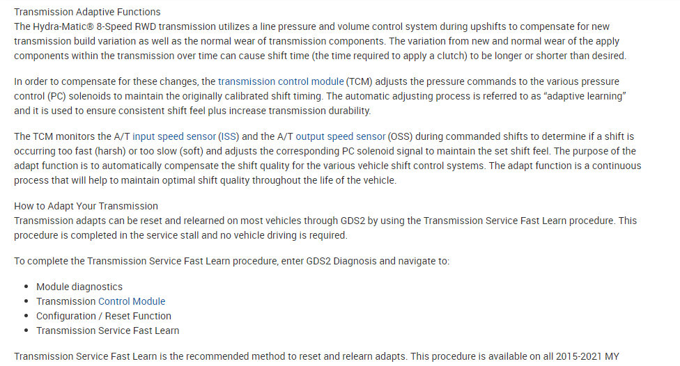

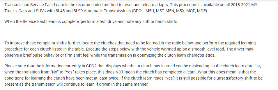

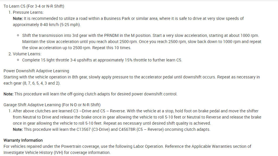

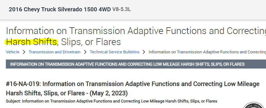

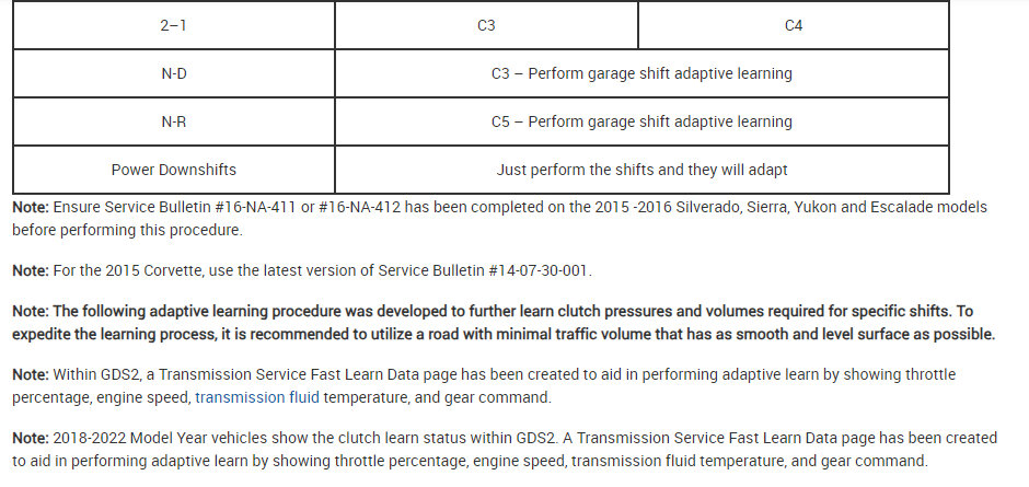

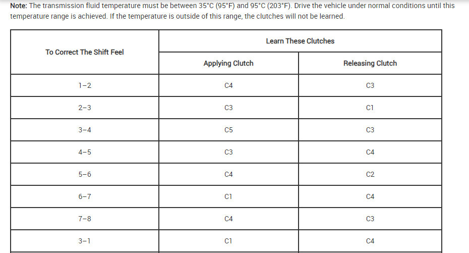

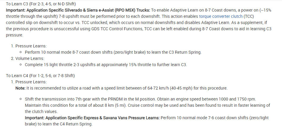

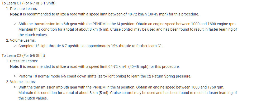

I did a little research for you and found there are several other GM vehicles affected. According to a technical service bulletin, it could require a valve body replacement. However, the TSB indicates the need to follow a relearn procedure for both up and down-shifts.
I attached the TSB below. It will require an upper-level scan tool that can communicate with the different modules.
Take a look and let me know if that has already been done by the dealer.

Thanks for the reply. Here is what they said they did: checked ECM and TCM for updates, found updates. Programed ECM/TCM, performed fast learn adapt, test drove vehicle operating to GM specs. Refer to16-na-412.

It sounds like they did the updates on the modules. If it is still happening, it may be related to the valve body.
Here is what I recommend. In the rear of your owner's manual, there should be a listing for Zone Reps from GM you can contact. Or I attached the phone number below for customer service. Contact them and tell them the dealer is unable to resolve the issue and ask what can be done.
Try this and let me know what they tell you.
