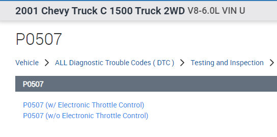

I looked up the code for diagnostic information and ran into a wall right away. See pic 1 below. I need to know if it has electronic throttle control or not.
Also, let me know if you have checked the idle air control valve (IAC).

I didn't think that I had an electronic throttle control but, in the photo attached it seems that I do. Do you think either cleaning or replacing the IAC valve would solve the problem.

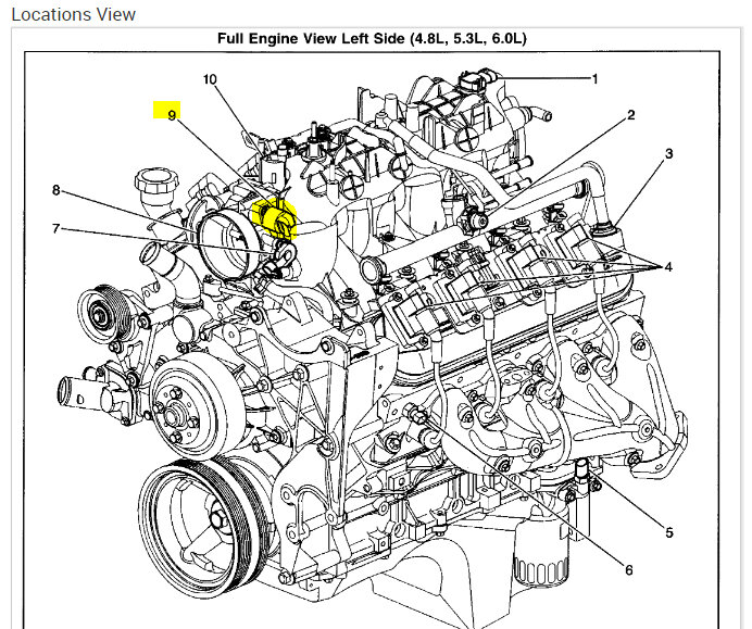

The idle air control valve is the most common cause of this code and conditions. I would remove it to check if it is corroded.
I attached a pic below showing which of the two is the IAC. The other sensor in the pic is the throttle position sensor (TPS).
Let me know what you find with it.
See pic below.

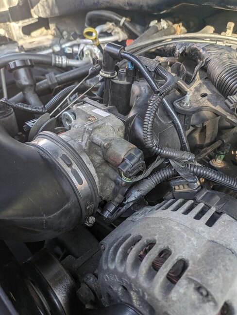

I spoke to soon. It took more than a week driving my truck to get a check engine light. Now I am getting P0101, P0171, P0174, P0507. I replaced my MAF sensor and the PCV valve. I have a smoke machine and hooking it up, I didn't have any air leaks. I replaced a knock sensor and discovered that one of the sensor lines was beneath the intake manifold after I Torqued it down. Yesterday I took a look at the wires, and I don't see any breaks. What do you think is going on?

Check the wires that were pinched by the manifold for continuity. Wiggle them around when checking. There could be damage to them under the insulation you don't see.

What is #7 in the engine diagram in this email chain?
Ron
Feb 13, 2024 at 10:59 AM
  • 110,248 POSTS
I believe you are referring to the throttle position sensor.
