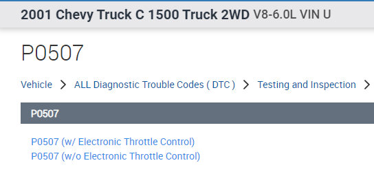

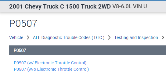

I looked up the code for diagnostic information and ran into a wall right away. See pic 1 below. I need to know if it has electronic throttle control or not.
Also, let me know if you have checked the idle air control valve (IAC).

I didn't think that I had an electronic throttle control but, in the photo attached it seems that I do. Do you think either cleaning or replacing the IAC valve would solve the problem.

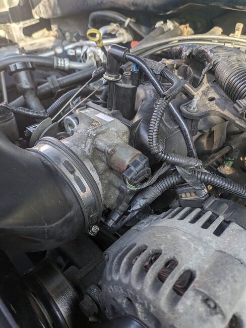

The idle air control valve is the most common cause of this code and conditions. I would remove it to check if it is corroded.
I attached a pic below showing which of the two is the IAC. The other sensor in the pic is the throttle position sensor (TPS).
Let me know what you find with it.
See pic below.

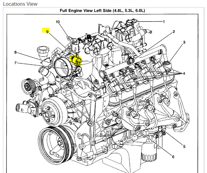

Joe,
What is #7 in the engine diagram in this email chain?
Ron
Feb 13, 2024 at 6:59 PM
  • 110,194 POSTS
I believe you are referring to the throttle position sensor.
