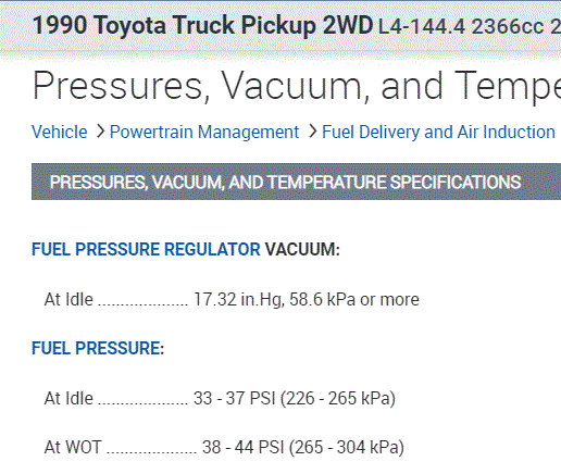

Let me know. Also, let me know if this has the 22R or 22RE engine. I'm assuming it's the 22RE. Additionally, let me know if you smell fuel, see smoke from the exhaust, or anything you feel may help me. If you could record it running and upload it for me to hear, it may be helpful.
I attached the fuel pressure specifications below for the 22RE engine. If you have the 22R, it will have a mechanical fuel pump and the pressure is much lower, so let me know.
See pic below.
Apr 17, 2022 at 1:02 PM

My engine is the 22RE. I rented a fuel pressure gage, and it measured 40psi. It held steady at idle and also when I revved it up a bit. The pressure remained constant after I turned off the motor. This tells me the fuel pump is operating properly, and there are no leaky fuel injectors. But maybe one of the fuel injectors is clogged or stopped working; not sure if I'm on the right track.
