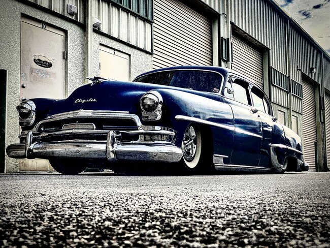

I recently picked up a 1954 Chrysler Windsor with a LM7 5.3 Gen 3 swap out of a 2001 Silverado, I believe. It idles fine but runs bad on acceleration. Purge valve is abandoned. No wires or vacuum lines. No charcoal canister. No vac line to fuel pressure regulator either. I installed a vacuum line to FPR from intake manifold. No change. I'm going to try the carburetor cleaner trick for vacuum leaks tomorrow. Anything else I should look at? Thanks

Way cool! sweet car can you upload some picks? Also, I would install a new set of spark plugs and coils they go out often on these engines.

wow, super cool ride. Thanks for the image. I think the plugs and coil will fix it, also don't forget to install new plug wires as well.
