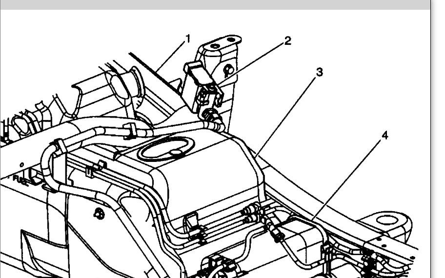

Rough idling strong exhaust smell check engine light pulled codes and got the following: P0455, P0171, P0300, P0131 and P0102. Exhaust smells like rotten eggs. Unplugged MAF sensor while truck running and nothing happens is this normal? Please help.

The 455 is an EVAP code. attached is the location of the vent valve.
