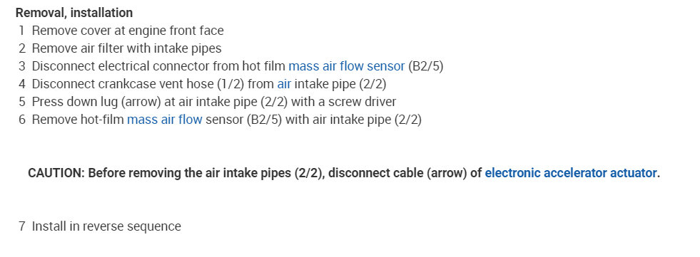

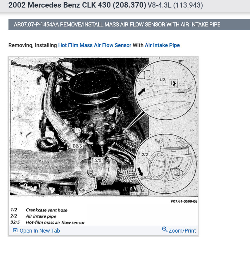

  • 55,732 POSTS
Checking the coil pack is not too bad this guide will help you:
As far as the MAF sensor that is more difficult to test because you would need a new sensor to check the difference in values. The MAF is a normal wear item and should be replaced after 100,k here is a video that shows the job being done on a similar car with diagrams below to show you on your car.
