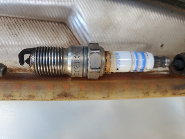

spark plug 1.

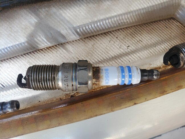

spark plug

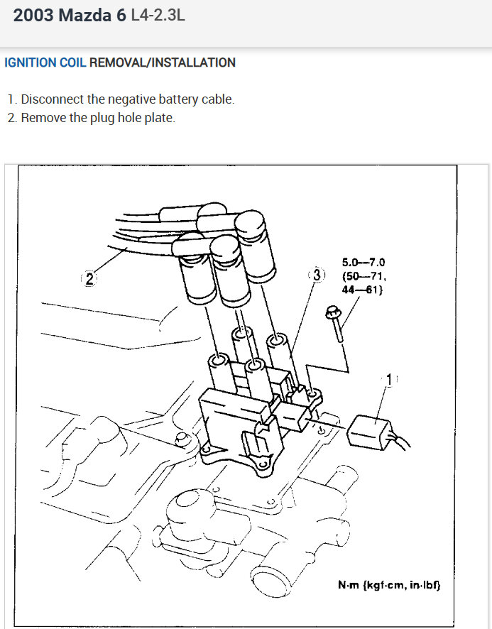

Yes, that does idle well. thanks for the video. I have seen a cracked spark plug or a bad ignition coil cause this, I would remove the spark plugs to check for cracks and replace the ignition coils. I would replace the spark plug wires as well. Check out the images (below). Please let us know what happens.

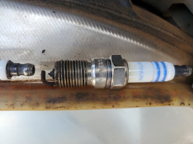

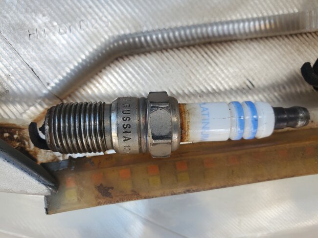

Are there any trouble codes? Also, those spark plugs like the engine is running rich like it has a clogged catalytic converter. If you use a rubber mallet on the exhaust, can you hear something rattling inside?
