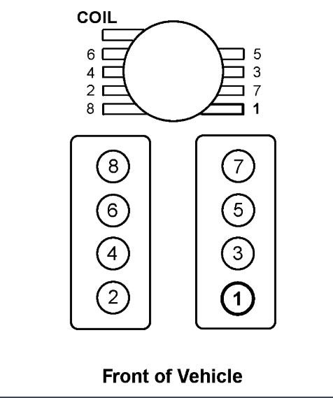

I have rough idling and i have one of my exhaust H pipe missing. i saw flames coming out of the catalytic converter with the missing pipe.

Good afternoon,
If you have flames in the exhaust, it sounds like a timing issue.
Did you check the firing order of the wires from the cap to the plugs?
I would also check the compression in the motor as well.

No, I haven't but know I will.

Well, I changed the spark plugs and 2,4,6,and 8 plugs were coated black 1,3,5,and 7 were not haven't checked the timing yet will do as soon as I get the spark plug wires.
